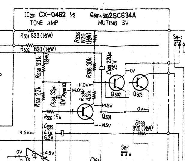

Something I noticed quite a bit earlier in this thread was that both R501 and R502 (1/2W 820 ohm) resistors had cracked exteriors. I got some replacments but did nothing with them until today. While I was replacing R501/502 I saw that R533 and R536 also had cracked exteriors. These too are 1/2W 820 ohm resistors. When I removed them for replacement, I saw that the PC board underneath was discoloured, obviously subjected to excess heat from those resistors.
Testing the cracked resistors after removal showed that they were still within specc.
I replaced all four of those resistors but was wondering what conditions could have made them get hot in the first place? I suspect it is "old damage" and not something that happened since I've owned this amplifier.

The resistors are used to drop the main supply voltage to lower values for the preamp stages. The circuit shows 35 volt as the main supply and the voltage on the other side of the resistor as 17v. So we have 18 volts across the resistor... if the mains voltage is a bit higher than the voltage may be a bit more.
Dissipation in the resistor is (18*18)/820 which is 0.4 watt. So they are run close to their limit, they will run hot and in a case.... its a normal thing to see. So no real issue. I would probably replace with 1 watt types.

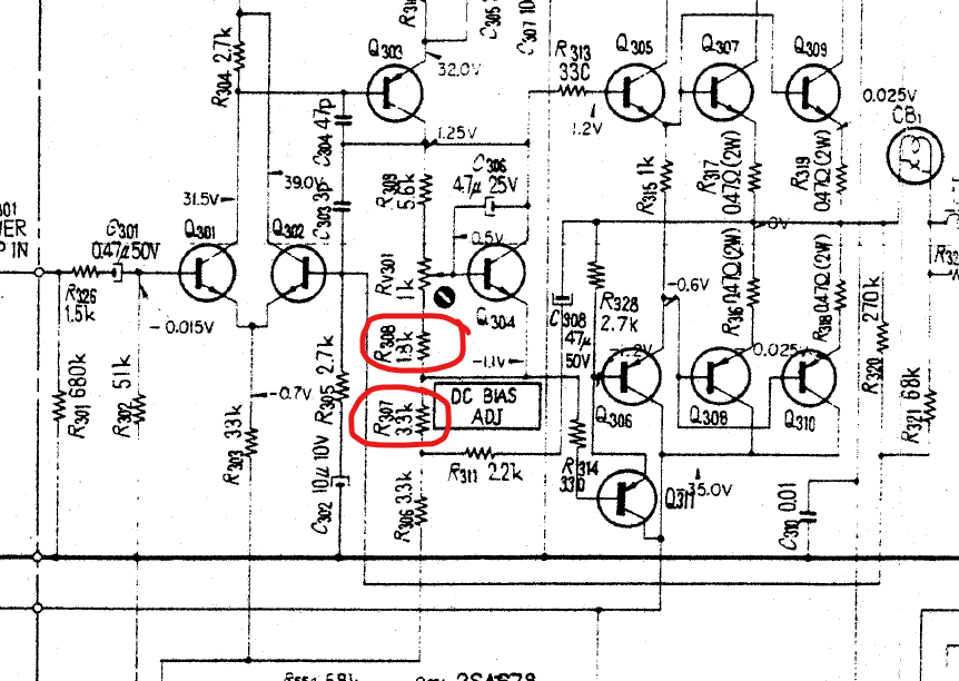

So are we saying both channels seem basically OK at this point? If the bias adjusts and offset is low it would seem so.

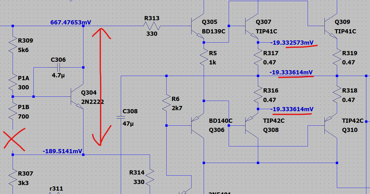

To get bias lower we need to alter either of these two resistors and make one a bit higher in value. I would try making the 1.8k into a 2.2k or increase the 3.3k to a 3.9k or a 4.7k. There is no way to calculate these, it is trial and error as it depends on the forward B/E volt drop of the driver and output transistors used.
If you make them to high the bias will fall to zero (which is safe), just do not make them lower than they are. Make sure the original values fitted match those on the circuit as these type of parts might be subject to change in production. Always go higher than the value you remove. Also keep using the DBT at this point.

Regarding the diagram, I will have a look to see what resistors are at hand and try your suggestion.
Assessing what resistors I have would determine which of those two circled resistors I will change.
I will decode the colour bands of R308 and R307 to see what their values actually are.
The service manual cites 25mV as the target bias current for transistors from 1973/74. Considering that the replacement transitors are modern, is 25mV still the number to shoot for?
I am assuming that the objective for upping resistance of R308 or R307 is to achieve near 0.0mV with bias pot at minimum?

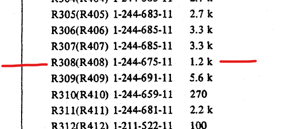

From the list of substitute resistors you provided, the only one I have on hand is 2.2K. So I was about to remove R308 and put a 2.2K resistor there instead. However, R308 is actually a 1.2K not a 1.8K.
The last digit on the schematic is either a misprint or a print distortion.
1.2K is the value of R308 in the parts list and is also what is printed on the component location diagram.
That being the case, what value of resistor I should look for as a substitute for the 1.2K ohm resistor at R308?
It looks like a misprint on the circuit. Parts list actually states 1.2k

I've made an error in circling R307 in the diagram earlier. R307 must be left at 3.3k and we can only alter the 1.2k which need to be raised in value. Try your 2k2. If it is to high you would not be able to reach the 25mv bias setting but it would be 'safe'.

I did not install a 2.2K resistor because earlier today I discovered something about R308 & R408. The resistors at those positions are not 1.2K resistors, they already are 2.2K resistors. The color bands made me take a closer look. Brn/red/red/ vs red/red/red.
Chosing to stay on the right channel, I removed R408 and it looked like red/red/red to me so I tested it and sure enough it was 2200 ohms.
To see what bias would be, with a 1.2K resistor there, I installed one at R408 and measured bias. The amp had been on for while and my meter displayed 37,3mV with bias pot at minimum. It would adjust higher but not less that 37.3mV.
Minimum left channel bias, with a 2.2K ohm resistor at R308 is 33.3mV.
Does this mean I should be experimenting with resistors of considerably higher values than 2.2K ohms?

Yes, R308 needs to go higher. Use what you have that is higher or make a value up of two series resistor. Its not very critical because the preset allows a wide range of adjustment, you just need it a bit higher than it is now.
It means replacing R308 temporarily with a preset (like the bias setting one) but of higher value than R308, say a 4.7k or 5k preset. You use only the wiper pin and one end pin and make sure the preset is turned so it appears as its full value in circuit.
You then set the normal bias preset to the midpoint and this time set the bias with the new preset. Switch off, remove and measure the new preset value and fit the nearest fixed resistor to that value. Now set the main bias preset to minimum and adjust the bias as per the manual and the bias preset should end up around the midpoint.

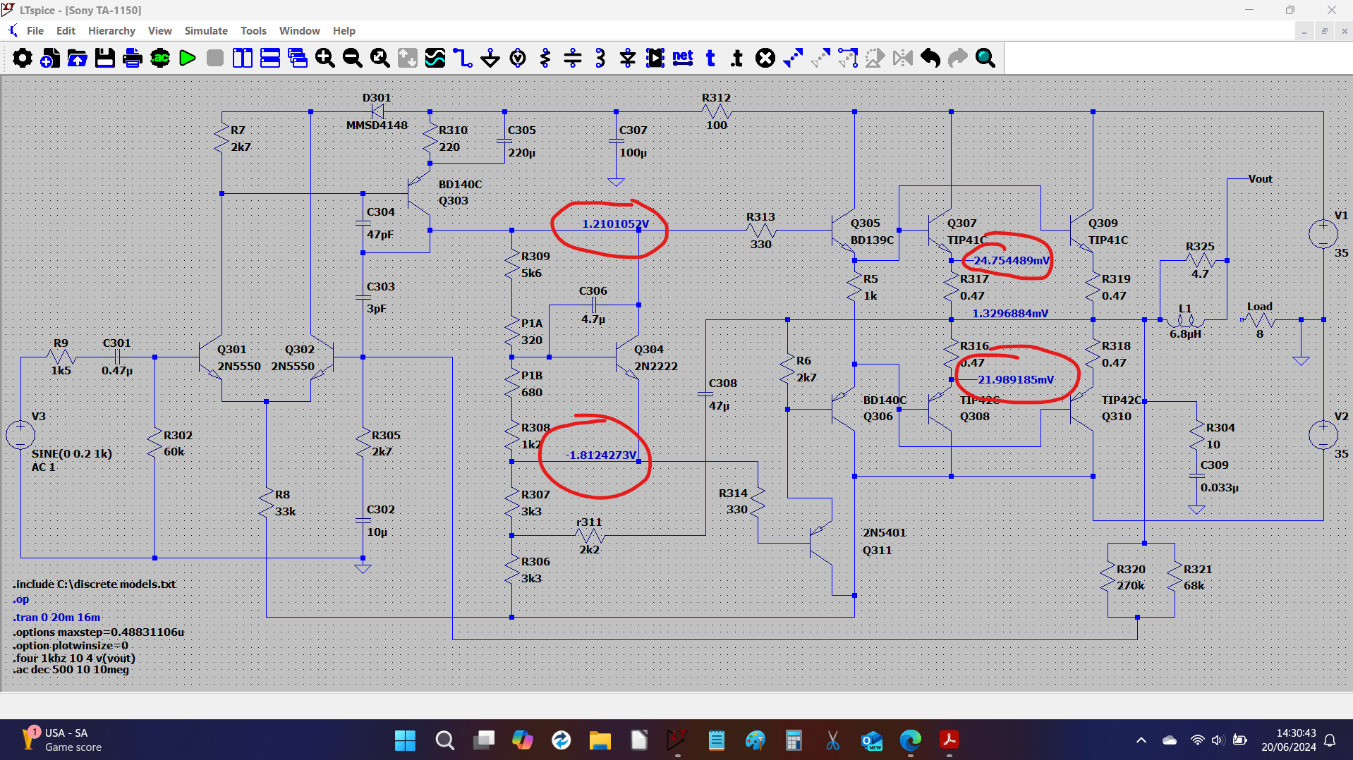

I wonder if this is a sign of very high frequency instability (oscillation) caused by modern parts being so much faster than the old originals. It is something that happens.The 330 ohm resistors I located are R413 and R414. With DBT still in place the voltage I measured between them is 0.76V.
I'll have to think what to try next but my first thought would be to place a very small cap (just a few pF) across the feedback resistor R320 (or R321 as they are in parallel) and see if it resolves the problem. The size of cap would be small, perhaps in the range 10pF to 47pF but no higher.

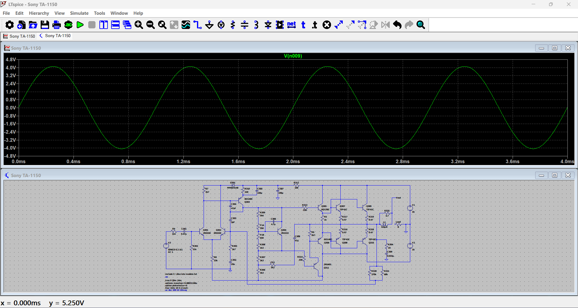

Let me think today. I might throw the design into a simulation and look at the stability margins but that would be later today/tonight.
This is where an oscilloscope comes into its own and it would show anything like this instantly

I put a 47pF capacitor in parallel with R321 as suggested and bias remains at 27mV.

As useful and educational as an oscilloscope can be, you really need someone with some audio/video or even automotive diagnostic experience to show you how to identify and get meaningful results. Otherwise, you may be just looking at squiggles on a screen, since there's no indication of what they represent.
Digital 'scopes now, are relatively cheap and easy to use but I think you're very likely to need some 1 on 1 type instruction to ensure you're on the track to meaningful results. In my experience with living in isolated communities, there has usually been someone around who was a capable tech. or at least able to say something is wrong and how and where to find out what it is, if not repair it. These useful guys may often have little spare time to show you how but you'll need their kind of help with instrument use, because internet articles often don't squarely meet your needs. In fact, most of the articles on using a 'scope that I've read on the net, seem to skim over the steps to learning and just waste space on talking up the benefits - or simply flashing product images. Many articles seem to ignore the basics of use and focus on specific applications that are probably too advanced or irrelevant anyway.

Assuming that is all OK we are back to this:
Bias cannot be adjusted but since it is is near to 25mV with that resistor removed I went ahead with the above measurment. The 330 ohm resistors I located are R413 and R414. With DBT still in place the voltage I measured between them is 0.76V.
The theory is sound here, if you have 0.76 volts between the two 330 ohm resistors then that alone is nowhere near enough to turn the driver and output stage on. We need approx 0.6 volts (the typical forward base/emitter volt drop) per transistor so the two drivers plus Q311 and the output pair (the parallel outputs make no difference) mean we need about 0.6 times 5 or 3 volts. So 0.76 is way below that and there should be zero bias current flowing.
So as a simulation we can see it agrees with the theory. The offset of this simulated amp is virtually zero (I trimmed the 51k at the input to achieve that) and the DC voltage on 330 ohm resistors is +1.2 and -1.8 volt giving us that 3 volt figure between the resistors. The bias is set to approx the recommended value.
(For your amp, measuring between the resistors means any DC offset in your amp is accounted for as both values would shift up or down accordingly. The same applies to the 25mv on the 0.47 ohm resistors)
This is the same set up but with a small DC offset of +85mv. Although the voltages as measured from ground look very different, in reality little has changed. There is still the same voltage across each 0.47 ohm and still the same voltage between the two 330 ohms.
This is why the manual tells you to measure the 25mv in the way it does and why I say to check between two parts rather than measuring from ground. It removes the errors caused by any offset.
One final image with 0.76 volts between the 330 ohms. R308 is now removed and it gives around 856 mv between the two 330 ohm resistors. That's fine and agrees closely with your measurement
The bias current is zero with -19mv (offset) on all nodes. There is no voltage across the 0.47 ohm and no bias current flowing. This should be what you see. There should be zero voltage across each 0.47 ohm resistor even if that 0.47 ohm resistor actually has a small voltage on it relative to ground.
Did we replace Q311???
I'll post the sim in case anyone wants a play but it will need your own models substituting.
And thinking aloud while looking at the circuit. Is R328 OK which is the 2.7k between base and emitter of Q306 and making connection OK, no breaks around it.
Q306 and Q311 form a super high gain Darlington configuration and even a slight leakage in Q306 could cause an issue as could R328 being open as it would leave the base of Q311 'floating' and that could cause unwanted conduction.
