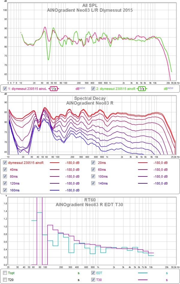

The room had concrete walls and was quite small. I lowered bass level a bit and lifted mid-treble too. I must say that a part of my success was perhaps music selection - Dire Straits, Pink Floyd, Eva Cassidy, Phil Collins, Chris Jones, Iiro Rantala, Herbie Hancock etc. pieces with great dynamics.

Others like the sound of AINOgradients too! Confirmed by getting the nomination for the "Best sound in show" at the Finnish DIY-audio event!
