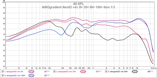

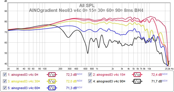

Here indoor-measurements at 1.5m distance. RTA/steady state response in-room is 16Hz -18kHz in a slightly descending (ideal) room curve. The upper end is limited because of Icepower D-class amplifier's input-impedance problem (but my aged ears don't hear that)

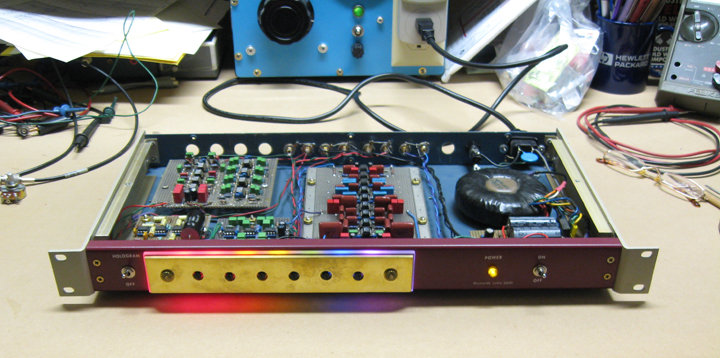

The speaker that got me going on open baffle design had two 8 inch drivers with a 1 inch dome tweeter in between them, mounted in a frame that was just two 3 inch side panels, no actual front board, drivers held in by their magnets, and that sat on top of a woofer cabinet. This system also had passive OB EQ, at the expense of system efficiency. For the first five minutes of listening, I didn't know they were open-baffle. I finally went up and peeked through the grill cloth, and said something like, "this can't work"... They created such a good 3-D effect that I immediately started researching how to make the best open baffle speaker system for myself.
Once you've made the decision to do the crossover actively, you've got a chassis with a power supply, which makes it relatively easy to add low end active woofer EQ (which works significantly better with a closed box woofer). It's also easy to add active OB EQ for the midrange driver. One big benefit which this active EQ approach has is that you get your efficiency back.

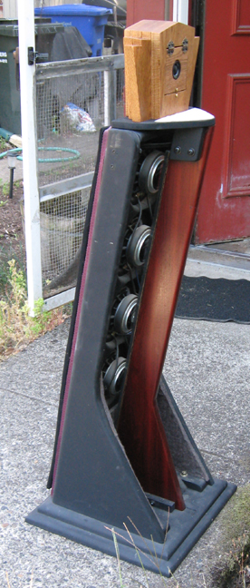

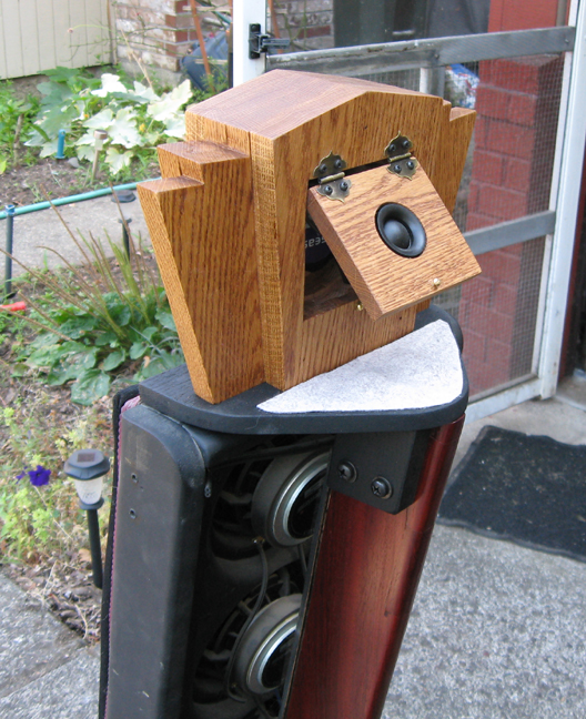

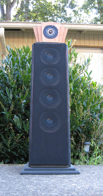

I'll upload a few pictuers of my OB system. The woofers (not shown) are in separate cabinets that can be positioned for better room acoustics interaction. The rear tweeter is only active above about 12kHZ. The triamp's xover Freqs are 100 and 1.4kHZ 4pole. Their weak link is integration if you sit too close. The tweeter sounds a little disconnected. At a distance of 6 ft. or more, it's not a problem, and they sound VERY nice with a good recording. They also work surprisingly well when I switch in my variation of the Carver Holographic Generator, which largely cancels inter-aural crosstalk when you sit right in the middle. Imaging is then wall to wall. I downloaded a bunch of binaural/Blumlein recordings off the web and they work reasonably well too with the Holographic Generator enabled.

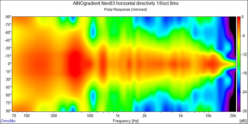

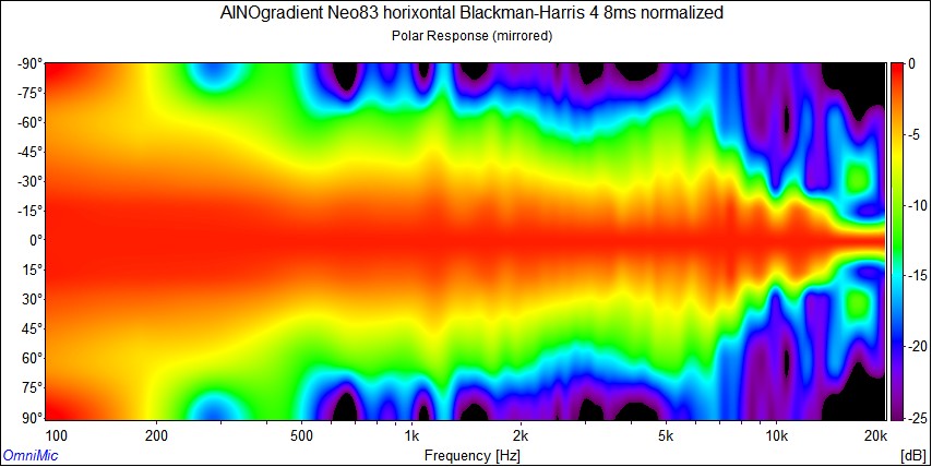

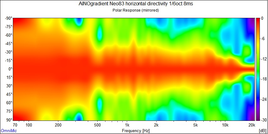

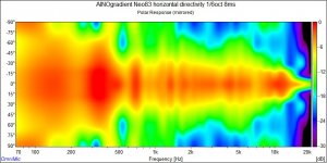

I copied REW measurements as .frd and run horizontal polar graphics in Omnimic software. 8ms gating and 1/6oct smoothing. Some room reflections are included. Notice that scale starts from 70hz! I should roll new polar measurements some day with optimized conditions...
Raw and normalized
Raw and normalized

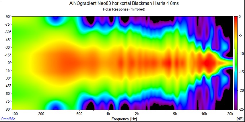

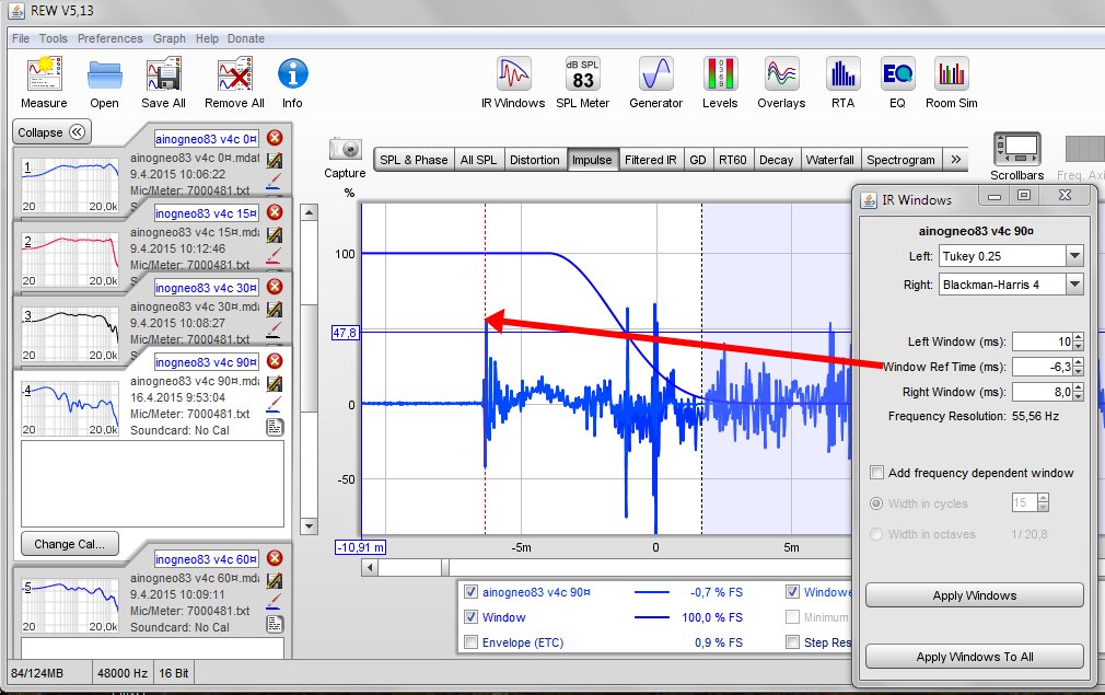

I played a little with old measurements' impulse gate timing and type. 90¤ measurement picks automatically the reflected sound as reference, because it is stronger. In REW we can move Reference timing, but I have only 4ms before the reflection hits. Using a softer slope like Blackman-Harris instead of Tukey however gives more range.
Below I show gating settings for 90¤. I used automatic gating BH4 slope for other angles. This way room effect is minimized. New graphics are more relevant in low F.
When we see measurements eg. these polar spectrograms we usually don't know parameters/setting that were used, there is no standard. Default settings are not the best for every purpose! And defaults are different for every program.

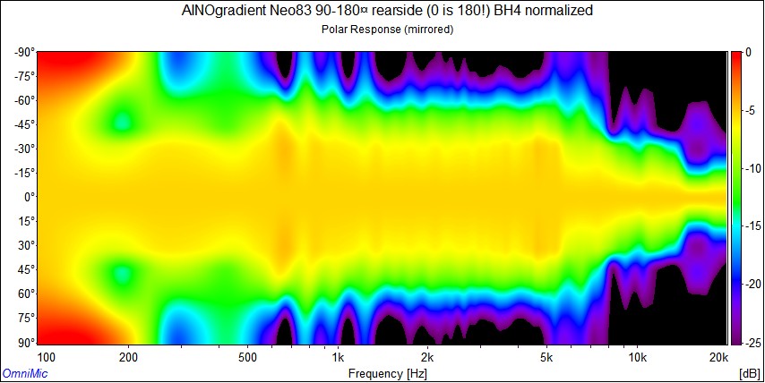

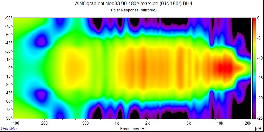

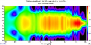

Rearside measurements of AINOgradient were done at smaller number of angles the last time, so this is not as accurate. Normalized looks a bit strange because hottest spl is way off-axis at low F.
Measured response is not symmetrical to frontside, because of measurement conditions. The speaker projects sound now to different direction and thus room reflections are not similar. In real life radiation is fully symmetrical above cardioid effect, except for some frame diffractions that are worse on the frontside. These are mirrored presentations, only one side turn was measured!
It is a problem with dipole nulling that cancels sound at near 90¤ angle. The direct sound arrives naturally first, but is weaker that the reflected wavefronts arriving later. Any 1ch measurement system like REW will automatically pick the highest amplitude-impulse for measurement. They are programmed that way and it works for 99% of measurements!
I get that problem with angles 75-105¤. I haven't corrected that im my provious directivity measurements and presentations. It is a detail, it doesn't harm the big picture. Not-corrected it only makes directivity look less dipolic than it really is!

I see you use OmniMic software for polar response plots. How does this software locate correct impulse peak? I assume you are using USB OmniMic?
With REW in single channel mode, it is better to move desired peak to t=0, otherwise phase is messed up. This happens regardless of how Window Ref Time is set up in IR Windows display.
How are you making measurements for time alignment of drivers?
These were measured with REW and UMIK-1. Response was IR-gated and smoothed in REW. Those responses were exported as txt files and then loaded to Omnimic V2. No processing in Ominimic, just polar graphics. I don't know any details of Omnimic.
I use a DAC for signal, and UMIK has it's own ADC, so 2ch measurement is not possible for me. If I used a speaker design/simulation program, 2ch measurement would make life easier. But I'm not in that level of diy!
I check time alignment by playing the whole (active minidsp-controlled) system (sine sweep) Then I reverse phase of every other driver. Then I look at frequency responses and step responses. During development stage I check phase match by playing only two drivers at same sweep. With dsp it is easy to change delay and measure again, and again , and again etc. Many times I have had phase rolled over one cycle, easy at highest xo!
