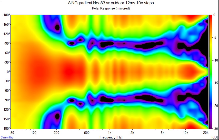

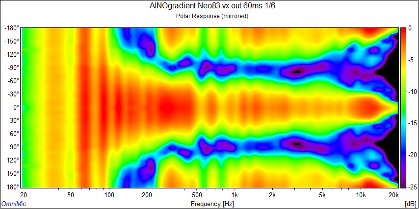

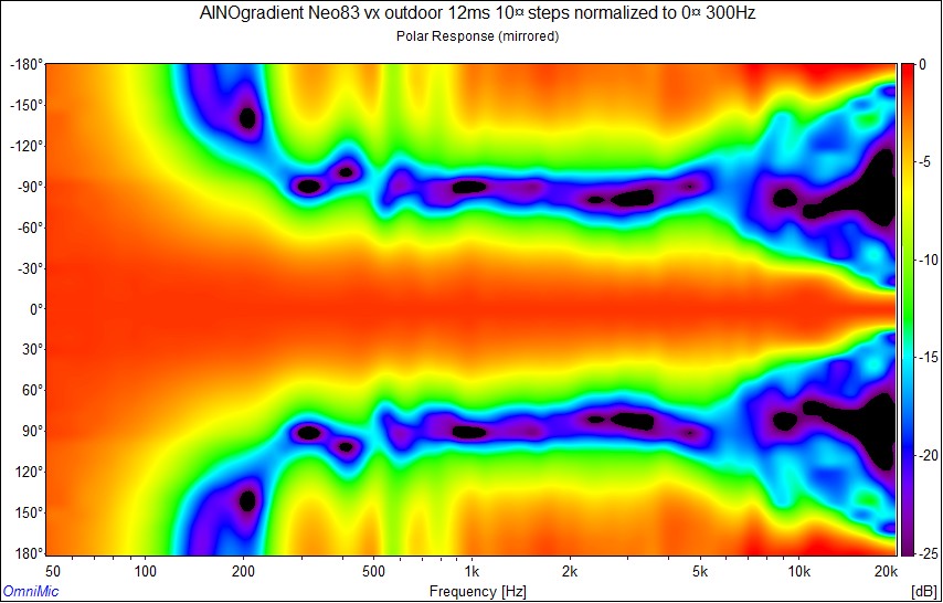

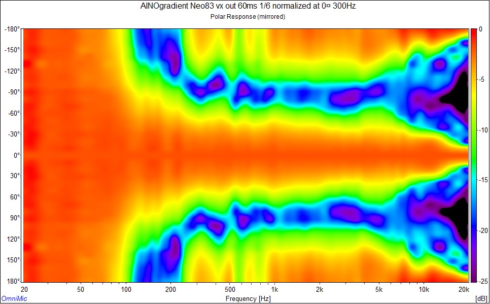

I got back to my last summer outdoor measurements and made new 0-180¤ polar plots of them. Measured outdoors at 150cm, 12ms gating, 10¤ steps. Some grass bounces betweet 500-700Hz. Notice cardioid response in transition area 100-200Hz between monopole bass and dipole mid-high sections.
Omnimic gives opportunity to normalization and polar graphics, still missing from the latest REW.

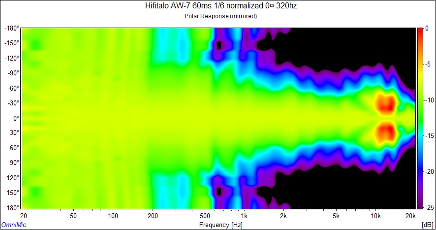

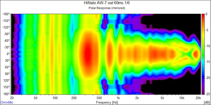

For comparison also 60ms windowed measurements and similar for a closed box coaxial with SEAS T18

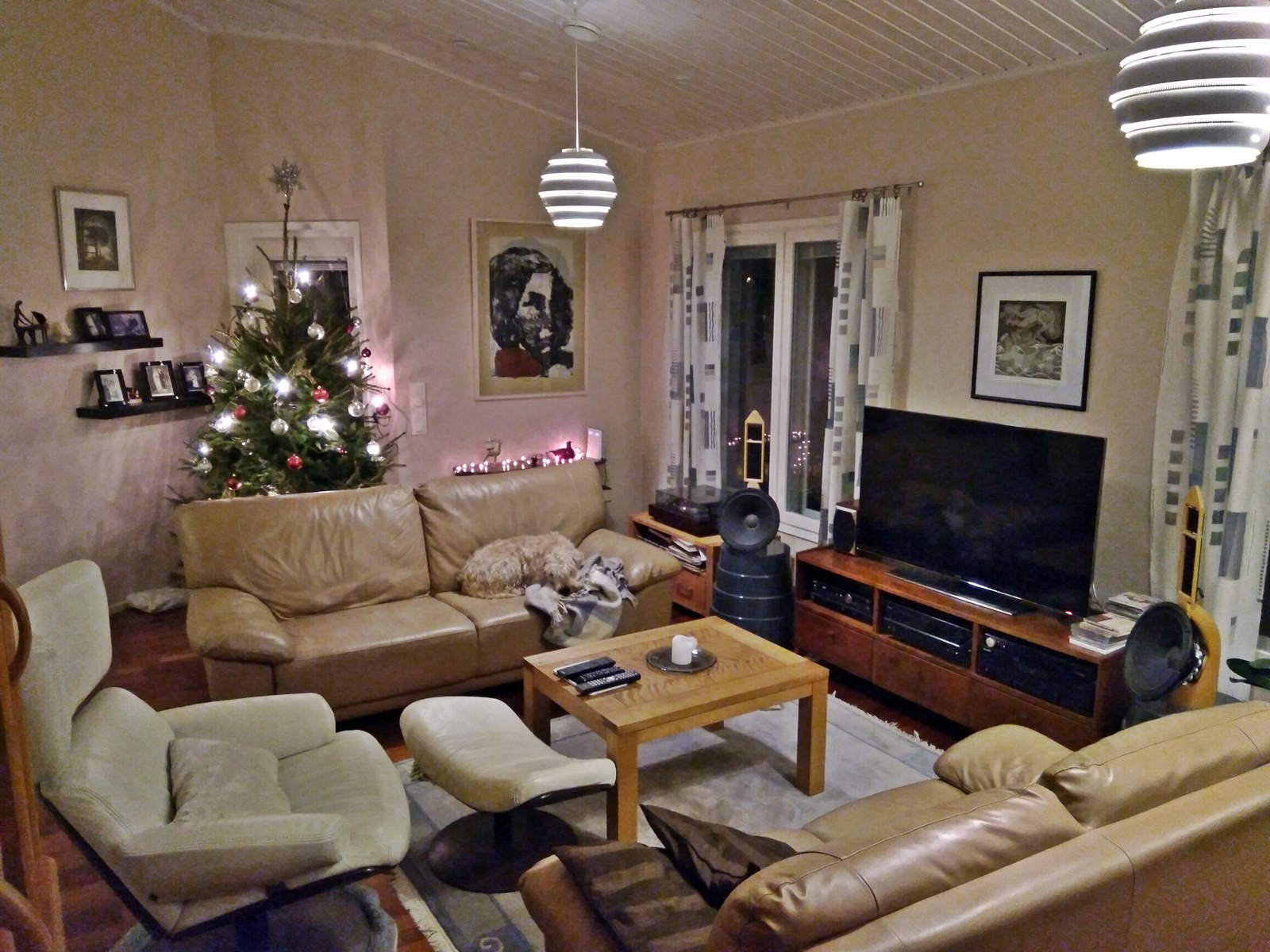

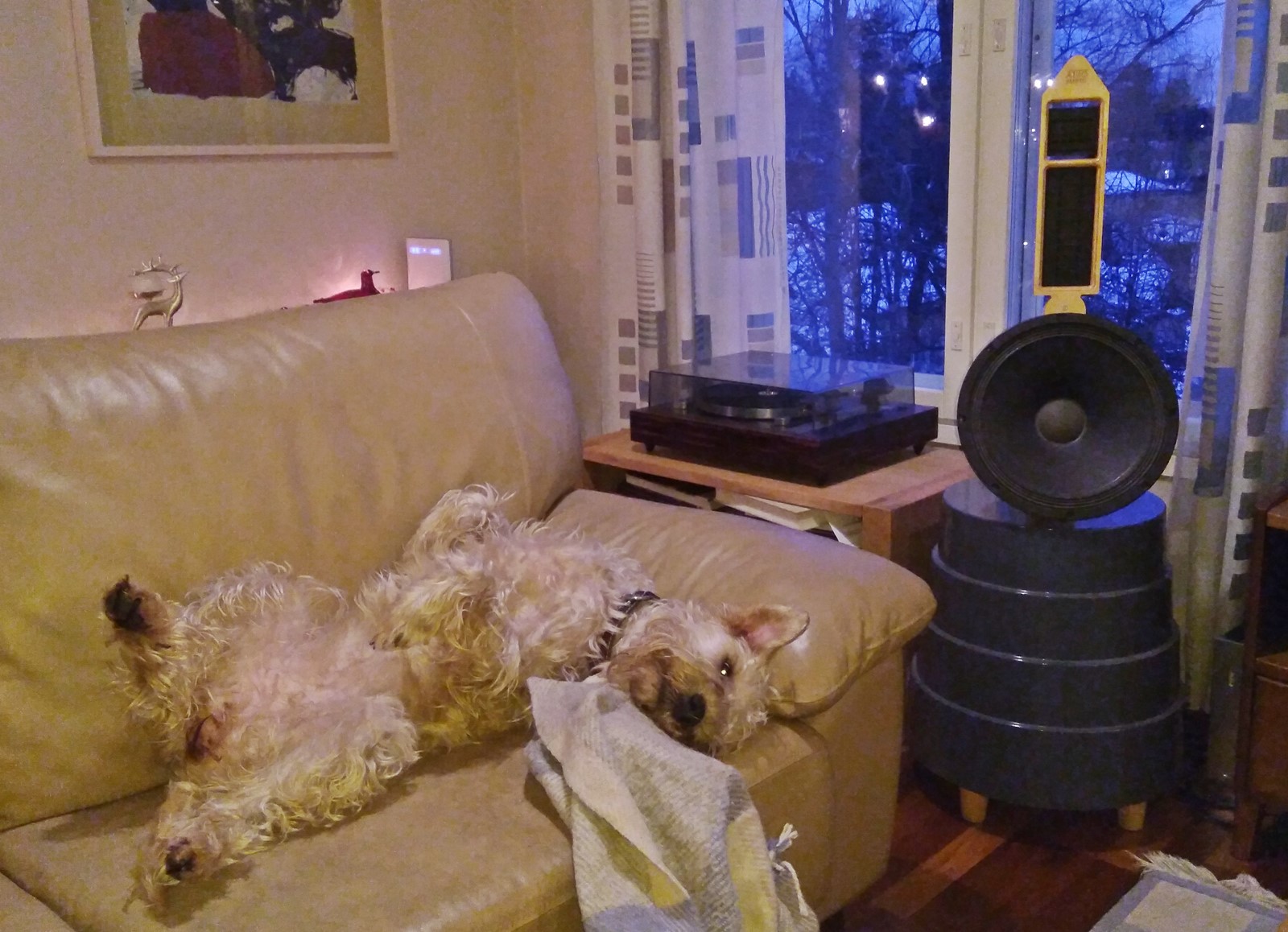

I have been listening to AINOgradients for 3½ years now. Minidsp 4x10HD and ICEPower modules have had power on all the time without problems. Looks like I'm almost finished with dsp settings too, and my wheaten terrier Willa likes them too!
Merry Christmas and a Happy new Year!
Her Master's Voice
