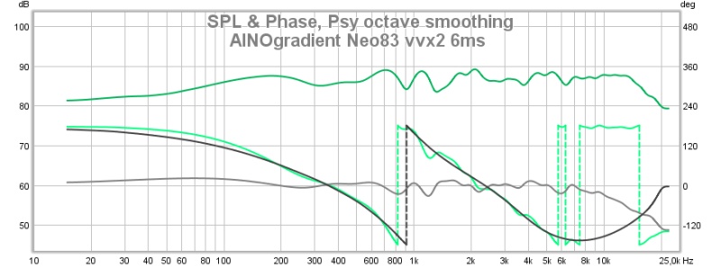

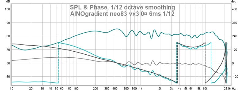

I have two preset xo version in my Minidsp 4X10HD. The earlier version has LR4 between mids and the tweeter. The later has LR2 acoustic in all three crossings. I like the all-LR2 better, more musical and natural. LR4 measures a little better though, with less distortion.

manninen - I haven't made standardized polar or distortion measurements for a long time and I haven't saved the quick ones. In attachments we see phase of vx2 (LR4, lowest LR2) vs. v3 (all LR2).

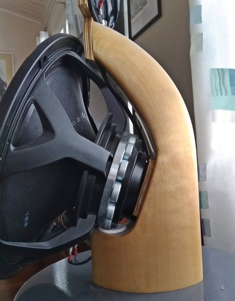

@Juhazi, can you share a close look of your mounting scheme on woofer? how do you attach it to the panel?

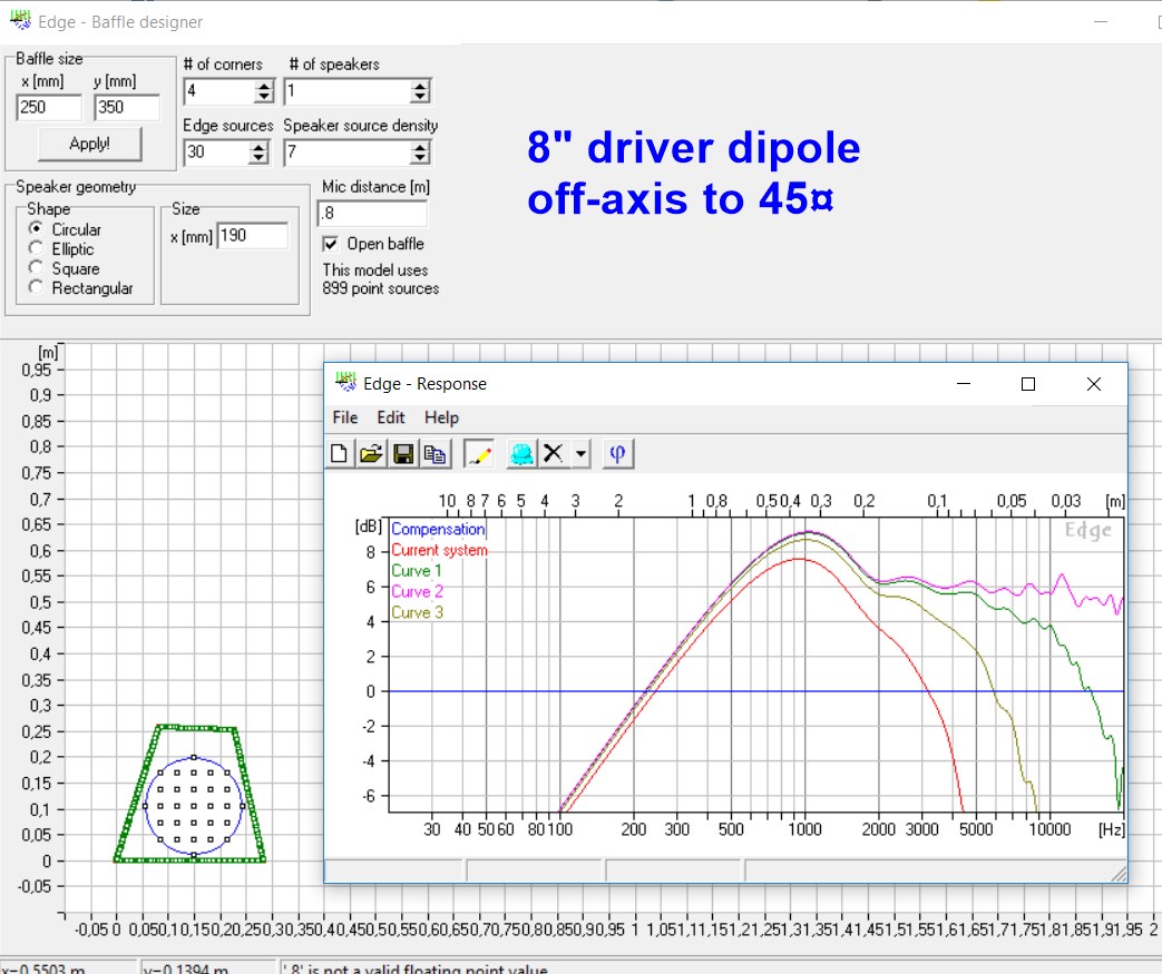

Hi Gadut, please still consider using a 4" driver instead of 8"! A 8" will beam too much and the 12" can easily play up to 1000Hz. Kreskowsky and Linkwitz use 4" mids too.

The 12" is resting on a cutout in the pole. Velcro strip on back of magnet is used to hold it still. It is not as solid as I would like but I don't want to use glue. I use slow sweeps to study mechanical resonances - listening and measuring.

Hi Juhazi, pyramid shape that I will use is an empty baffle, the metal frame is only to hold the driver. so it will be baffless. 8" is not mandatory size for me, for sure I'll play later with another fullrange, hence my panel support for fullrange should be replaceable.

That is good picture for my reference, many ideas on my head now on how to mount the driver... going to metal shop might give another ideas too from the experienced guy there.
Yes it is a good idea to play with different drivers and crossovers. A single proto is enough and open baffle mono sounds really nice !
The differences between different drivers (when adjusted well) are actually surprisingly small when listening. But expect some 6 months to make it really sing!
