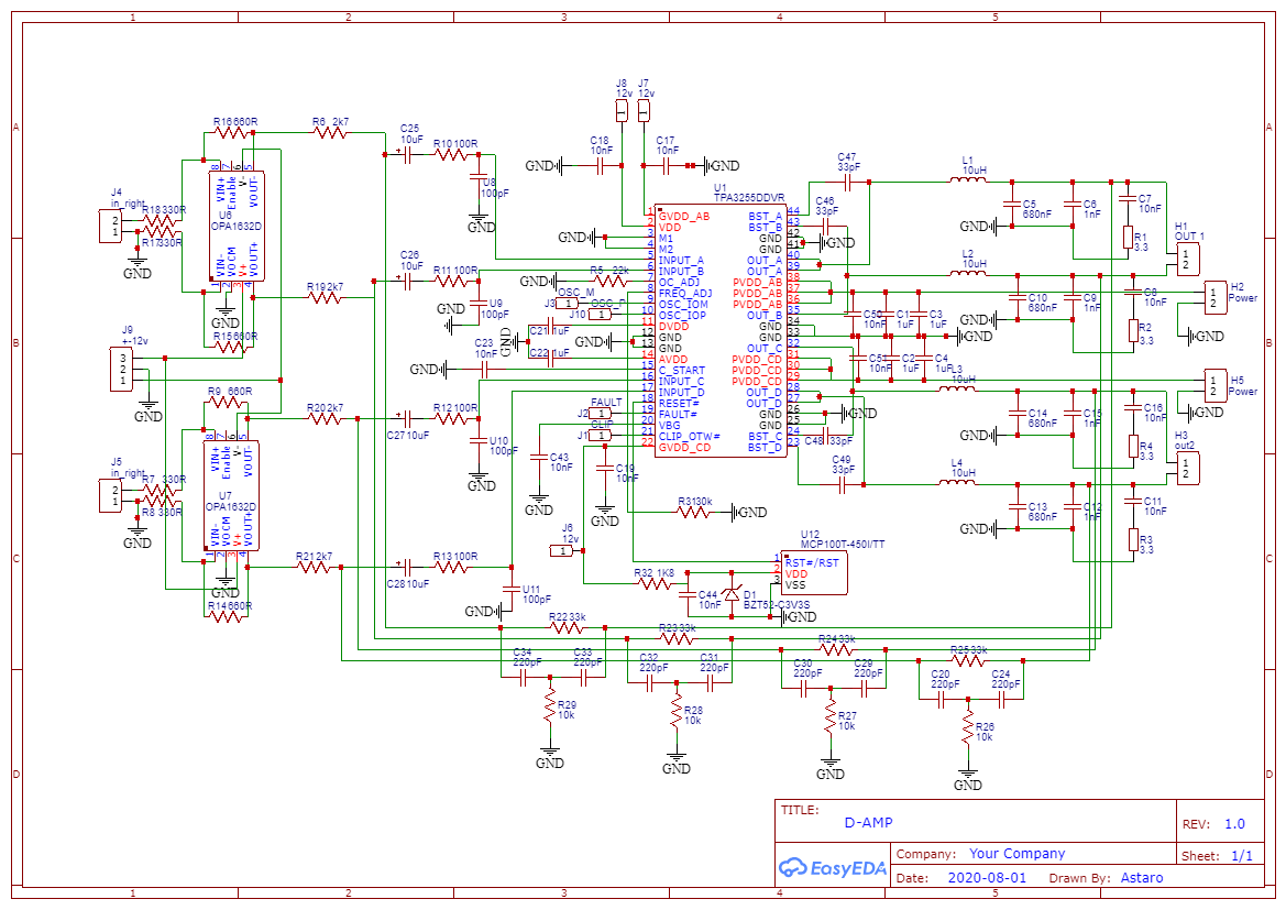

I build that with a OPA1637.
Note that the value of the OPA1632 in the schematic are strange because the low R values will act a voltage divisor, then probably that's why the gain of the diff buffer is 2.
Simulation show that the overall noise is quite same with 1k for every R (gain=1), with an overall gain quite same also because it does not act as a voltag divisor at the input.
Knowing output impedance of the source can clarify that (usually near 200 to 400 ohm).
To Brad Pitt
Indeed, the resistances of the resistors are very small. I do not know the reason for choosing such denominations by the author of the scheme. The resistance of these resistors (R15...R18 and two canal) can be increased 20 ... 30 times without compromising quality.

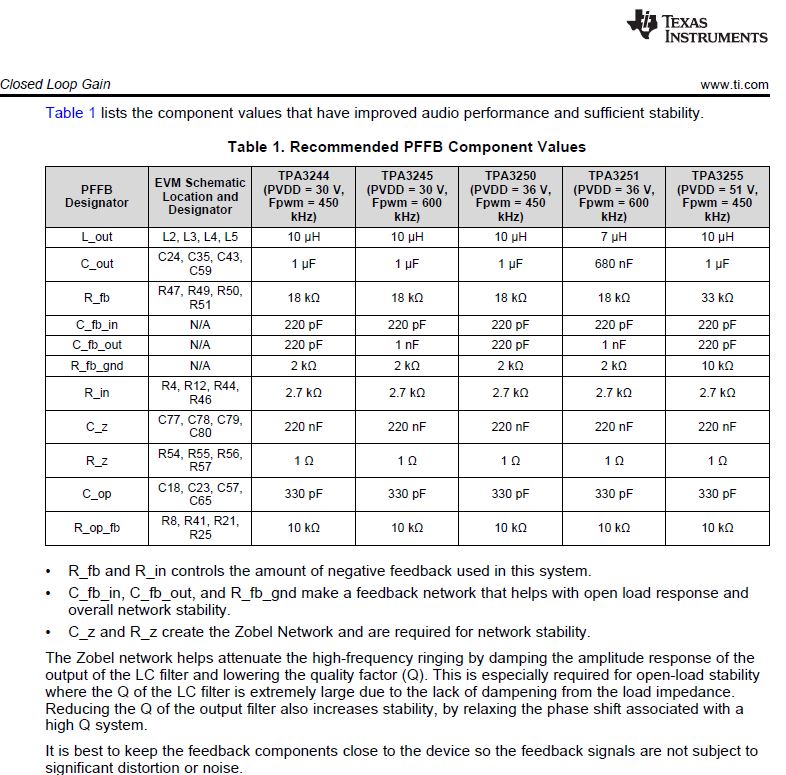

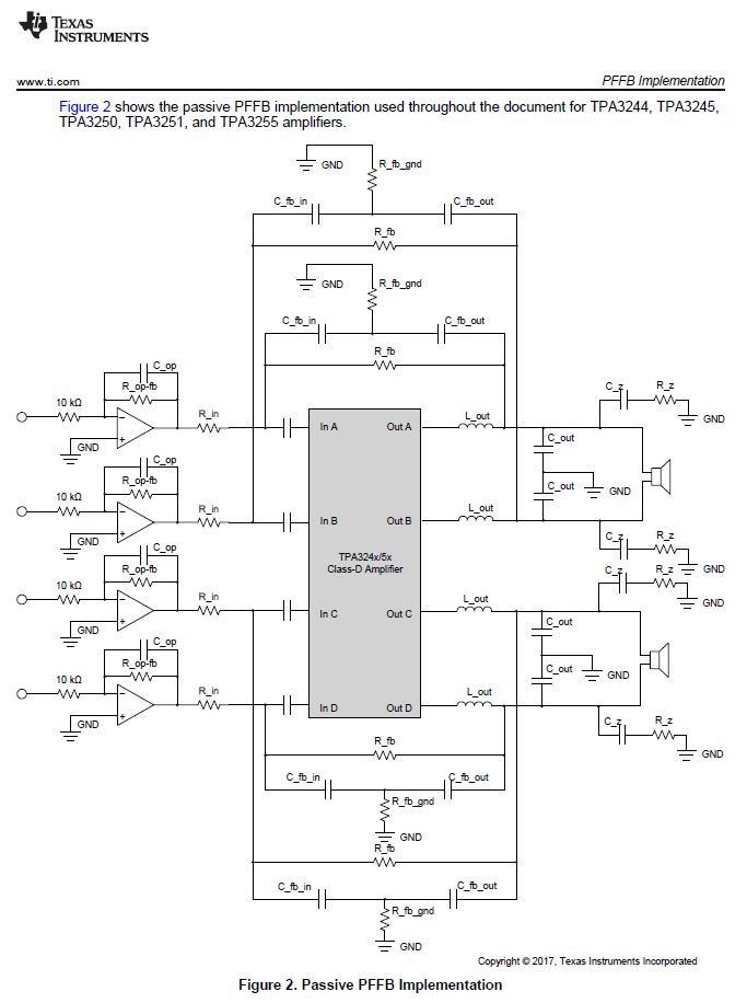

Looks like the TI proposed Opamp feedback capacitor (Cop 330pF) was removed and a 100MHz filter added (R10-13 100 ohm, U8-U11 100pF) to the input of the TPA3255 to filter out the switching frequency.
