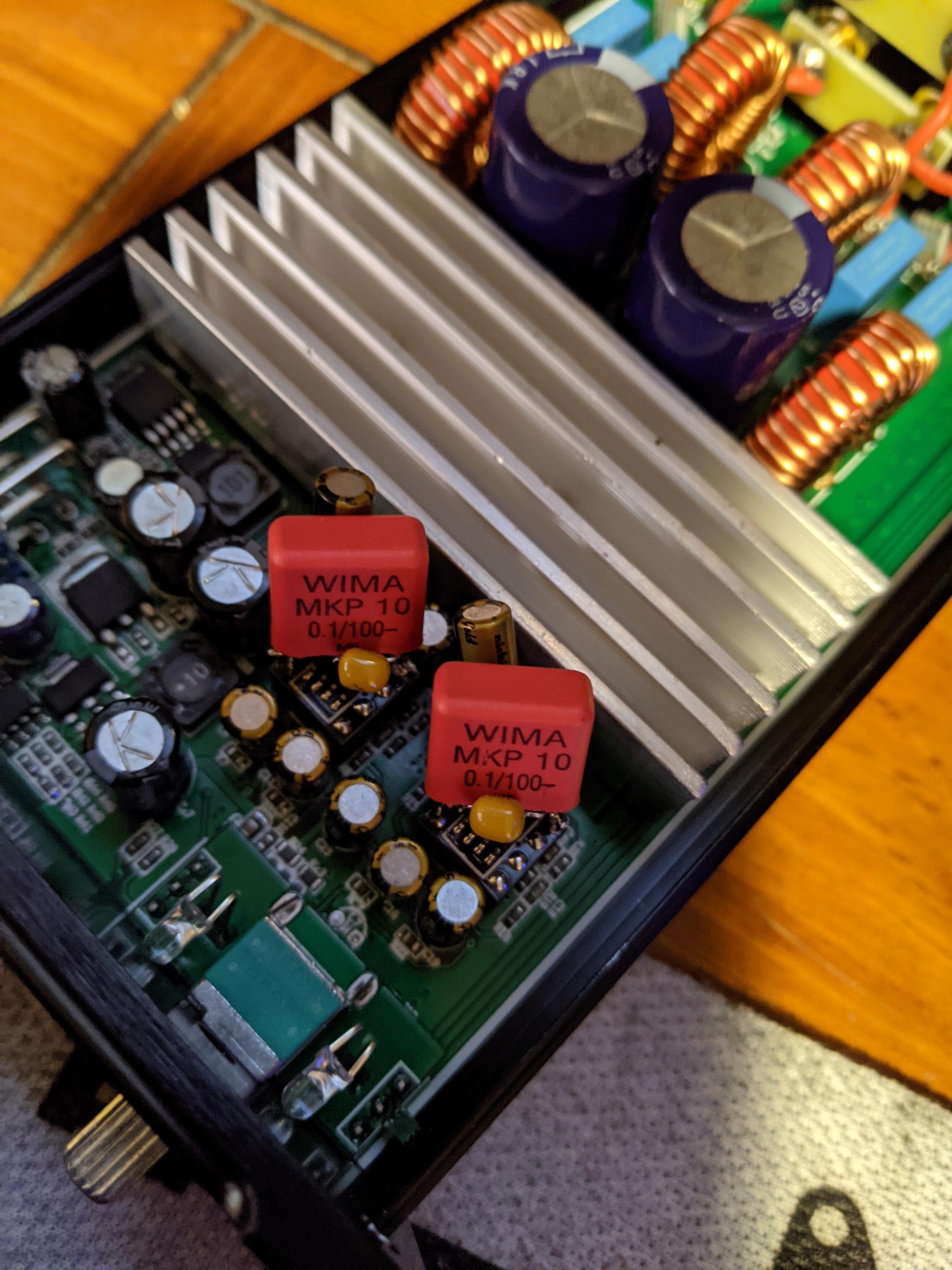

OPA bypasses complete, for now.
Wima 0.1
10uf X7R
22uf Lytic
I also changed out the .1uf ceramics for the Panasonic .12uf PPP's. I did every change one at a time to preview them. Moving to PPP on the main caps was a big difference. I did end up adding a 4.7uf X7R on those as well as I do think it sounds better. I also swapped the PPP for the C0G on the center of 5 caps.
So every current modification from the stock amps are as follows......
a) Swapped main caps for United Chem-Con 4500uf low ESR
b) Bypassed the main caps with 1ea .12uf Panasonic PPP and 4.7uf (took the place of the 2x2.2uf to save space) X7R
c) Bypassed the center of 5 caps with Panasonic .12uf PPP
d) Swapped all 9 DC blocking caps with 22uf Nichicon Gold
e) Brown Dog OPA1656's
f) OPA bypasses listed above (1ea .1uf WIMA, 10uf X7R, 22uf Nichicon Gold

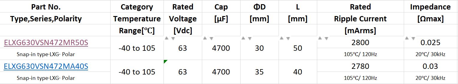

What was the voltage rating & part number of this United Chem-Con 4500uf capacitor? I don't see those anywhere.
United Chemi-Con | Aluminum Electrolytic Capacitors
I do find these United Chem-Con capacitors, but there are pretty large.....
ELXG630VSN472MR50S & ELXG630VSN472MA40S
I believe that they were these...
Nippon Chemi-Con Corporation / Aluminum Electrolytic Capacitors
https://www.mouser.com/ProductDetai...jGEHgEeI2DT7WynG6qgIvc%2BtzXN7h6iXsv8a49SrzvP

On another note, I had a look at the pix.
Does the board find its way back into the casing smoothly? I can't see well, but the underboard PPP caps look really quite big... 2 of them are soldered to the big PS caps and if they get lose or make a short with the casing that could be the end or worst - lot of energy there.
Of course, if you intend to put tat board in another casing with lot of underboard clearence then just ignore all this
I hope this helps
Claude

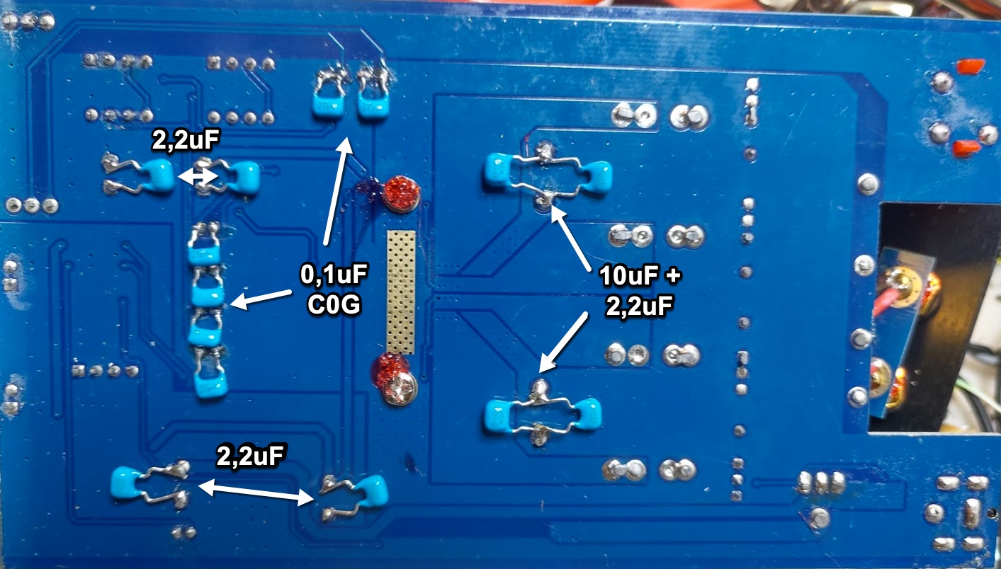

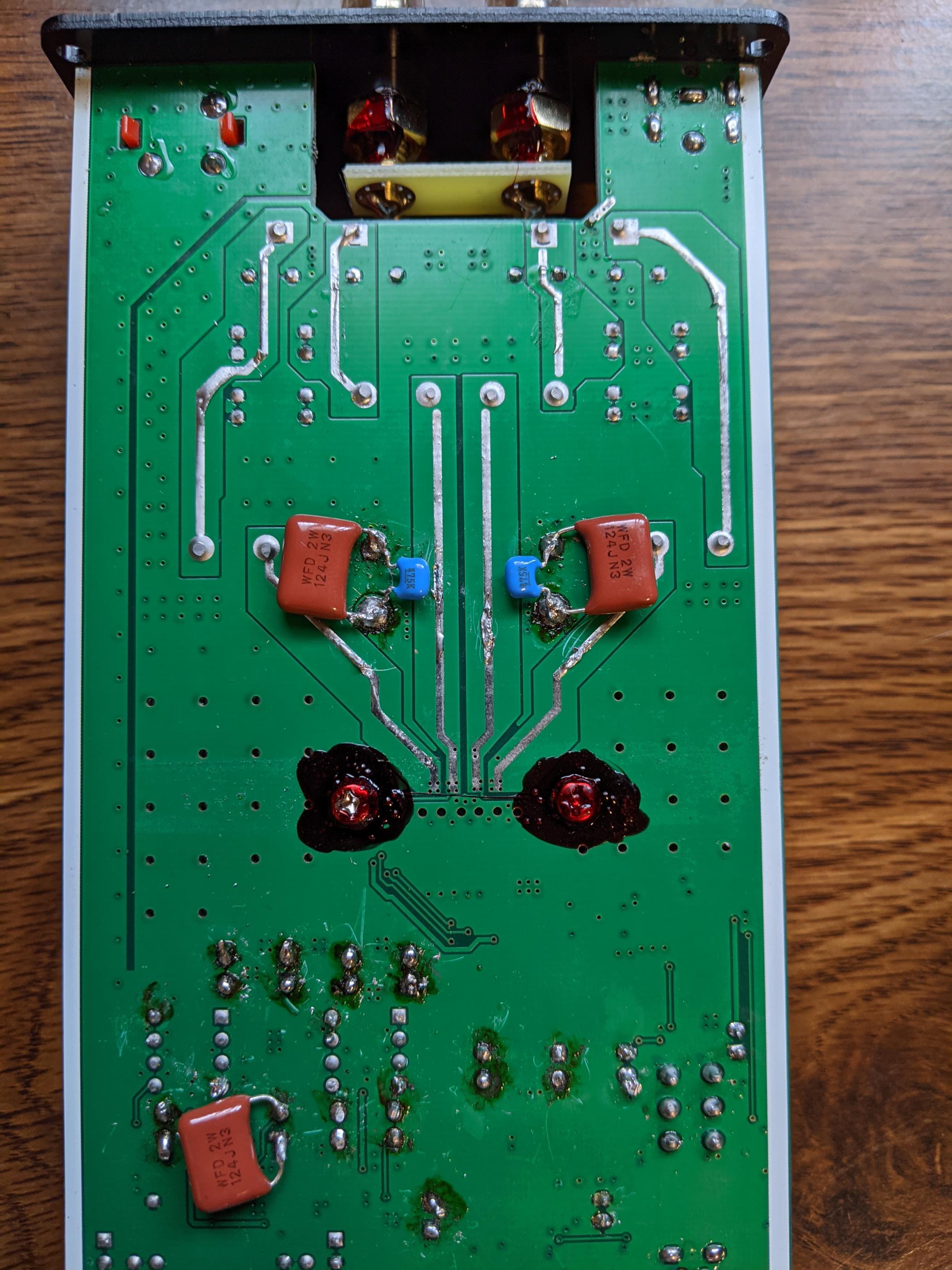

Hello! Has anyone figured out the marking of the nameless chip ? I need to replace it.

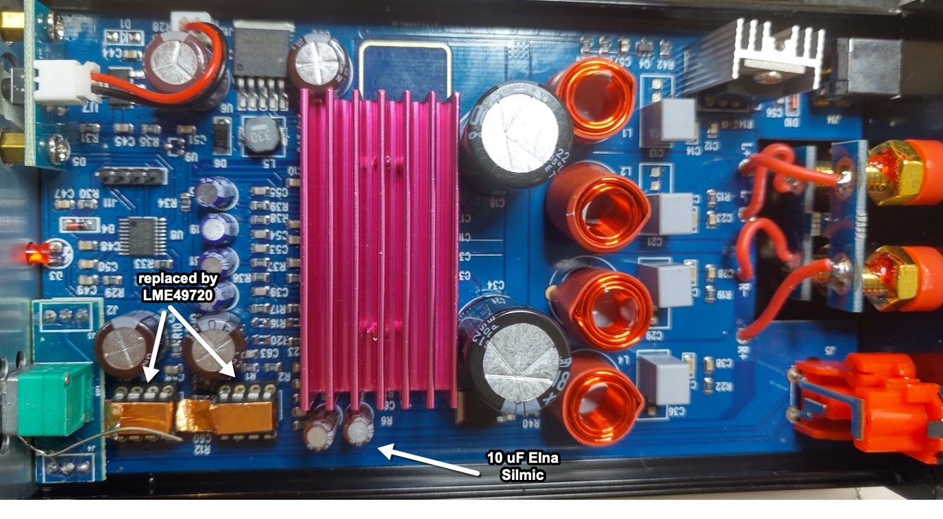

Not having an Aiyima TPA3251but one of those pesky FXAUDIO FX502SPRO instead?
Well, they are slightly worse than the Aiyima but still similar enough to be able to upgrade in a similar fashion and with a very satisfying result.
All caps is the same type as described in this thread. The copper tape around the op amps is soldered to a wire and connected to ground. It improves the sound somewhat, just make sure the tape is connected to ground otherwise it will act as an antenna and not do anything good.
Input caps are the ones in the bottom of the image. They were 2,2uF ordinary things. 10 uF Elnas and bypassed by 0,1uF G0G lived the sound up. Maybe I will remove the 0,1uF if I still think the sound is to bright.
I'm going to add an external PO89ZB filter for the power supply, but otherwise it is not worth the effort and the expense to go further.
The sound is bright and a bit "in your face" but really lifts the dull lifeless sound from before.
