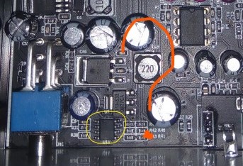

Hello! Has anyone figured out the marking of the nameless chip ? I need to replace it.

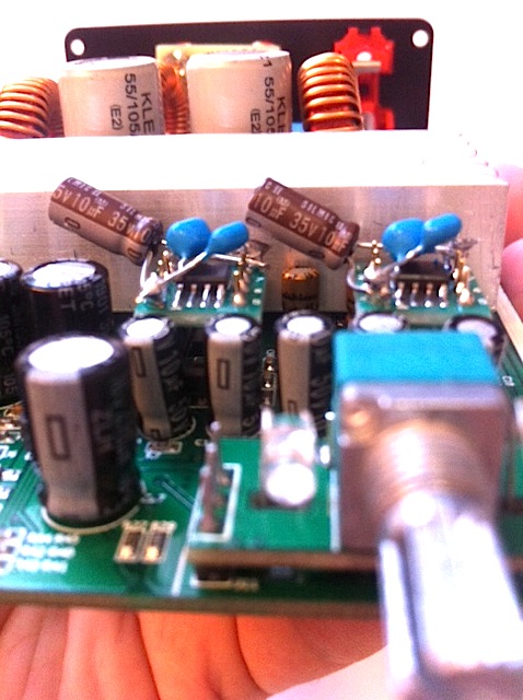

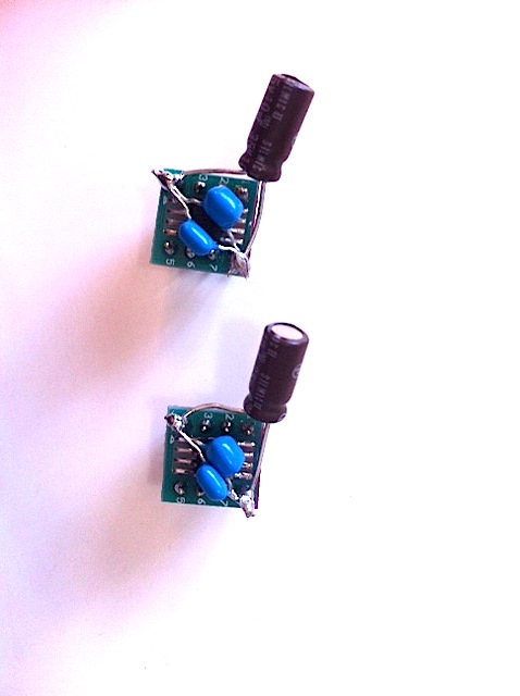

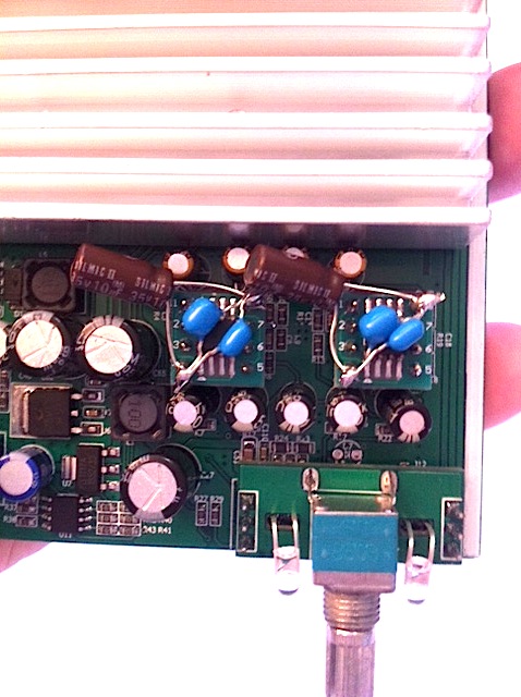

Some ask me to post pix of the last OPA board I did with all the bypasses... can't reply per PM so I post here
Sorry for the low quality pix (colour and of course all legd are straight, just my phone lense not liking close ups)
On the first board the caps are apart as they sit very low to leave air for the OPA... on the second board I realised I had more "ceiling space" than in some of my other builds and I joined the caps... sitting slightly higher to have some air for the OPA. Pretty academic anyway...
May that be of some helps
Claude
PS:
Claude

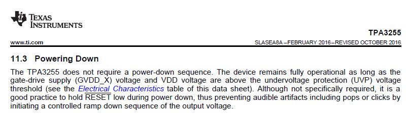

This is an 8-pin chip with worn markings, probably responsible for the anti-pop function.
This is the chip that provides the Anti-Pop function. It is not present on the Early Aiyima A07 which pops nicely when you turn it on. Later Aiyima A07 models had the chip present - I don't have one of these to comment ??
Aiyima A04 with the chip present are almost silent at power up.
Hi, I confirm, the new A07 version has anti pop chip and the old is missing. I owned both and no pop @switching ON / OFF on the new version only )

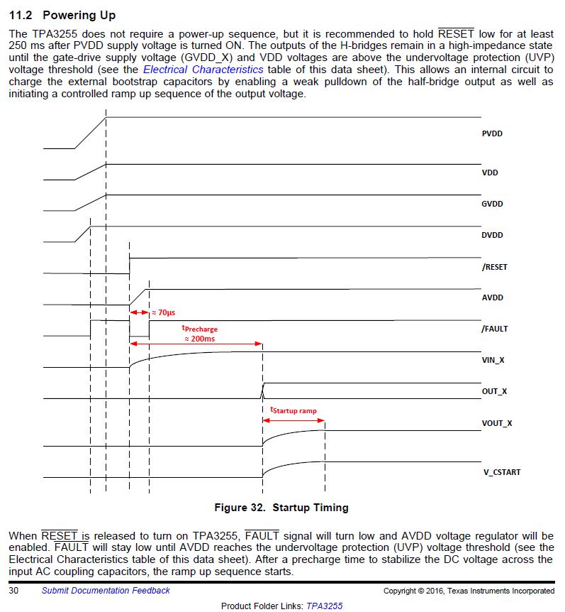

does anyone know the label of this chip and where to order it?
The TPA3255 IC has the RESET pin to control & prevent clicks during power up and down. Slow rise on power up and quick drop on power down. The pop circuit just needs a slow RC time power up and quick turn off for the RESET pin..
TPA3255 315-W Stereo, 600-W Mono PurePath™ Ultra-HD Analog-Input datasheet (Rev. A)
That unmarked IC is unmarked on my Aiyima 04 amplifier also.
My Aiyima 04 takes 10 seconds to turn on.

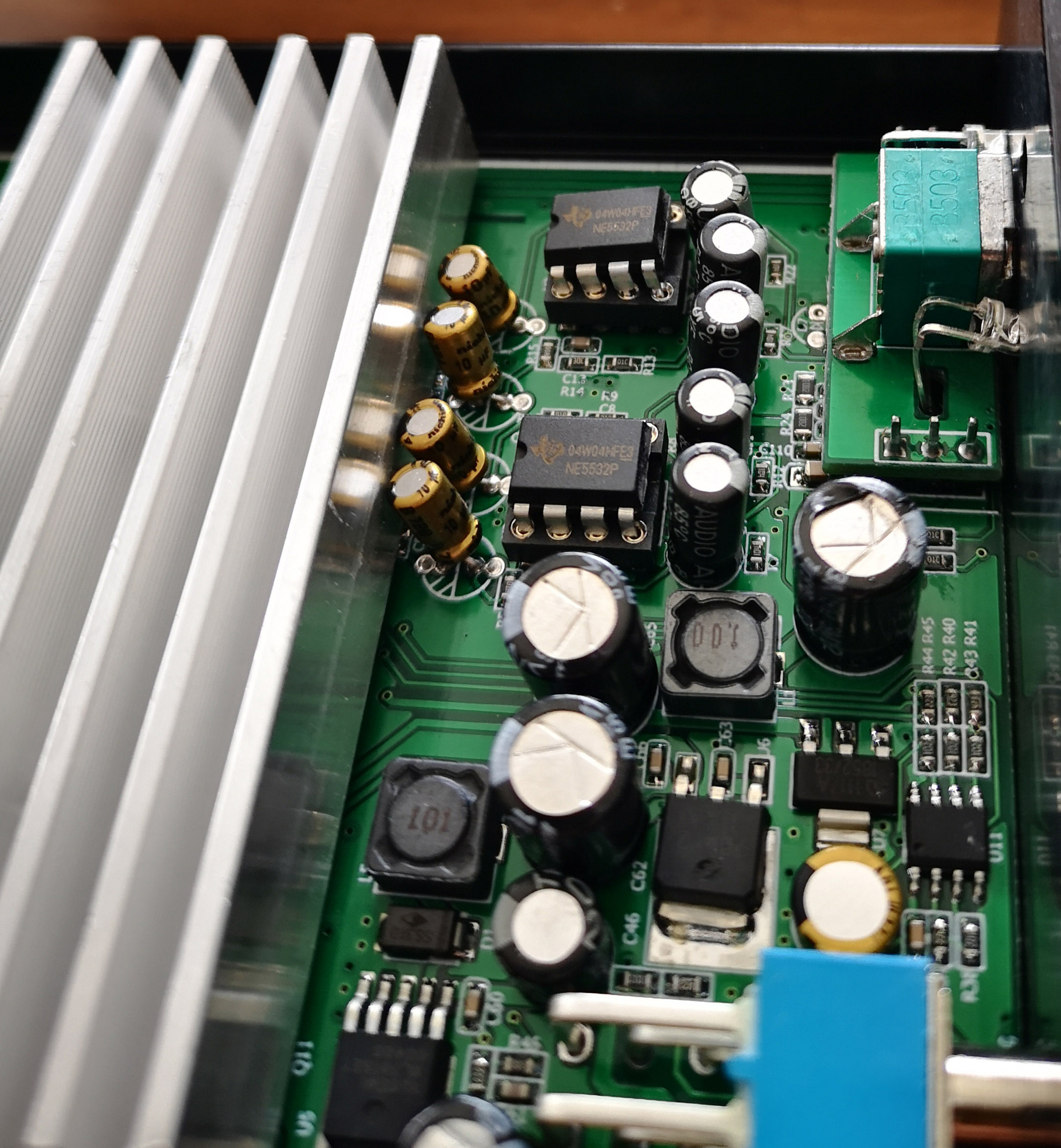

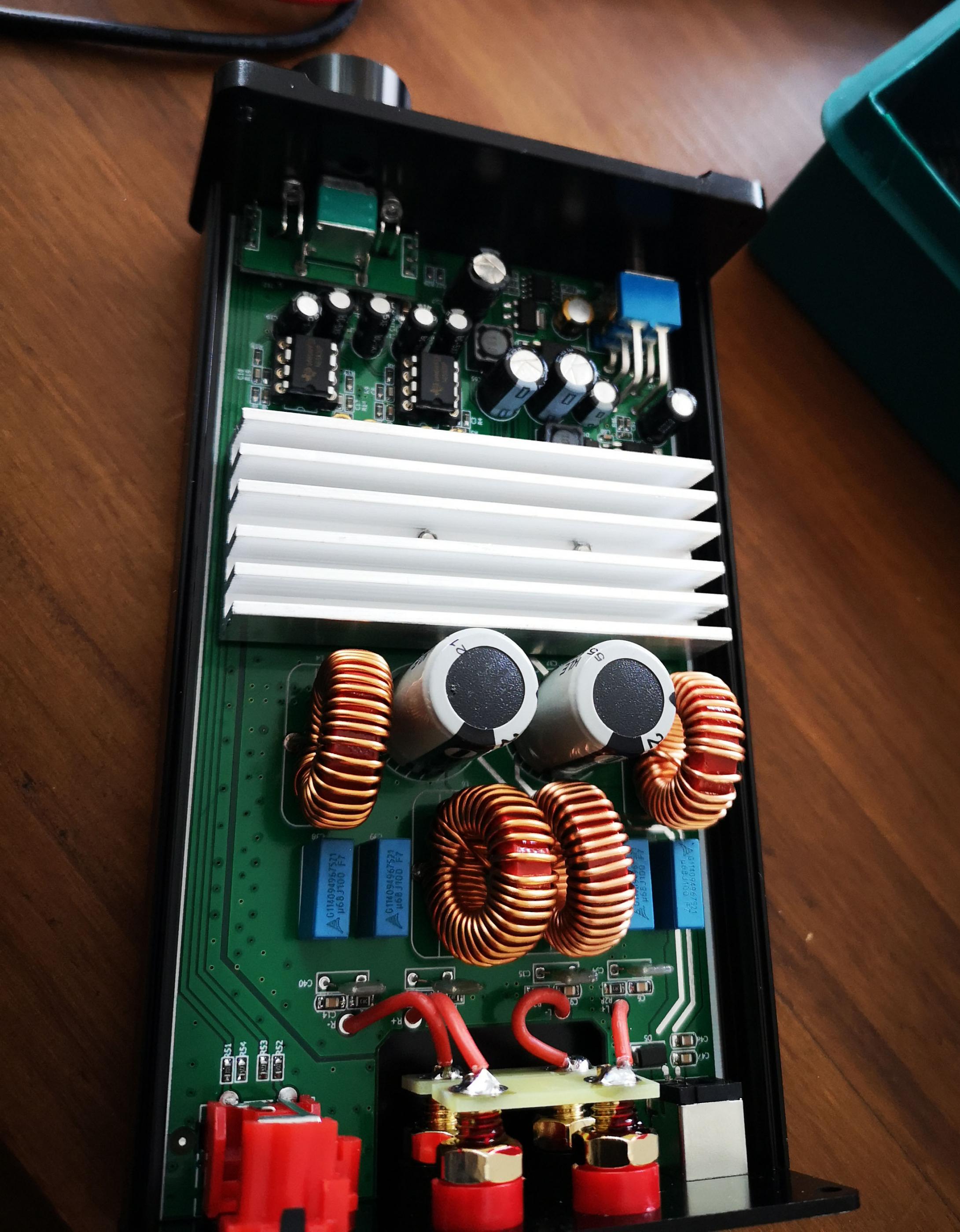

Hi fellas
First of all I want to thank you all the cool stuff you do on the forum that shows newcomers the right path to follow in this complex audio world.
Specially ClaudeG, Gilles and Rob for the astonishing work they have done researching with this amp.

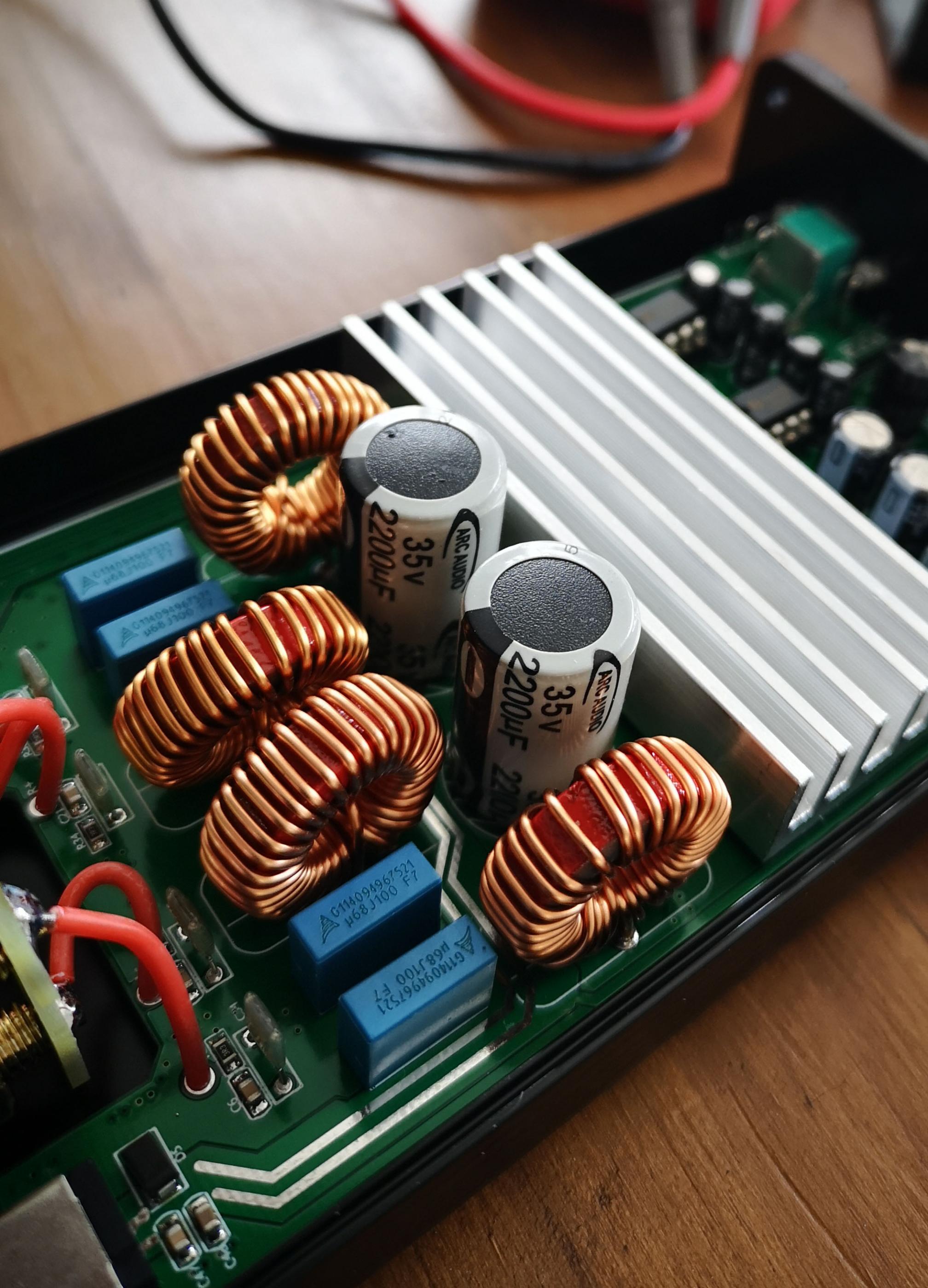

This week I got my Aiyima unit. I’m quite amazed about the build quality it seems very well made. Could the nichicon caps be original?
Time to customize it
Cheers

Welcome on board
The caps you have are similar to the ones inside the 3rd unit I purchased. Now, what is original and what isn't, that's another matter with these units LOL
I bypassed these PS caps exactly as we did in the past and it worked great again.
It is difficult to say if you would benefit from replacing these PS caps altogether. My bet is you get the most of it simply bypassing them, but of course going low ESR and high ripple can't harm. Adding capacity though isn't really profitable as for linear PS and class AB amps.
To my knowledge sadly no one went the trouble to bypass the existing PS caps and ONLY THEN to replace them to see if further improvement could be obtained - you could be the first and report. Some did swap the caps and reported a gain, but then the gain with the bypass was smaller, so did they really improve things overall and if so how much is still a question mark.
Note though that we did ADD consequent quality caps in parallel to the existing ones (more than doubling the initial 6000uF we had) and that made little to no change, letting us believe that we were nearly done in that area and hence not going the trouble to swap them (I still have them lying around), concentrating in other areas...
Good luck and keep us posted
Claude

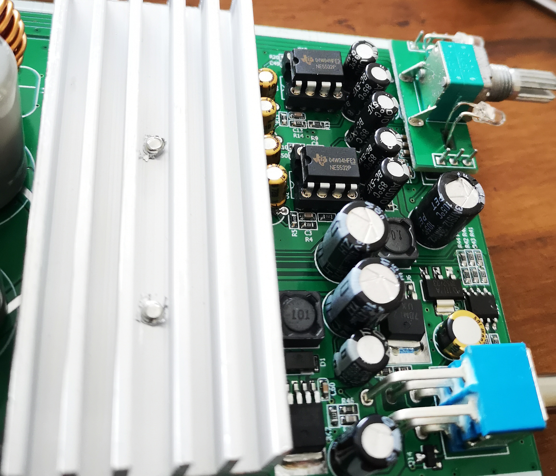

.....This week I got my Aiyima unit. I’m quite amazed about the build quality it seems very well made.....

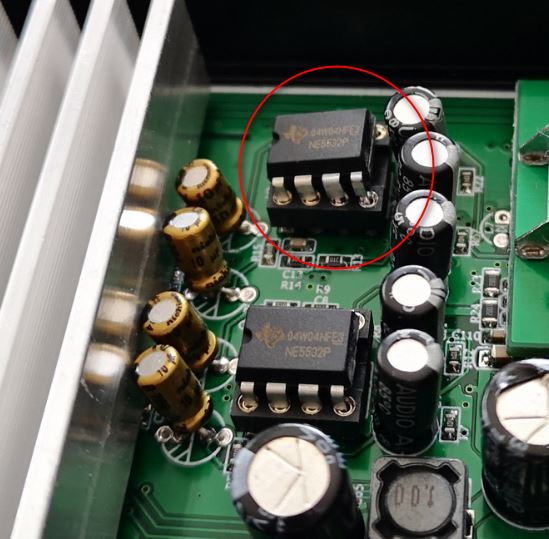

It looks like the LM5532 is not seated fully.
Thanks! Unfortunately, I do not have sufficient knowledge in electronics. Maybe there are experts on the forum to give advice on how to get around a broken chip? Or give a guess what kind of chip it is?
TPS3802 400-ms delay, small supply voltage supervisors with manual reset
TPS3802 Datasheet: https://www.ti.com/lit/gpn/tps3802
>> TPA3251 Evaluation Module User's Guide
Yes, it was. Not fully seated. Now it's ok
