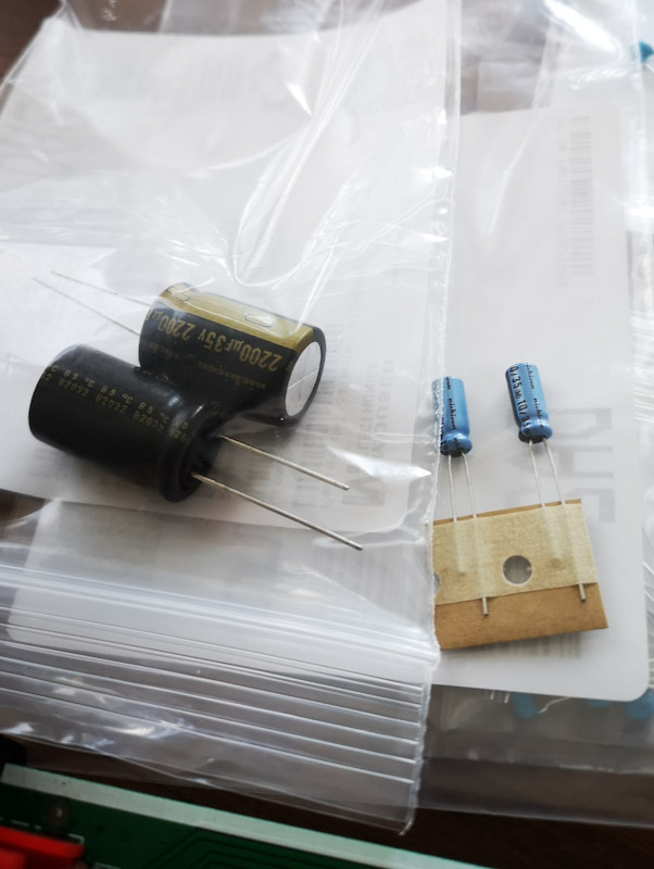

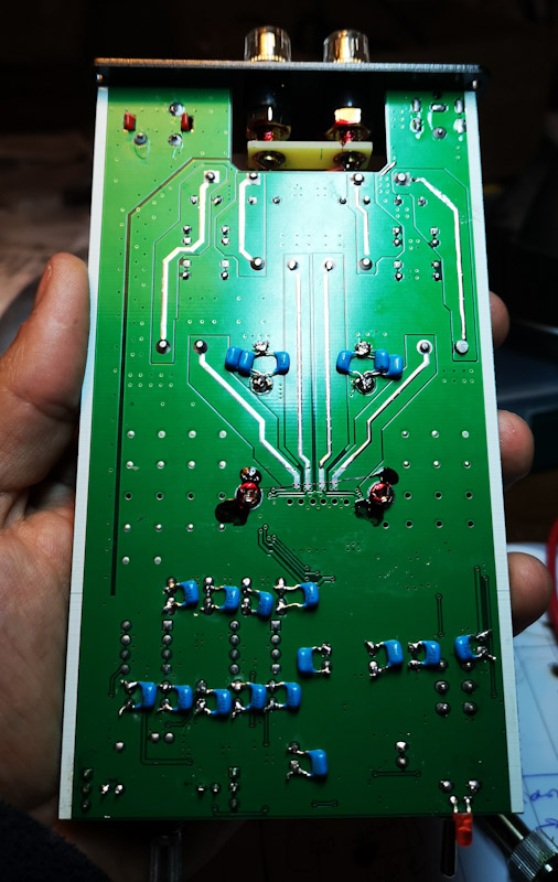

Bypassing is easy and gives instant benefits. Nothing to remove, no risk to destroy anything.
Of course you can go further and also replace existing caps. We did not follow that way, so can't report. It also depends with what you replace the existing caps.
Only replacing existing caps with no bypass will possibly not give as good result as only bypassing, not benefiting from the overlapping of different caps technologies. Hope that helps !

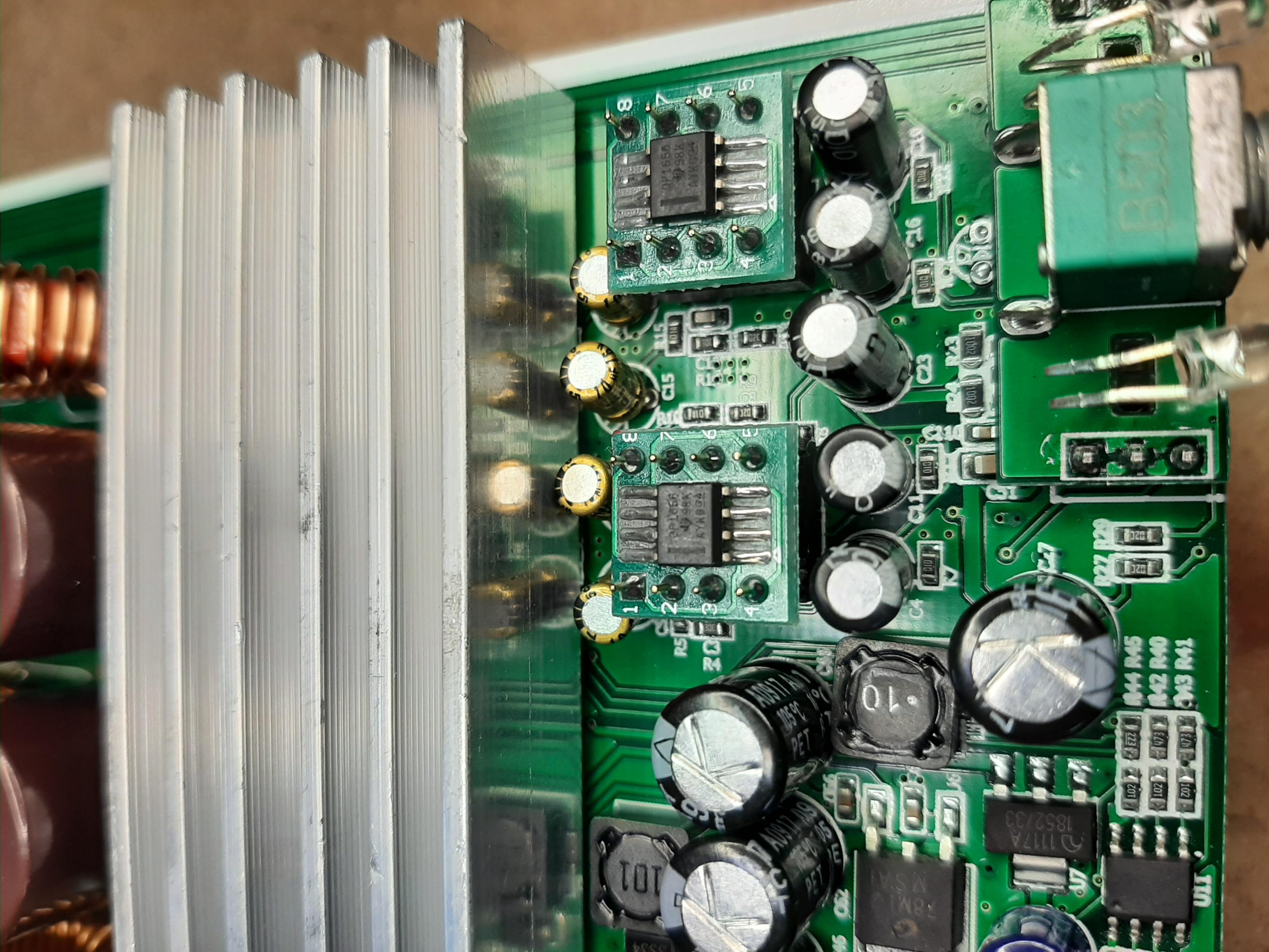

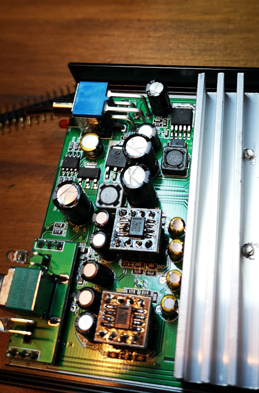

Would you change the caps or it is better to bypass them? Maybe both?
The black ones... KZ? If so you could bypass them with cheap small Russian PIOs, Jensen, Obbligato Gold or with ELNA Silmic II - to smooth the upper midrange. The blue ones are Nichicon KA? If so I would change them to Nichicon VZ, KZ, FG, FW or ELNA Silmic II, RBD (bipolar), Tonerex, Stargate.
