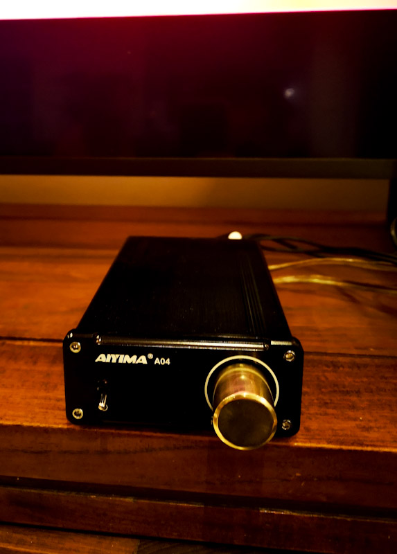

I'm using it with the power supply they sell € 18,21 25%de DESCUENTO | AIYIMA-Adaptador de AC100V-240V de 32V DC32V 5A, enchufe de la UE, EE. UU., 5,5x2,5 MM, cargador de fuente de alimentación para amplificador TAS5613 TPA3255 TDA7498E

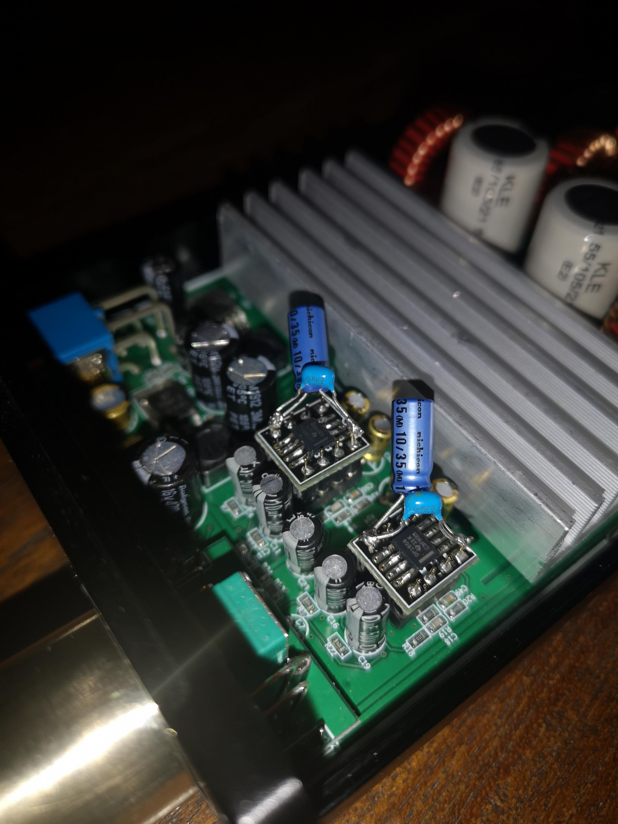

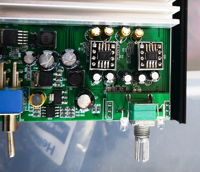

AIYIMA 32V AC100V 240V Adapter DC32V 5A EU Plug US Plug 5.5 x 2.5MM Power Supply Charger For TAS5613 TPA3255 TDA7498E Amplifier|Amplifier| - AliExpress in Aliexpres. Didnt like how it sound the first time I played music in it. Now is a diferent history. Is not noisy just the sound weren't that clean and detailed. CAUTION SOLDERING THE OPAS TO THE ADAPTERS mines are different and they are looking to the opposite side. Aren't As most of the pics published here.

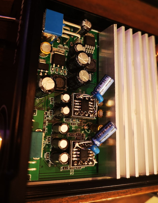

It's done. As mouser didn't have the elnas I bought nichicon. It sounds awesome. Thanks again guys. The 24k gold is hand made is somebody is wandering.

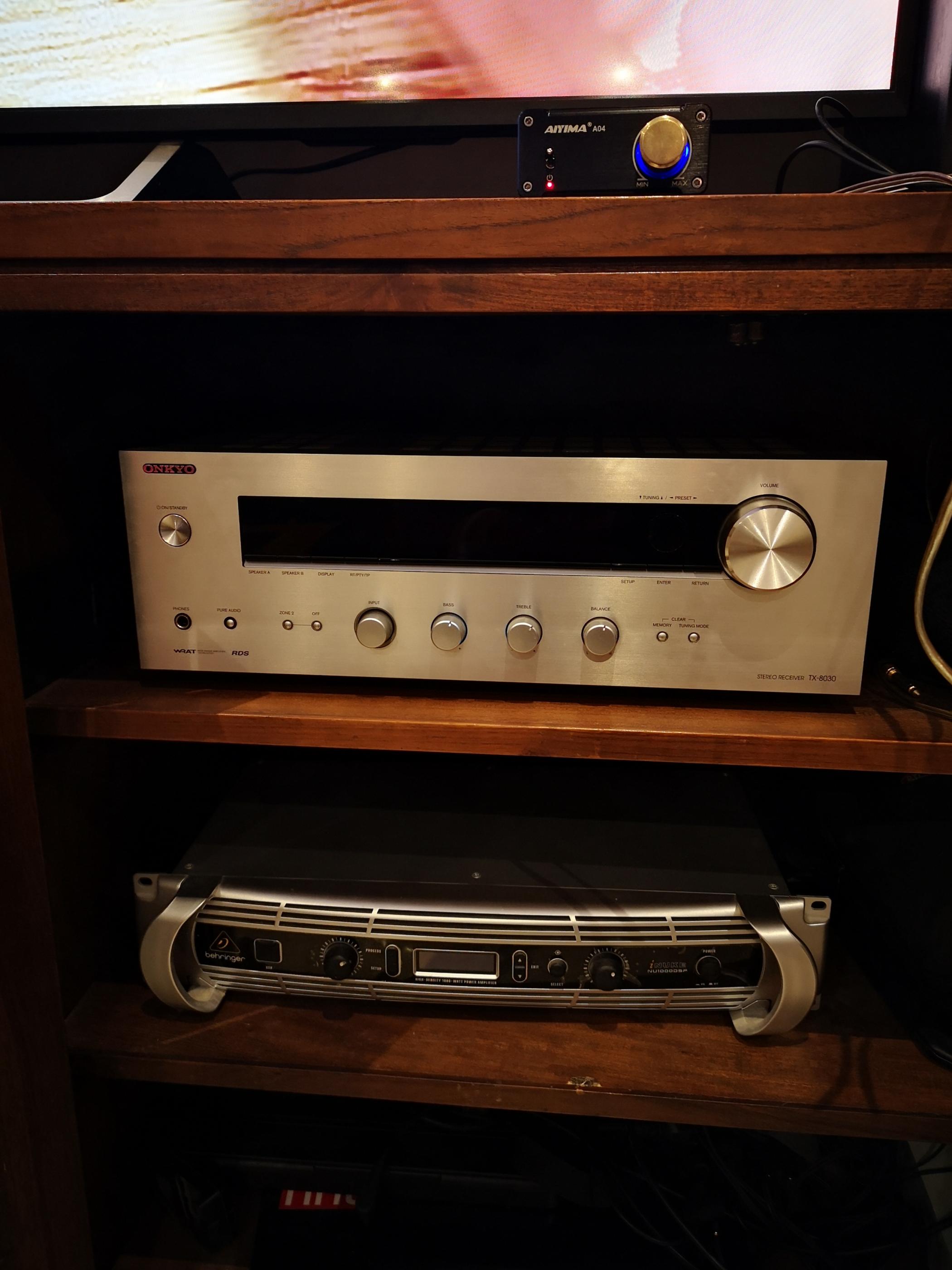

Looking at one of your previous photos, I guess you also on an Onkyo amp. Can you compare to it, tell us your feeling ?
Gilles.

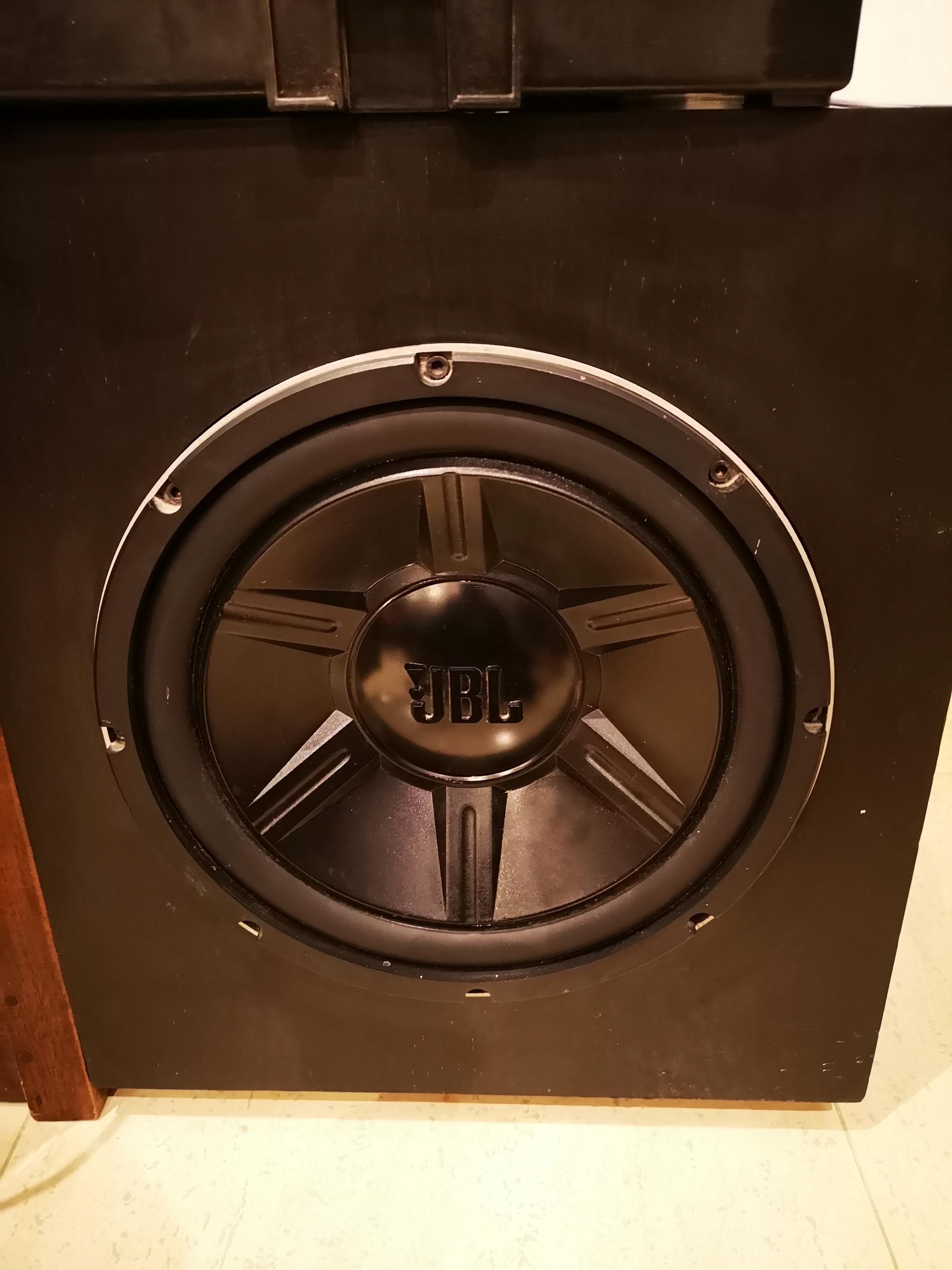

Something like 10 years ago I bought the living room setup. Reading in a national forum I discovered how to make and affordable but good sounding set up. Those speakers were very appreciated then because their sound quality and affordable price. They are not longer avaliable. The onkio drives the speakers. The 1000w berhinger power amp drives a 3cm solid sealed wood car woofer I did back in the time. I thought the sound was good but now I see the aiyima sounds much better. I can see now how good the speakers are. Not as good as many here but I'm not as deep submerged in audio.

Hi Gsusay,
I haven't read this whole thread, but what is the capacity of the Nichicon?
Connected to pins 4 and 8 (v- and v +)?
I imagine we must respect the polarity?!?
I bought those:
UKT1V100MDD1TD Nichicon | Mouser Espana
Producto: Audio Grade Electrolytic Capacitors
Estilo de terminación: Radial
Capacitancia: 10 uF
Voltaje máximo DC: 35 VDC
Temperatura operativa máxima: + 105 C
Diámetro: 5 mm
Espaciado del plomo: 2 mm
Longitud: 11 mm
Careful as my opa adapter is not facing the same way as the ones here so be sure how to install it, although in my case, the cap goes in the same pins
Let me know if i can help you further
If I understand correctly, the negative of the capacitor on pin 4 and the positive side on pin 8, is that correct?
In our case both are 10uF and one is lytic, the other X7R.
To answer your question, the differences were in sound, clearly all tech and values combos didn't sound the same.
Please use the search function: we posted already in details on that regarding how much bypass (values up to 30uF), what caps tech etc.
The only thing that remained a constant and stable and added values regardless teh combo turned out to be the C0G 0.0082 Murata cap (that comes as addition in our case). Obviously having 2 identical amps and being able to compare simple add-ons /bypasses on the fly with our biwired LS was a plus that helped us determining what to go for regarding the 3rd amp we built. And to stetle the final specs of the 2 amps we tweaked, going for biamping
At the end we picked up what we liked most from a pure sonic POV, as fine tuning as all other mods were done. All in our humble opinion.
