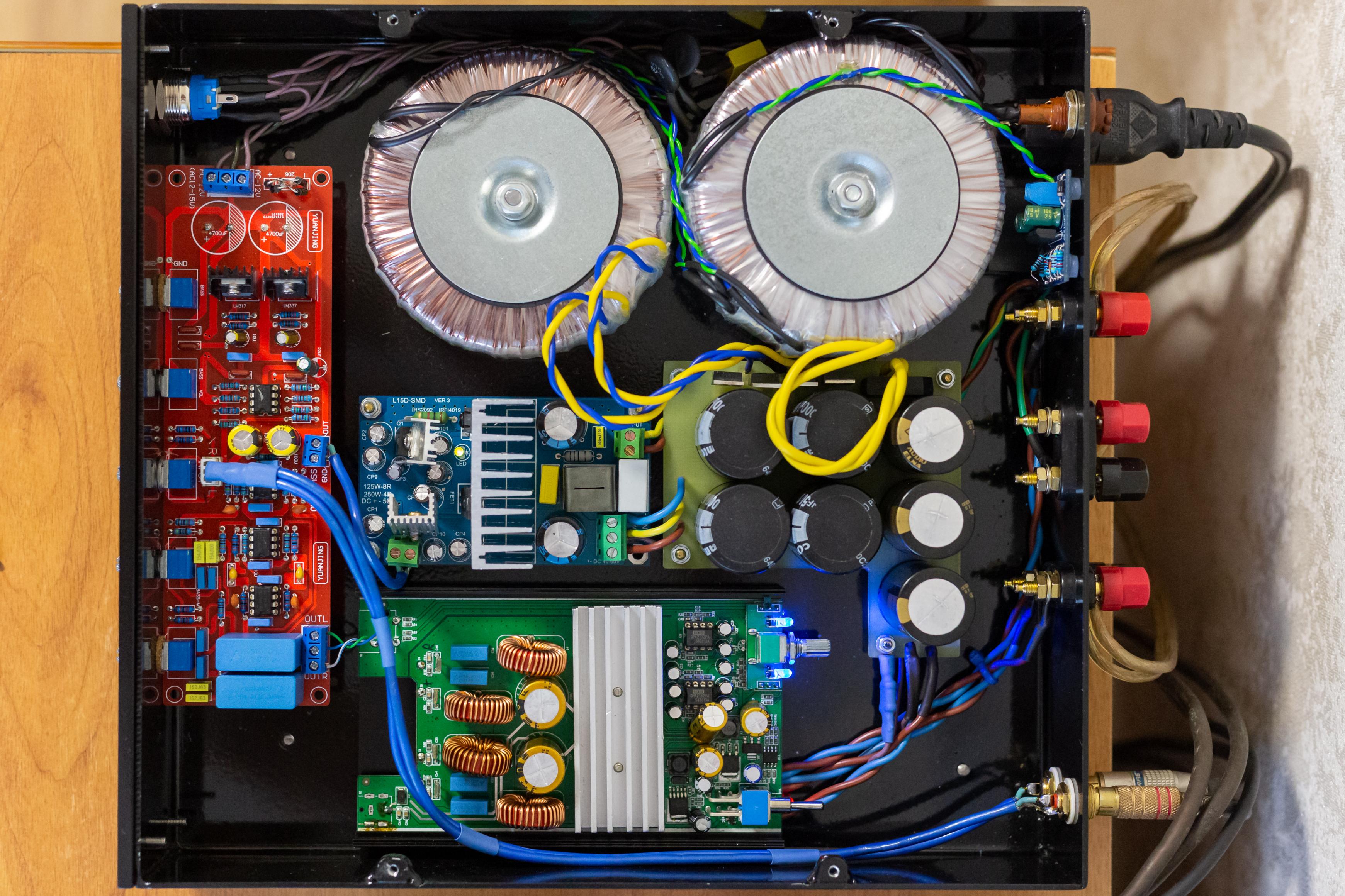

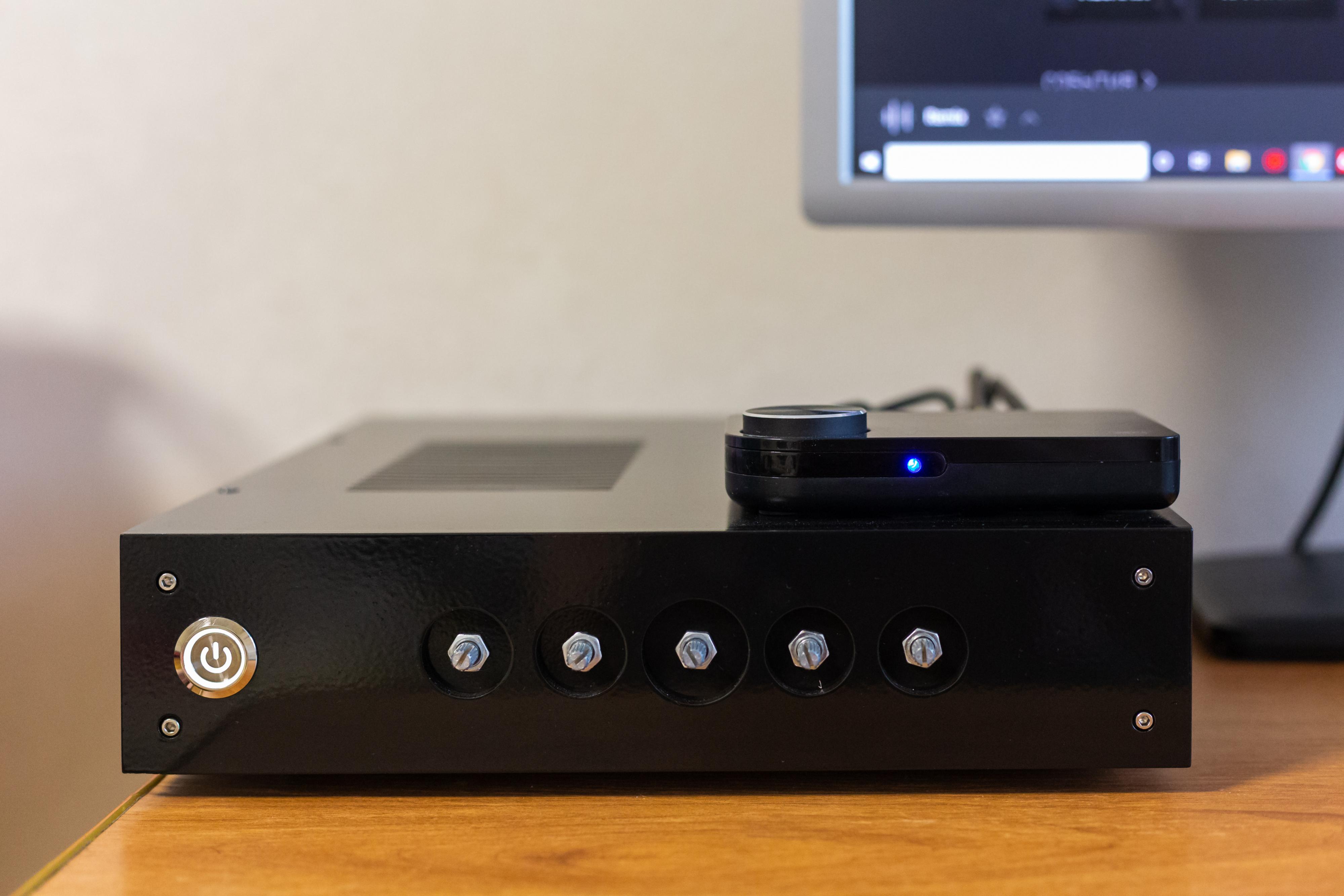

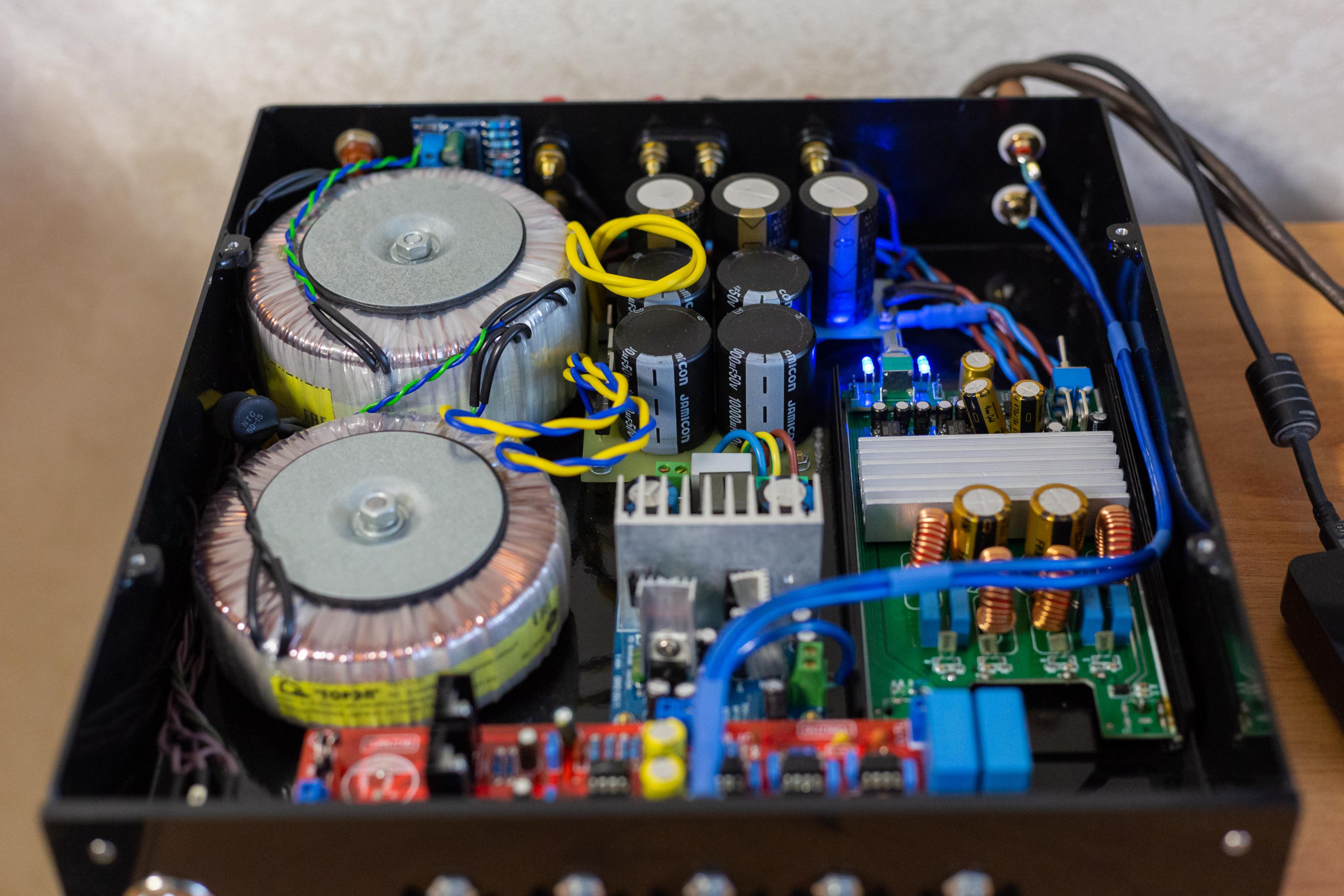

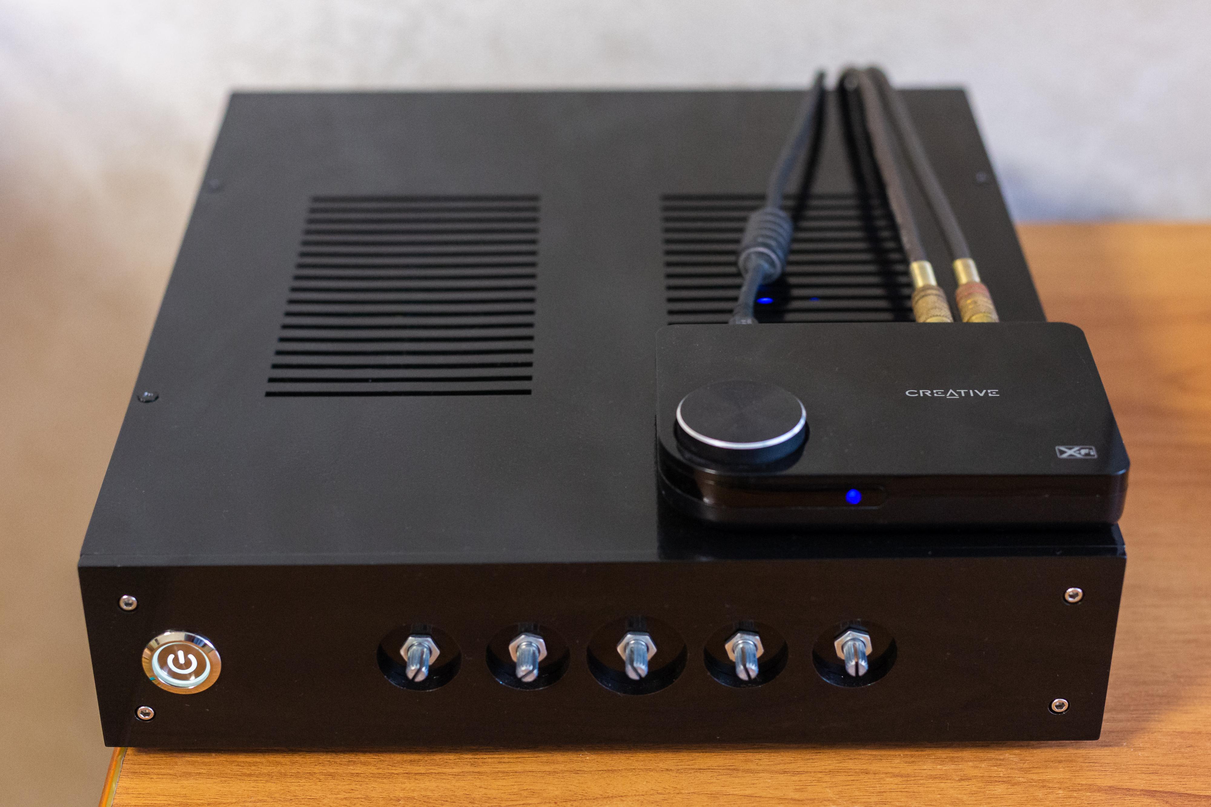

Thank you ! Nothing supernatural you know. With Claude, we decided to go for horizontal bi-amping. Both amps are tweaked as he described throughout this thread. Add some other external elements to drive them: filters, 'superpot', pot... And finally the assembly in the casing, with imagination, tricks, patience and care. DIY they said !

No, we didn't implement PO89ZB, these boards are different. Mark's SMPS filter is not suited for high current appications, and although we probably don't need a high current PS with the high efficiency speakers we currently run, especialy considering we have 2 filters (one in front of each poweramp), we decided to play safe and also future compatibility with other LS that may really need the power of the 2 Aiyima amps.
Therfore, we used a filter of my own. It is also a RLC filter, but only one stage instead of 2 in Mark's case, and twice the current rating of PO89ZB. Fc is also very different; much lower, to compensate somewhat for the single stage. Admittely L is also damped for its critical frequency, protection diode is in, so general layout is indeed very close to say one half of Mark's filter.
Gilles has 2 of these home made filters, on in front of each of his poweramp.

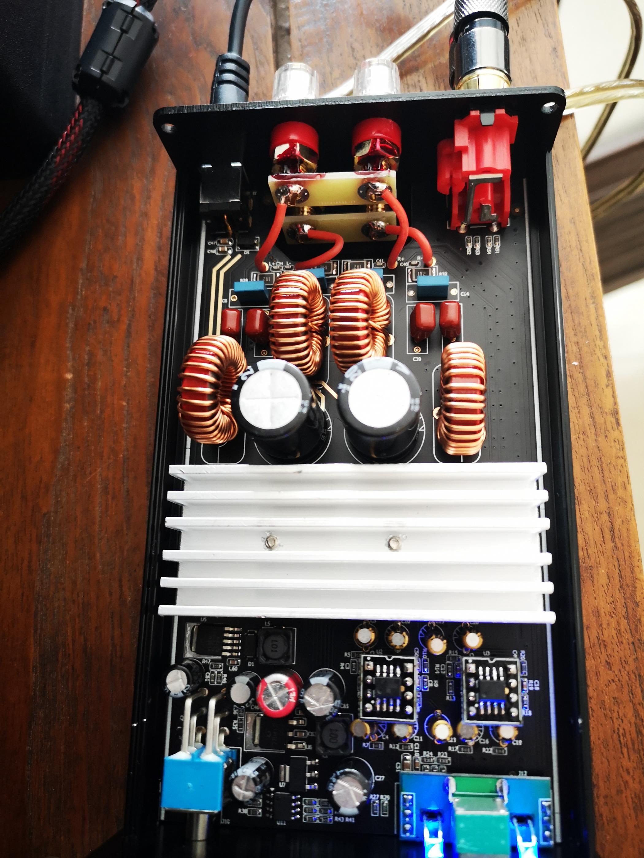

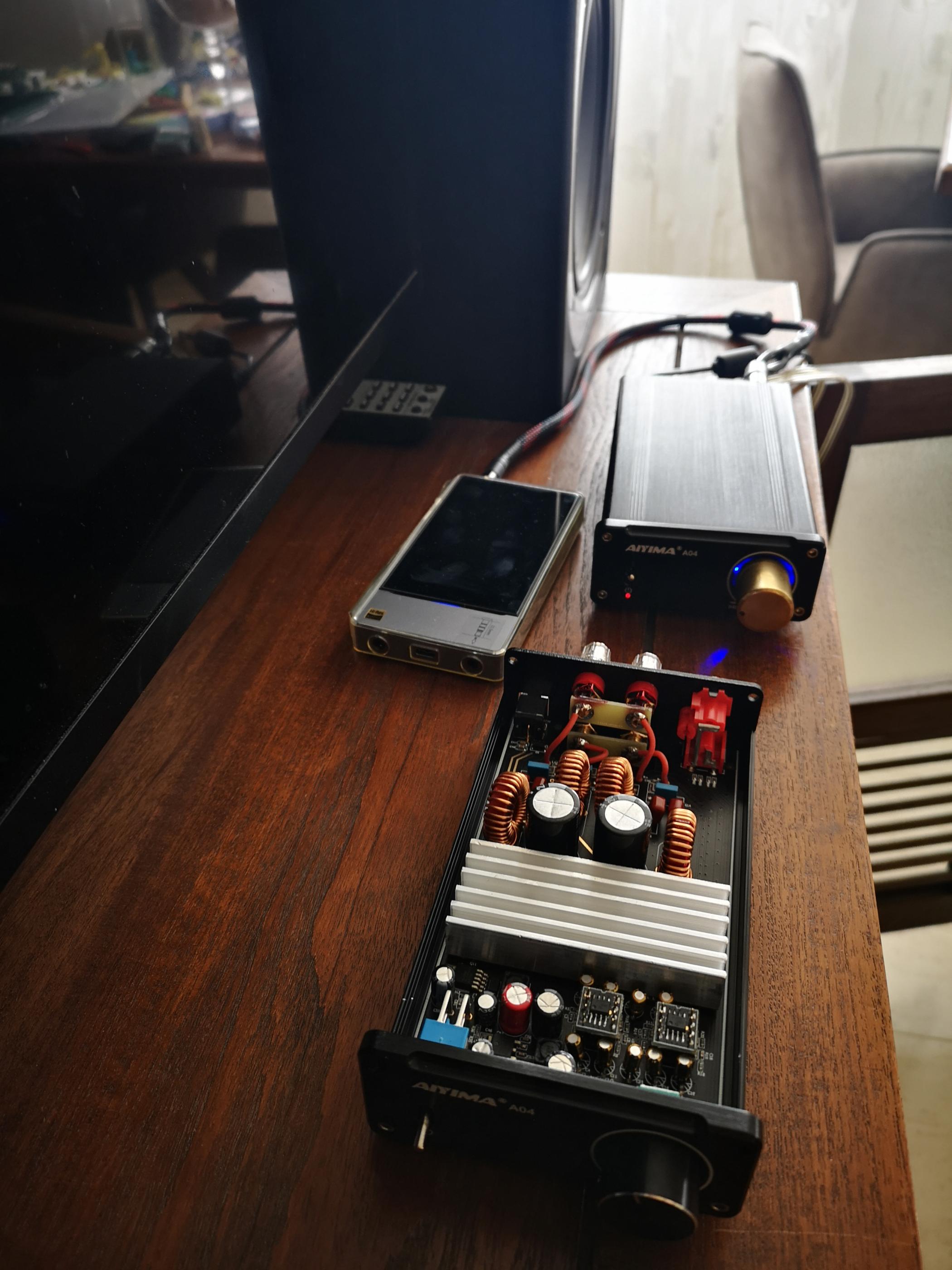

The latest project. Amplifier 2.1 class D. Front AIYIMA A04 TPA3251. Subwoofer L15D-SMD. It remains to buy potentiometer knobs.
wow thats amazing. is the a04 modified?
Thank you! Yes. Here's a description. https://www.diyaudio.com/forums/class-d/276982-tpa3251d2-194.html#post6449746
The OPA2132PA is already installed.

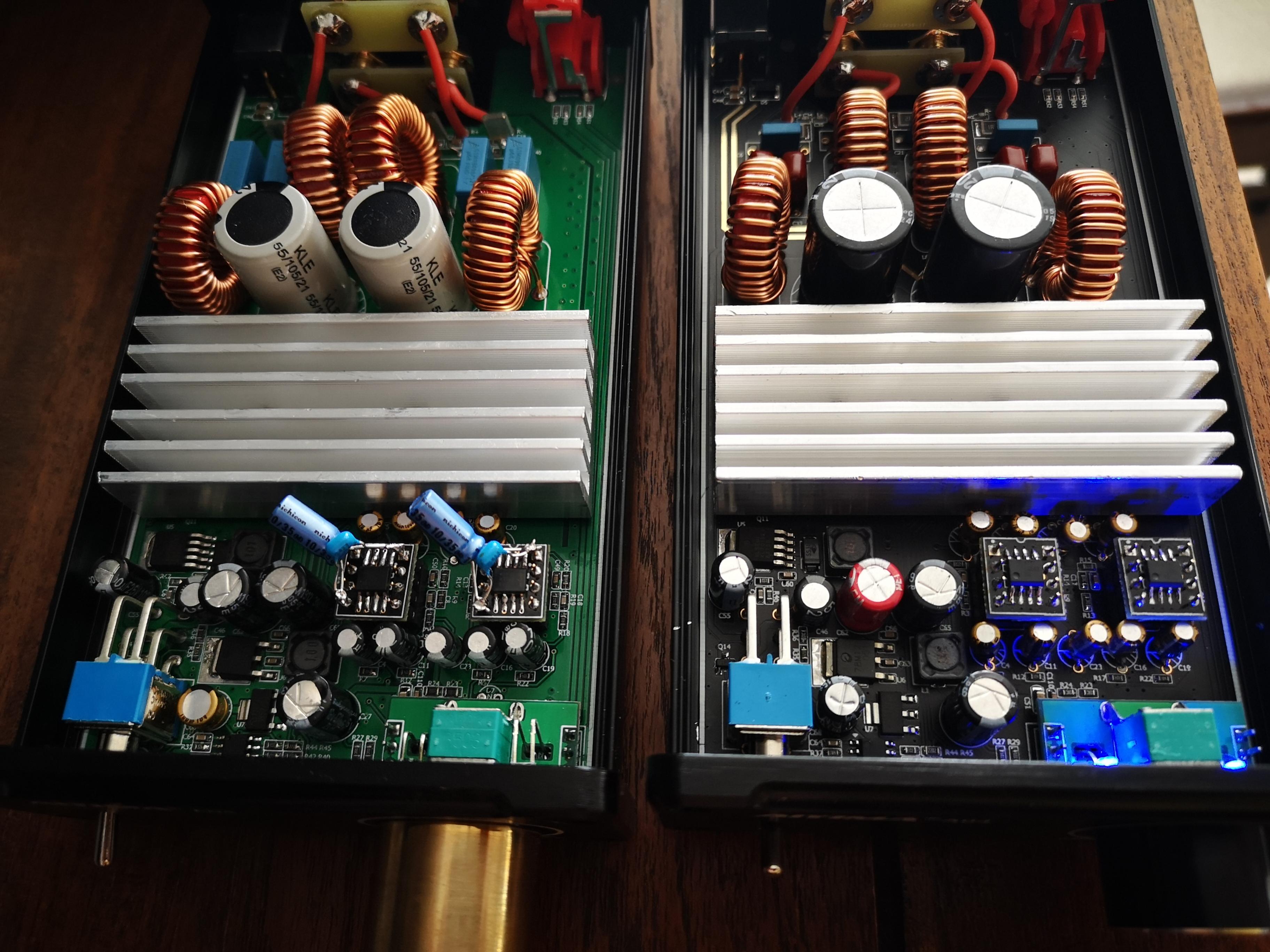

Hi guys.
I bought some time ago a second unit. This one is not as good. It hasn't the power the fist one has. I've took out the thermal bracket and there was paste on the pins. After cleaning it, it has more power but not as much as the first one I bought. There is a big difference is power.
What can be the difference? I have changed the opas. The sound is better but the power is the same.
I don't know what they might have changed during production, but the first thing is to dertermine whereas you are really down on power... or if it just gain sructure discussion (when the pot is in the same position, less volume, but that doesn't say you can't push it to max, it acts just as an offset so to speak off at your user level).
The 04 has with its AOPs in front of the power chip a balancing stage. It is not as recommended by TI's paper, as it also has a gain of 2 (and not 1). Perhaps they found out... That means different resistors and possibly getting rid of one cap, but I doubt they went that far in savings (?). If the "problem" is that, then you don't lose any max power unless you are playing the volume at max level and bottoming your pot, it is just the gain structure is different (and probably a tad better re sonics)
