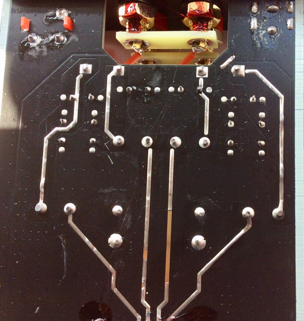

I have been playing about with cheap Chinese class d amps and modules during lockdown and recently acquired the Aiyima A04 revision 3.1 amp. Like others on this thread I have been a little dissappointed in its meagre output. Having read about Aiyima’s suggested resistor mods I opened up the casing to see how easy it would be for a complete novice like me to achieve. Looking at the underside of the board, build quality looks a little scruffy and there seems to be a damaged track (see attachment). Is this something I should be worried about? Thanks for any advice.
The solder on those traces isn’t “reducing resistance” — the most sensitive ohmmeter on the planet couldn’t measure a difference between that partially soldered trace before and after adding more solder on top of it.
The solder is there to prevent oxidation. I know this is an amateur hobbyist board but sometimes misstatements call for correction. No offense intended.
No drama, it will play music, but indeed the additional solder that is supposed to reduce the resistance isn't there as it should all the way.
Means not great, if you can add solder all the way as they did to correct where it is lacking.
Reduces resistance, gives bigger traces that can easier cope with more current / Amperes, reduces oxidation indeed as can be seen in the pix... call it what you want, I made it easy and the bottom line is "no harm to address it".
While at it, I find all traces really thin on this board considering what output power they claim, but well, I like it big

Yeah, not really, no. Debates are the lifeblood of amateur hobbyist forums, but this is not a debate, it is something professionals know not to be true and amateurs pass between them as “you have your truth and I have mine”. Well no, there is objective reality, and the objective, long-settled reality is that adding solder to an already-oxidizing trace on a board that left China months before you got it does not and can not reduce resistance, increase current capability, or reduce oxidation. If it makes you feel better because you “like it big” I recommend never telling this to an actual audio professional from whom you wish to be taken seriously.
One if the first things I learned as an apprentice engineer is that solder should never be used as a signal-carrying conductor. It is merely a fast-setting “glue” that holds in place a sound mechanical connection. Solder is conductive because it’s helpful to have contact points in a circuit to measure voltages when troubleshooting, not because solder is meant to be an actual signal carrier.
The second thing I learned is if you can easily pull apart a mechanical connection before you solder it, it is not ready to solder. Mechanical integrity — metal pressed tightly against metal — is the signal path. Solder is just there to make sure the metal-to-metal connection doesn’t separate over time due to vibration, heat, or a long and bumpy boat ride from China.
If your audio signal is passing through solder you’re doing this wrong.
