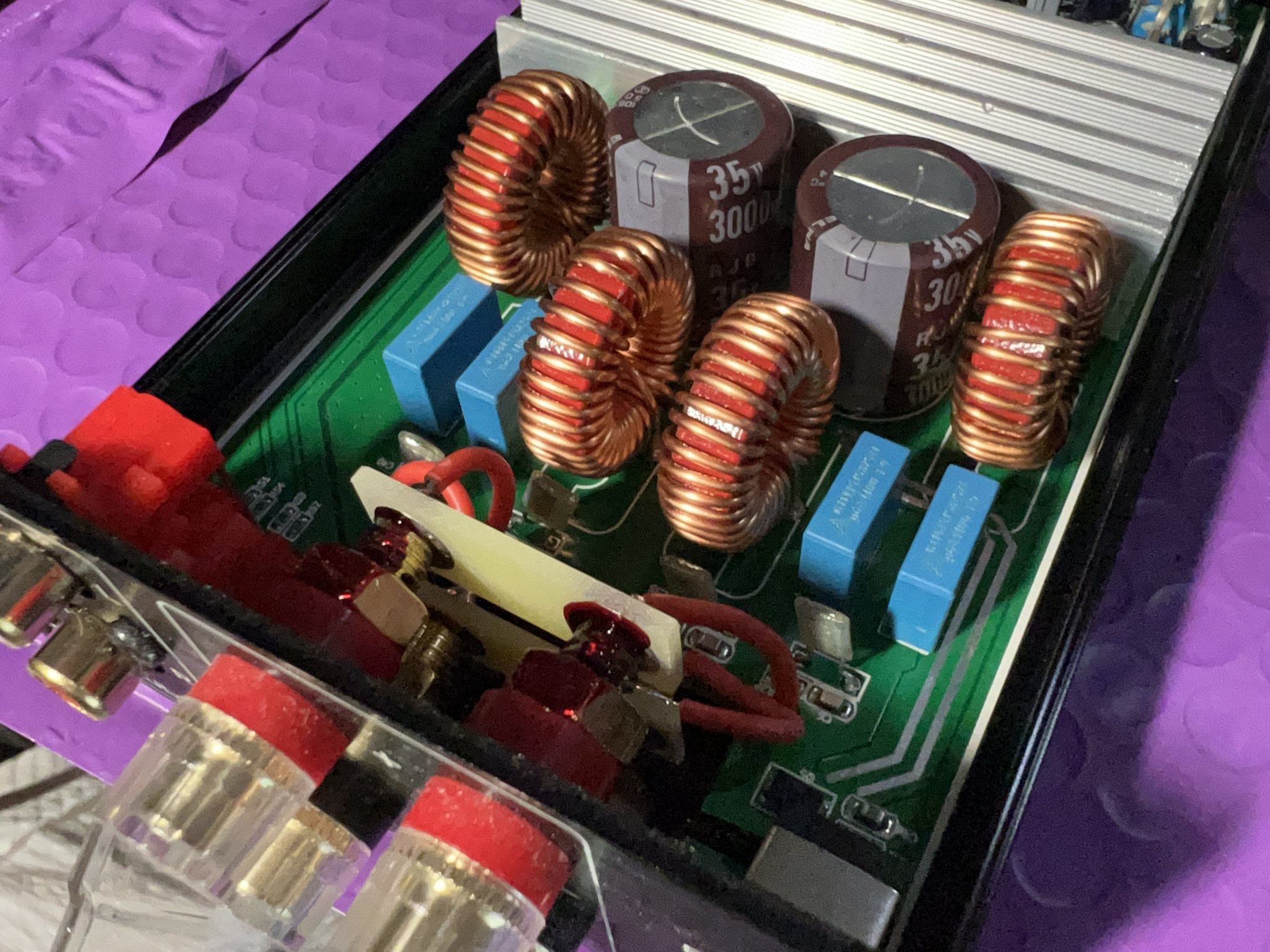

A question for the Braintrust on power: The stock 04 has 35V capacitors. Would it be a bad idea to use clean, 36 V power supply (Mean Well) to power a stock 04?
I looked at the TI datasheet and see that the VDD for the TP3251 is 38 volts and Typical voltage is 36.
Based on the charts, it seems the amp gains significant power over a 24V supply.
Thoughts?
I own the A04 with the black Tilear pcb (with Elna audio grade caps). I use a 36v / 6A PSU without any issue. You need to make sure the main power caps can support this load.
If I am not wrong the last A04 (green pcb) have some 35V /2200uf power caps.... You can update it easily ex : 50V / 3300uf (make sure to get the right size the case is small)
Get a 36V Meanwell (slightly) adjustable SMPS, the ones that come in a cage like look, as found in computers, and adjust down to 34V or so if you really want that high voltage.
Whereas indeed most 35V rated caps can tolerate a bit more voltage, say very slightly more, I wouldn't advise running higher than 35V as this is a hit and miss - not mentioning that we don't know what caps are now fitted inside these units, so what might have worked a certain time for one person might not be the rule for another. Further, if you run higher than 35V, than it is constantly higher than 35V as regulated PS and so life span of the caps will be shorter, and there is nothing really to be gained re power to the speakers if you do the calculation as it translates into marginal dB gains at your ears.
As already mentioned above, a safe path is to uprate all the relevant caps to 50V... but then you might question why running 35V?
I were you, I would even go for a slightly adjustable MeanWell 24V SMPS... these can be adjusted up to 29V, still more than enough voltage, deliver far more amperes if needed, or rather in our case cost less with the same ampere rating... and have far better ripple values, which matters probably the most re sound. That's what we did on Gilles 2 amps.

Thanks, Gents.
I may need to tin my soldering iron and make some mods.
Best wishes to you, as well, for a Merry Christmas et Joyeux Noël!
