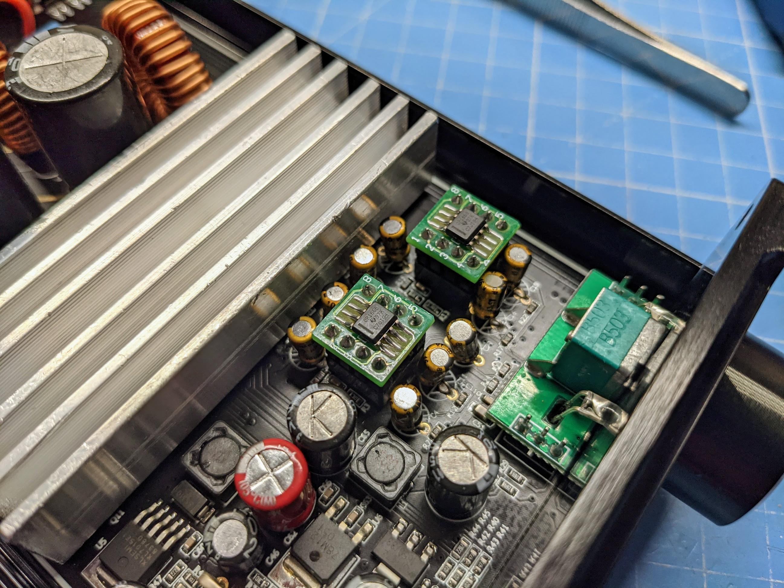

I did try to swap the NE5532 opamps for LM4562NA but on power up the amp went into error mode (flashing power light, no sound). Swapped back to NE5532 and all was fine again. The LM4562NA could have been defective, though I sourced them from from a well established UK Ebay trader with good feedback. I don’t have any way to test them.

Dropped in some OPA1656 from James, did a fresh REW calibration & I'm very happy!

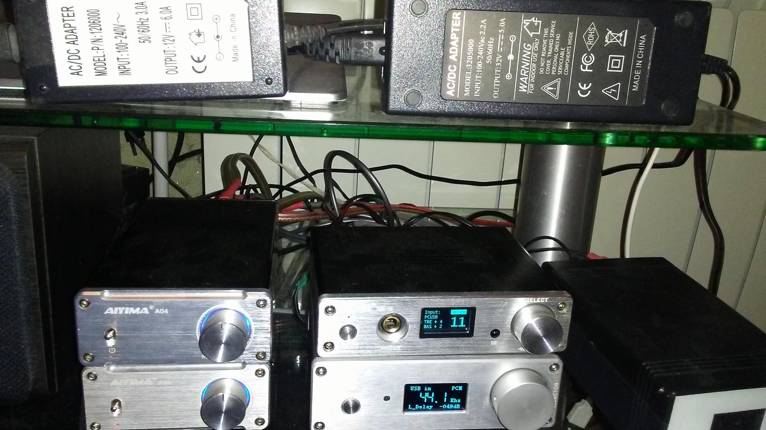

Nice speakersDo you know if I can power Aiyima 04 with 12v 2A adapter? I m thinking to get this one over 07. Im going to pair with some small 4" maybe 5" speakers and i listen quiet i think . I had an active speakers and once I measured how much power they draw on Digital power meter (10$) it shows around 1-1,5W usual and when i cranked it up it peaked at 5-6W max and that was enough for me
TPA3251 performance is correlated to voltage. Seems a shame to buy a TPA3251 and then pair it with a 12v power supply. I think the typical 19v laptop power supply would be more suitable.

Yep, 12V means you are really running low and 8R speakers will struggle, 4R less so, but obviously in both cases your max power will be limited.
Further, per spec the chip doesn't want to see less than 12V... using 12V PS means you are likely to have a bit less at the chip pins and possibly problems.
It is just me of course, but I don't see the point of using a 12V PS, eventhough you need very few power. Especialy given the low price of SMPS, you really want a bit more voltage (and a few amperes). Not saying it wouldn't work at all, biut obviously no ideal conditions

I just found 12V 4,17A power adapter and thats 50W of power and I will see in couple of days if this is enough to run 6ohms speakers.
