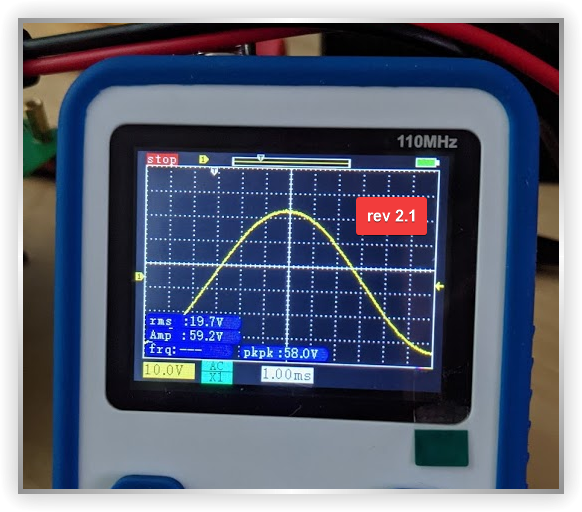

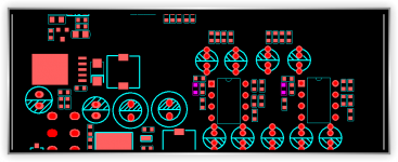

i too have the new board, they are now shipping the rev 3.1 board (hidden under the larger heatsink) vs the rev 2.1 board that got so much praise. i have the black rev 2.1, so i have a good one to compare both units
this is what i've found
i have (2) 4.5ohm zister 20w resistors that i ran in series for a 9ohm load. with 2.06Vrms (0dB on the E30 DAC, -3dBFS@80hz from REW)
on the rev 3.1 board, i'm getting 12.8Vrms output
on the rev 2.1 board, same setup, i'm getting about 21.4Vrms before i start to clip. note the volume knob is about 60% when this happens. as i push higher, the signal begins to clip and get choppy, and any higher than about 24-25Vrms, i hit some sort of limiter and it shuts down
to get the max input sensitivity, on the rev 2.1 board, i maxed the volume on the amp, put E30 to -25dB, and pushed the volume up on the DAC until i hit 21.4V which occurred at -10.5dB on the DAC which measures 0.608Vrms of line output
since i have no way to get greater than 2Vrms of line output, i cannot get the required line voltage it to max the rev 3.1
so it appears that in order to get max output from the A04:
rev 2.1 = 0.608V line input
rev 3.1 = unknown, >2V however
so they changed something in the gain structure or the PFFB

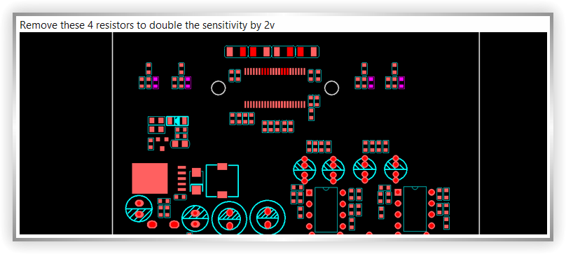

when i reached out to aiyima, this was their response
attachment.php

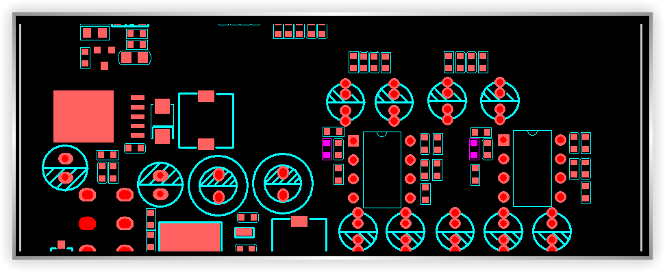

they also said "If two removed resistors are replaced in this position, the sensitivity will increase again by 1.8 times" with this picture
attachment.php
i have yet to attempt these modifications, nor do i know which one i should do: remove the 4, or adjust the 2
i'd likely start by removing the 4 since they never gave me the new resistor values for the second suggestion they sent
so it appears people have two options. have a DAC that outputs more than 2Vrms (which i'm not aware of many that do), or make these mods to get their power back
rev 3.1 getting 40W@4ohm and 19W@8ohm (12.8Vrms)

This has been discussed before, search posts with gain structure and what happens at the balancing x2 gain preamp section around the OPAs.
Shouldn't be a prob though for most people unless very unsensitive LS or low source output, cold be better for sound (slightly if ever).
More worried by the fact that if they moved to unitary gain in the preamp section that means a cap is no more needed, so they probably removed it. If changing the gain back to x2 you need that cap back in foreach channel, so 2 caps if they aren't there anymore. You would find out: no music playing otherwise, but no real danger short term.

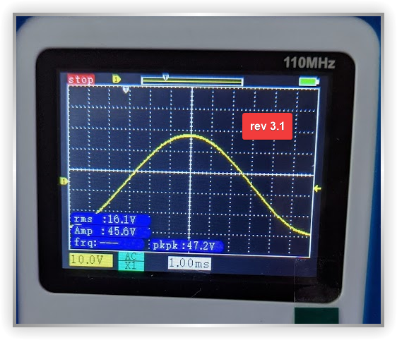

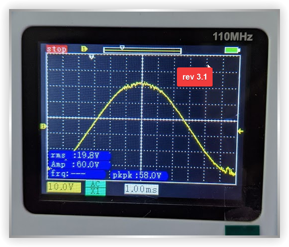

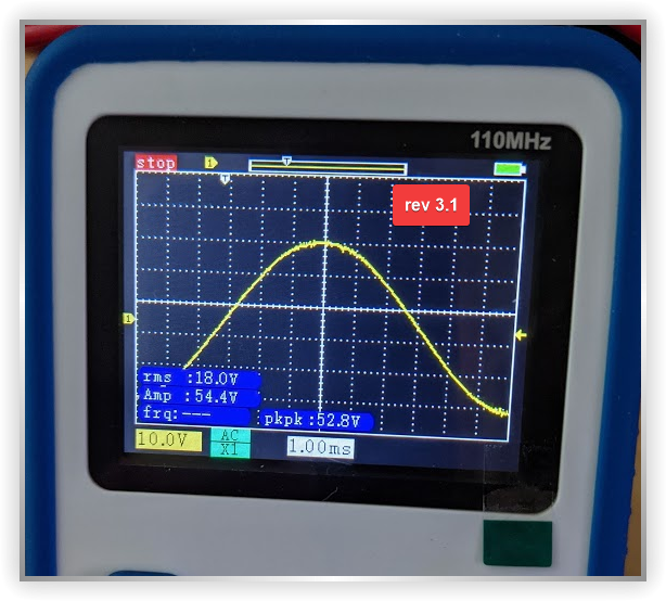

i went ahead and removed the 4 resistors as indicated by aiyimas first suggestion
i'm now getting 16.1-17Vrms of CLEAN output (depending on how nit pity you want to get)
from 17 to 20.4Vrms the top of the waveform gets a little wiggly as we hit clipping right about 20.8Vrms (identical to the rev 2.1 board)
so a nice improvement
so we went from 12.8Vrms with 2Vrms input (unable to clip with most DACs) ~20W@8ohm
to
17Vrms ~36W@8ohm of clean power, only requiring 1.1Vrms input, which most if not all DACs can achieve!
pushing it, you can go to 20.4Vrms ~55W@8ohm with 1.35Vrms input, which again, is achievable by most if not all DACs before things head to clipping
now, the rev 2.1 board stays clean the entire way to clipping to 20.8Vrms, so the rev 2.1 board is still superior for sure
provided some pics of the upper end of each of them
