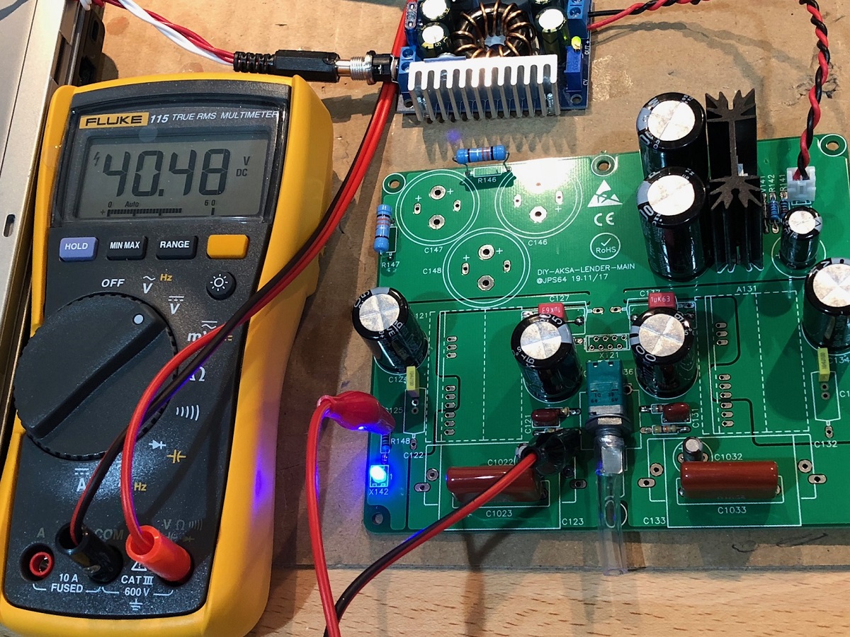

I just built up the MB and the Vcc power rail test was successful. I am missing some electrolytic caps for the CRCRC but otherwise everything went together pretty easily. I wish the input and output bypass film caps allowed 5mm pitch Wima MKS because I have bags of those. I had to bend the pins 90deg and "surface mount" them on the outputs. Otherwise, and excellent layout. Of course, if you bought the items in the BOM, they would all fit. This test build is using strictly stuff I have on my bench without ordering anything. The signal input/output connector is something I don't have at present, but the wiring configuration is easy to understand: inputs on the two inside pins and corresponding outputs to the outside pins in the lower row, the top row are all GND. I am using an RK09 Alps pot from my pocket amp and attached a short piece of vinyl tubing to allow the shaft to be operated from the front.
Here is a 44.5v DC step up putting out about 40.5v after the cap Mx and CRCRC. I am using a non-ideal 470uF cap on the cap Mx so the slow ramp up takes about 60 seconds to reach full voltage. That's actually nice from standpoint of preventing thumps and other transients. 220uF or 100uF would be fine. One thing is for sure, this PSU will be dead quiet with a flat noise background down at the measurement limit. I have typically seen -130dB and flat.
attachment.php
So I will build up the amp core daughterboards next when I have some more time. All for now...

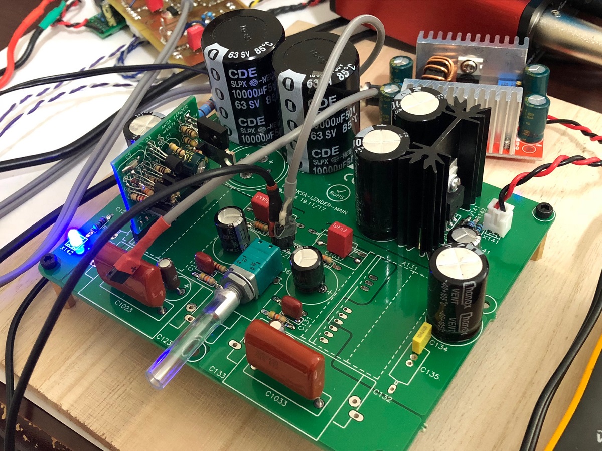

GB MB & TH PCBs are Singing

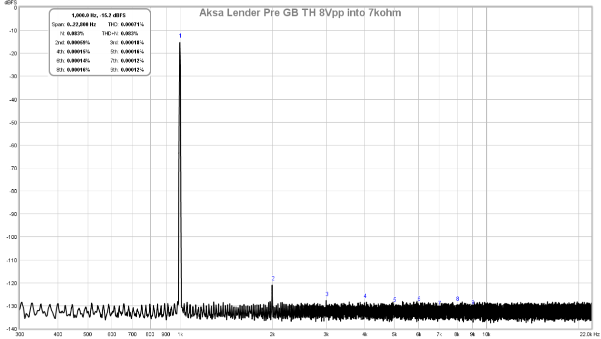

I built up the TH daughterboard using a 12k carbon film feedback resistor and 10R LTP degeneration resistors. Using a BSP129 in place of DN2540. Only one channel built so far. This is with 45V Vcc.
attachment.php

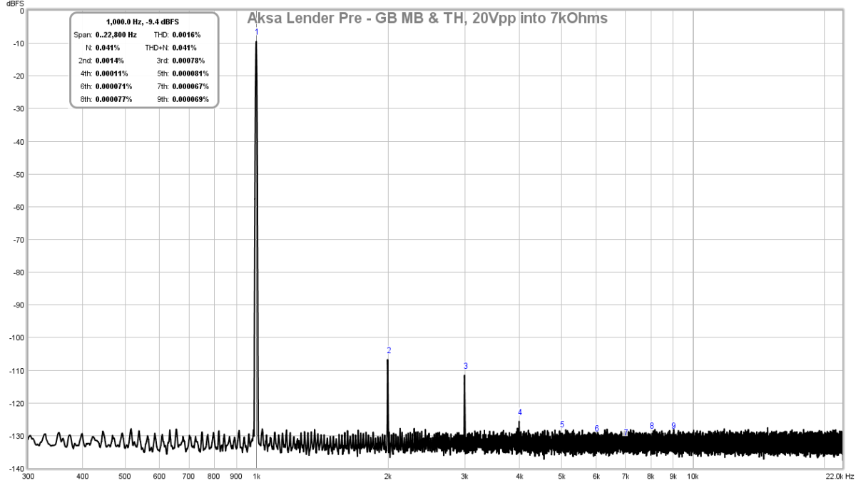

FFT for 8Vpp into 7kohms (THD is 0.00071%):
attachment.php
FFT for 20Vpp into 7kohms (THD is 0.0016%):
attachment.php
If you increase Vcc to 48V, you get THD of 0.0001%, but H2 and H3 become closer together. R9 is currently 100k, reducing that to 68k will increase H2 relative to H3.

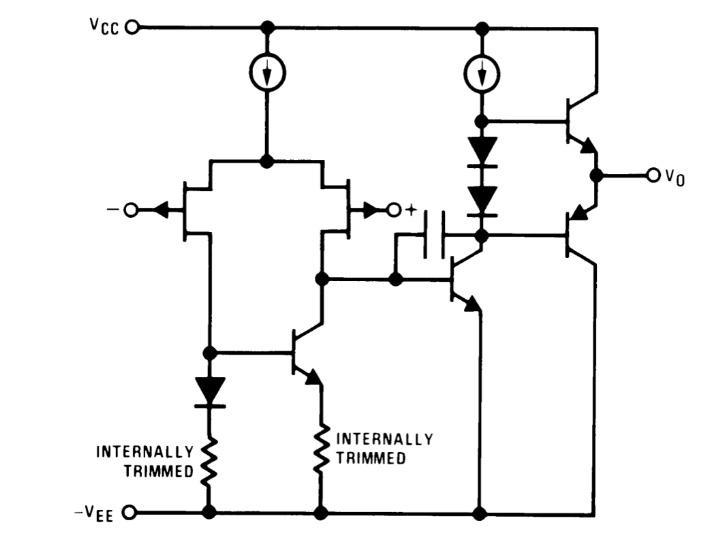

Performance is very similar to Lf353, 351. One of the best op amps ever made
Hmm... the topology is sort of similar on the LTP with diode but JFET Input, NPN on the right LTP leg but wired differently. Also has a push pull output stage vs SE Class A output on this one. LF353 spec says THD is 0.02% - quite a bit higher than his amp.
attachment.php
