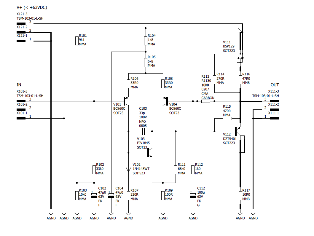

We found an error on the silkscreen for the SMT daughterboard. R102 and R103 are swapped. Here is the correct schematic to use for populating. V2 in PNG below and also PDF attached:
attachment.php
  • DIY_AKSA-LENDER-PRE_SMD_SCH_V2.pdf

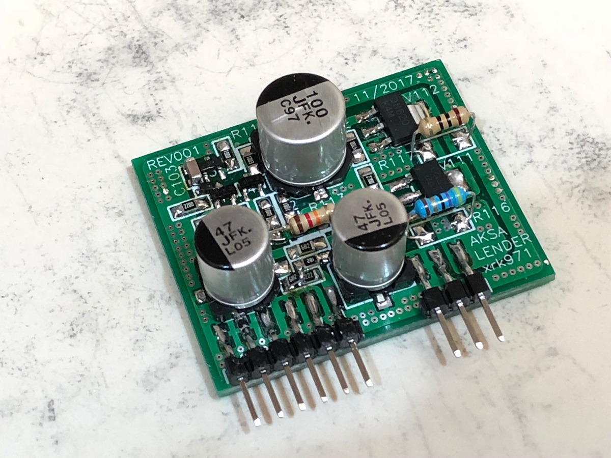

GB SMT Board Tested

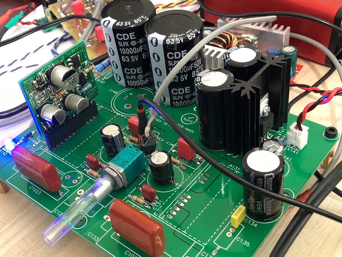

I have verified that the SMT daughterboard works. I was able to get 0805 chip resistors to work with a lot of manual soldering to add enough solder to span the gap between the pads and the resistor. The 0805/1206 version will work a lot better. I used axial 1/4w resistors for the real big ones with bent leads. That was also handy to allow alligator clips on the 10R to verify bias current. On this particular unit, I am measuring 18mA bias at 45.4v Vcc. The mid-point output tie-point is exactly at 24.0v with a 9.0k resistor formed from a 6k8+2k2 chip resistor in a rooftop arrangement at R101. One thing to note is to use a very high quality 33pF NP0 capacitor. I used a lower grade NP0 and got higher distortion at high frequencies. I replaced it with a 2kV rated 33pF NP0 and distortion went back down to normal.
attachment.php
Closeup (note that R102 and R103 silk screen labels are reversed if using old schematic, updated schematic V2 is correct):

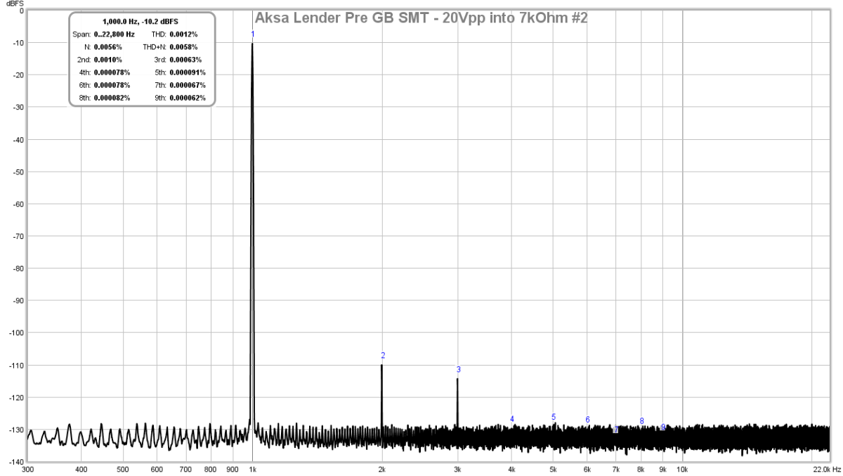

FFT shows THD is a tad higher than TH version, and this may be result of changes in actives (SMT equivalents are slightly different), plus using DZT5401 vs KSA1381 on the output. Also, the TH predominantly used carbon film throughout except for 47R 1% used to set bias current.
Here is FFT for 20Vpp, THD at 0.0012% and similar H2/H3 relative profile compared to TH version:

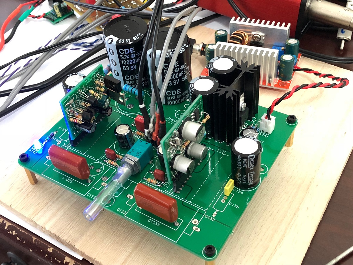

Listening to it now - sounds great.
I think we are ready to ship GB sets as all key functionality is verified. I have not verified the input selector switch or the CLC. But if using DC-DC step up, it has its own built in CLC used to block the switching frequency. In some countries (Germany for example), I have heard mains are very dirty and CLC is mandatory.

Playing in Stereo Now
Sounds very nice feeding a headphone amp. No noise, hiss, hum. Volume works butter smooth with no scratching noises - just even variation in volume of sound. I added a 6k8 3W CRC capacitor bleed-off resistor where the third cap of the CRCRC would go - 3rd cap not needed on my setup based on measurements with two 10mF CRC caps. Feel free to use third cap though with smaller 4700uF's etc.
