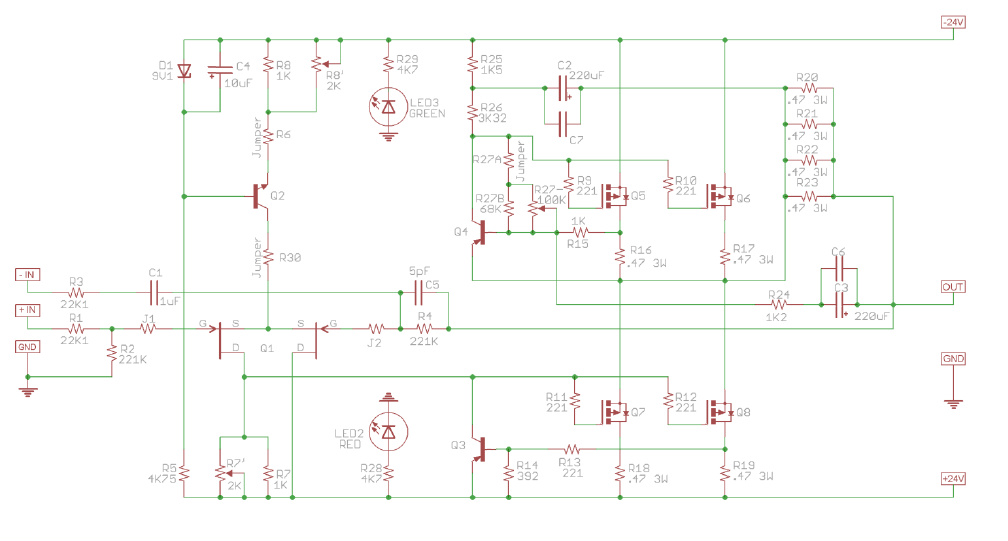

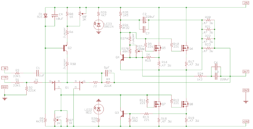

ZM, after researching a bit, I understand the difficulty of explaining issues with my previous idea... Too many things wrong with the whole idea. So following previous solutions and Papa Pass's Sage advice... I inverted the whole thing with the intent of using IRFP9240 outputs. One thing I was confused on is whether inverting C2 and C3 polarity is correct (Not an issue with film caps, but I want it to look correct).
I noticed the symbol for the IRFP9240 was messed up, so I fixed that, and I removed the polarity for the negative feedback path after reading that some people use bipolar caps there with no issues.

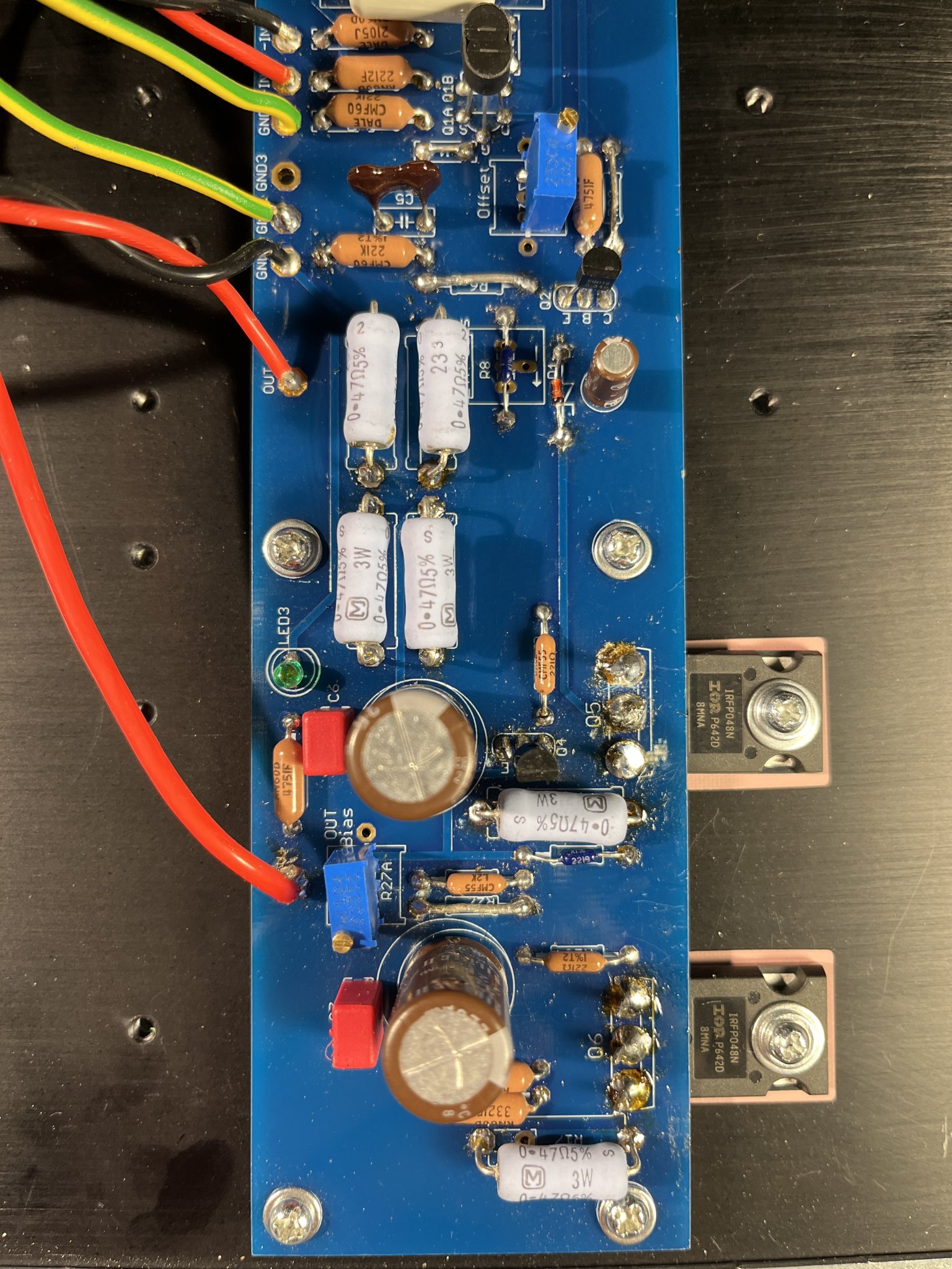

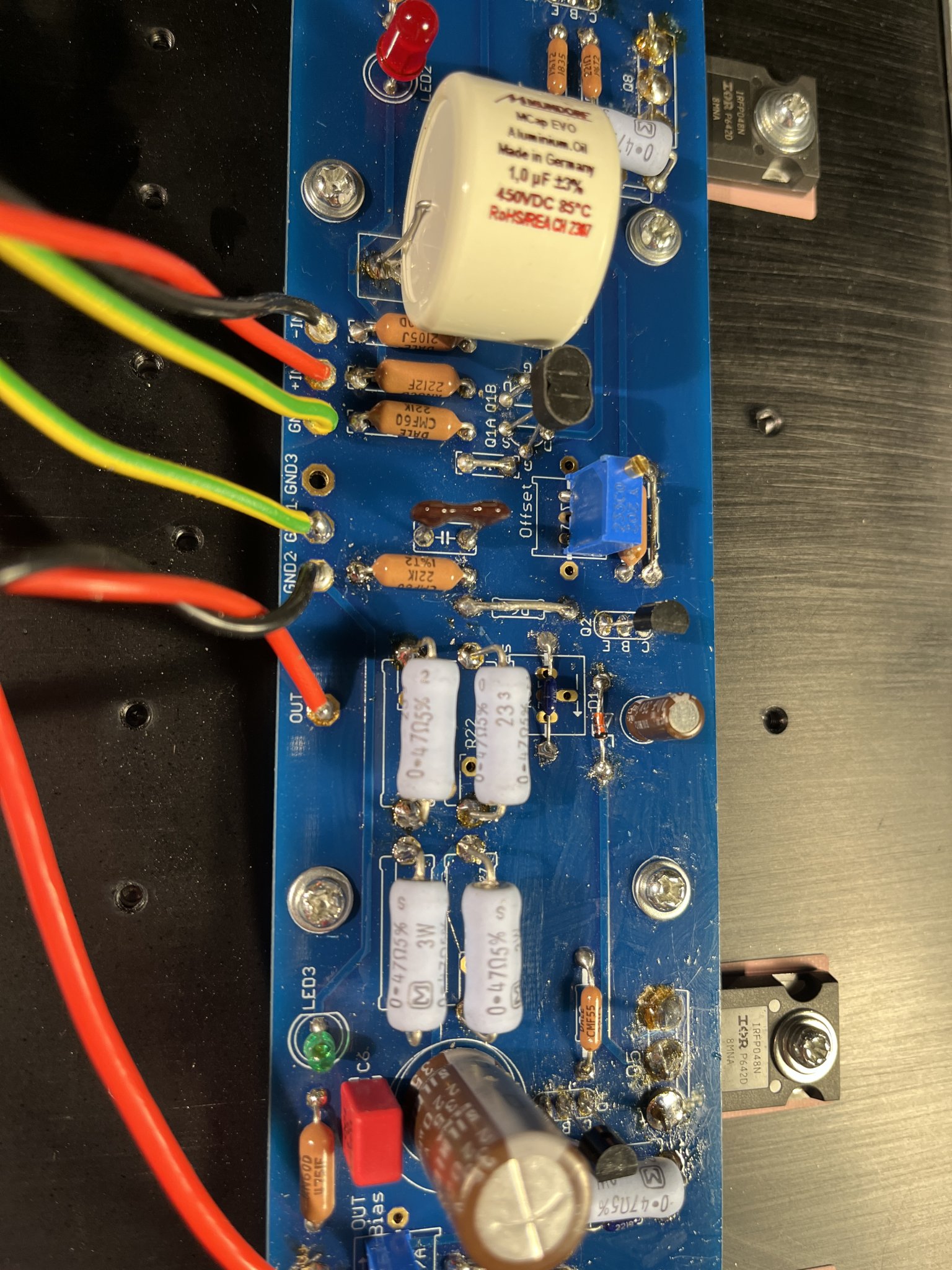

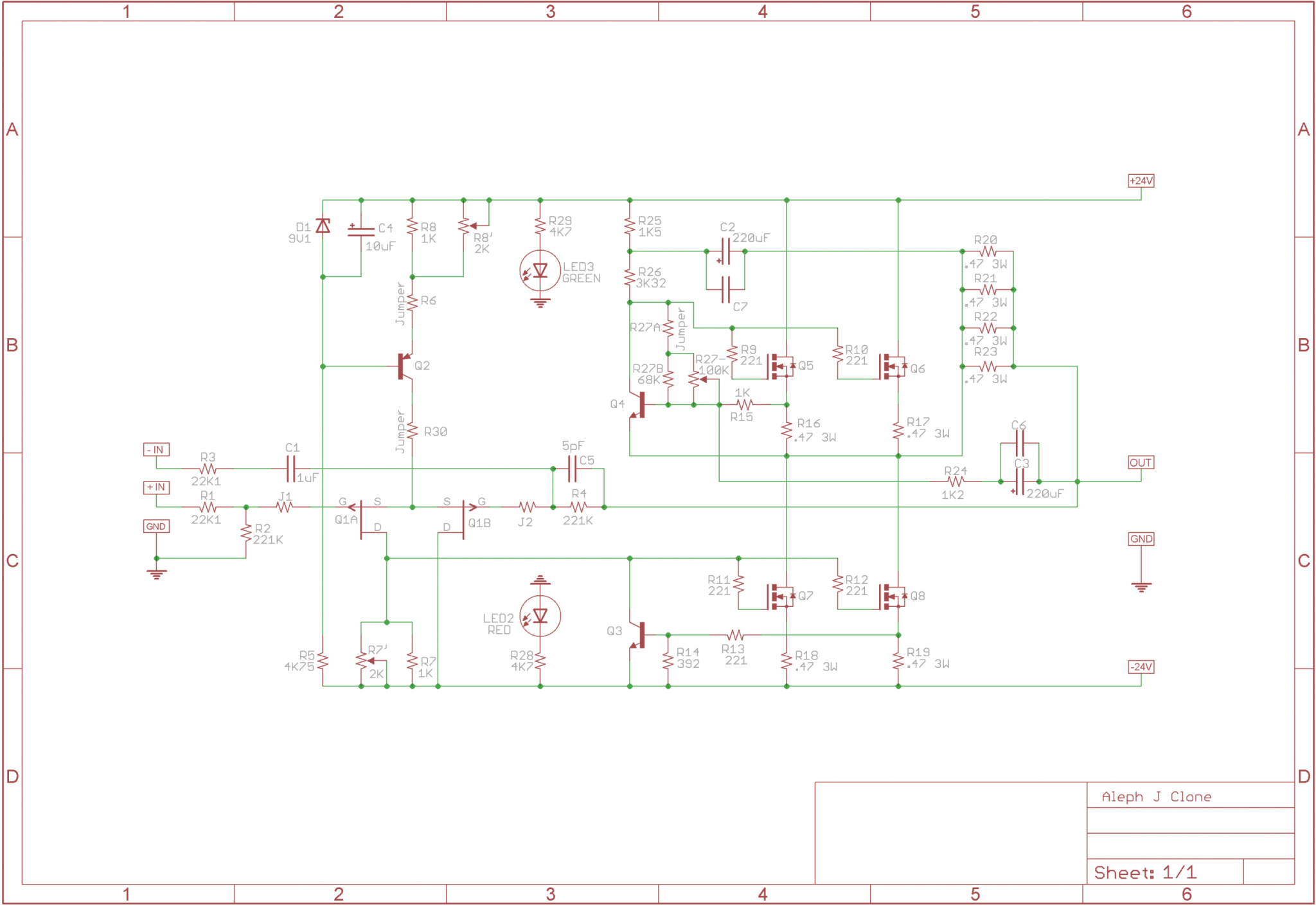

Hello everyone! I've been struggling with one channel on my Aleph J build.
I must have messed something up in the initial testing, and now I can only get 7.85v at R8 and 0v at R18.
I did manage to toast a few of the 0.47 resistors by turning the potentiometers, but I changed them all out and also got a new jfet+mosfet kit from the diyaudiostore, just in case they got burned too. Desoldered and measured components again, reset the potentiometers. Still 7.85v at R8.
I can't figure out what's wrong. Any suggestions? Thanks!

Thank you for your quick reply, Anand!
I have a working power supply, thankfully. I used the schematic from the first post in this thread and followed this build guide: https://diyalephj.blogspot.com/
My boards look a mess from all the desoldering and resoldering, but here they are.

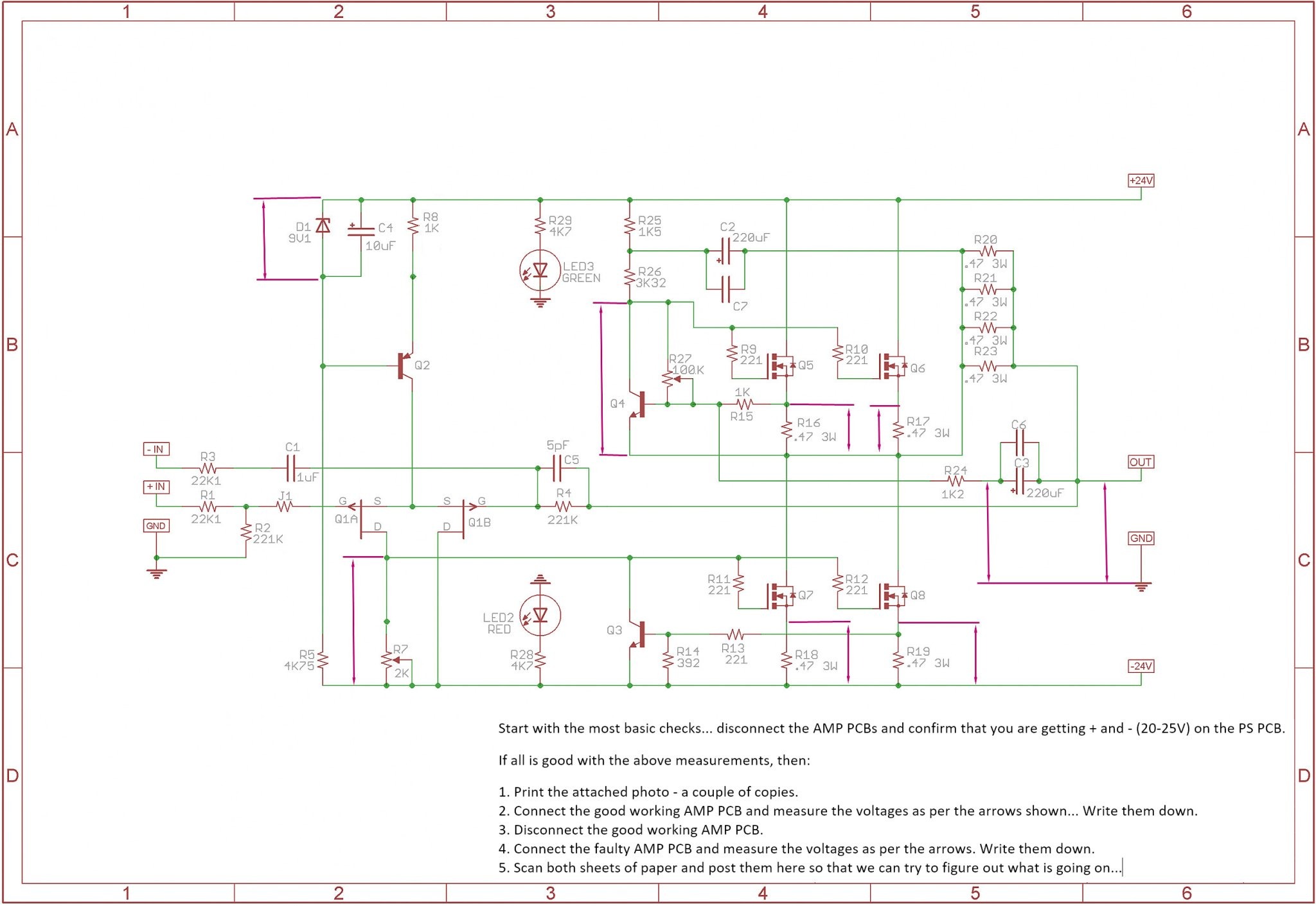

Check the attached; I removed the jumpers and R7 & R8' from the schematics to avoid confusion .... Read the instructions in the bottom right corner. Post the measured voltages.
If R18 reads zero, you don't have 4V across R7 (and/or the Q5 is not conducting)
  • make sure your R7 trim pot is working correctly and soldered properly; and that it makes contact with the PCB. Check and confirm that R8 is 1K and that it makes contact with the PCB
  • If R18 is still zero, the JFETs are most likely bad because there's no current through R8, so replace the JFETs.
  • confirm Q2 is the correct part, soldered the correct way
But... the bottom line is:
The best way to go about this problem is to take the measurements first, as per my instructions in the jpg I attached.... before you start replacing the expensive JFETs/MOSFETs. Post the results here and we'll have a look.
