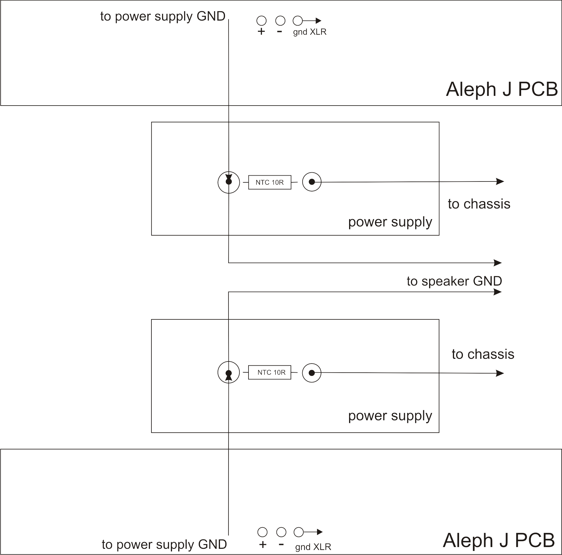

just a quick question, does you're Aleph J produce any hum when its not connected to a pre-amp/buffer or some other kine of equiptment?

ps. without any drawings....... i connected the ground of the inputs to GND3 instead of the GND next to the +in and -in, does this cause any problems?
In my recent Aleph J build I’ve connected signal ground to main board… I’ve did that several times without problems… Always “dead silence”….If you have dual mono in a single chassis then a thermistor per channel is a good idea.
You should also have input signal ground going to star ground. I think that's what you have shown but need to confirm it.
Tony
I do have a dual mono setup attached to one power supply (diyaudio power supply).
I attached the PSU with one thermister to the chassis with a bolt on that same bolt i wired the savety earth.
thanks for you're answers so far. next week a collegue will help me with a scope to search for the hum.

only RCA, and no connection to ground, i've put the fotos in an album on onedrive:
http://1drv.ms/1LK79gs
at the moment only the aleph J boards are connected, the photo's also show a Mez B1 board but it is disconnected at the moment for the sake of troubleshooting. when i short the inputs of the aleph J the hum disappears.

deHaai - is the hum equal in both channels? is it a low frequency hummm or more of a higher frequency hiss?
Low frequency, definitely a hum.
today we diagnosed the hum problem with a scope and found that there is 0,4v of AC on the DC side of the psu, is 0.4v enough to cause a hum?
