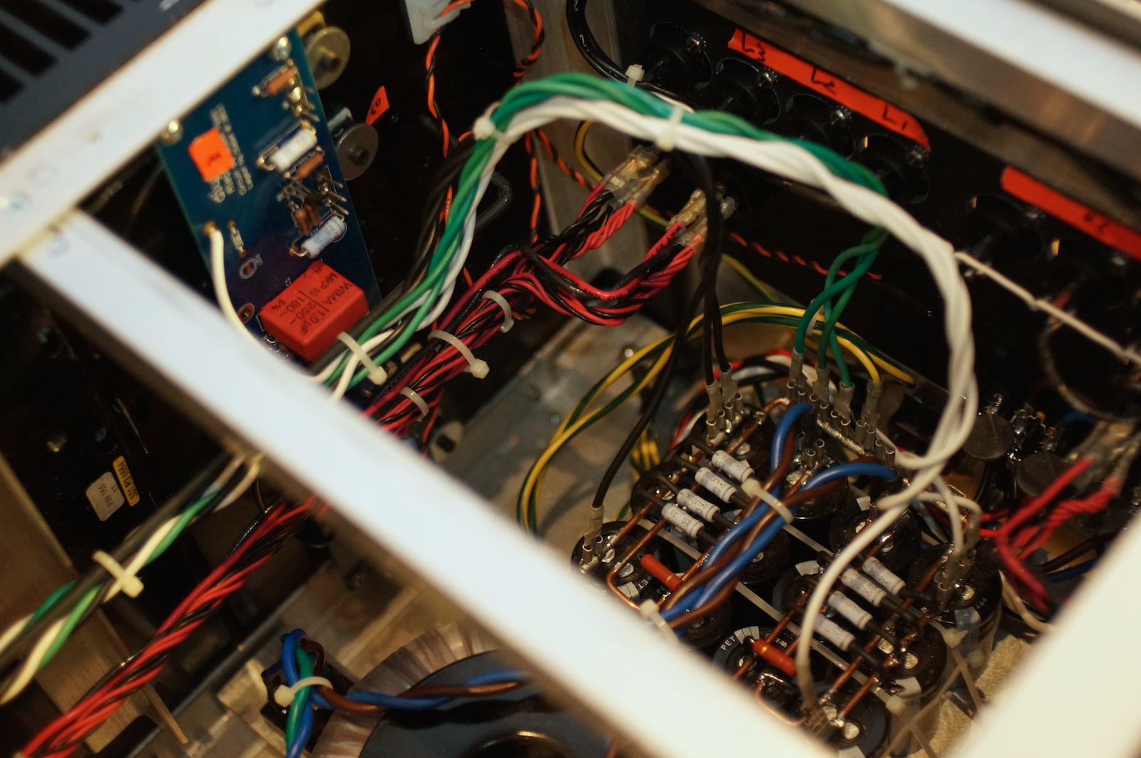

One thing I noticed is that my Aleph was getting really hot when testing it early with partly built chassis (no front panel, no top cover, no bottom cover), but now fully enclosed it is just getting pleasingly warm
Also, when heat rises bias is drifting down. Is that normal?

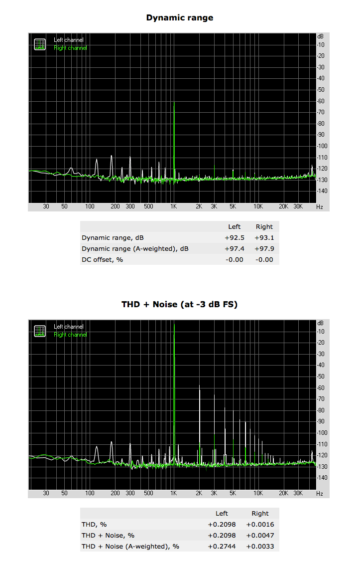

Thank you very much for your advice for the grounding for my 6ch Alph J in one chassis project. I followed your advice, and the amp has absolutely zero hum and zero noise with 111dB sensitivity horn. I'll upload pictures soon!

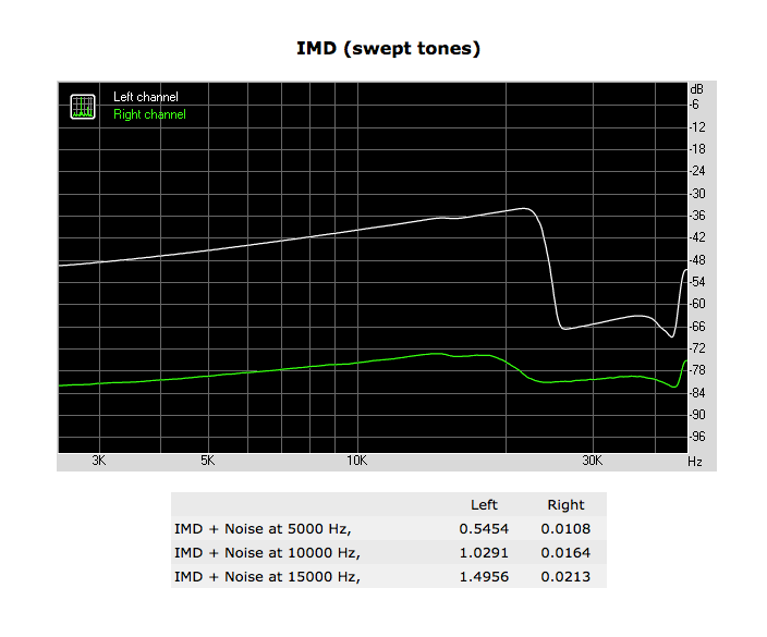

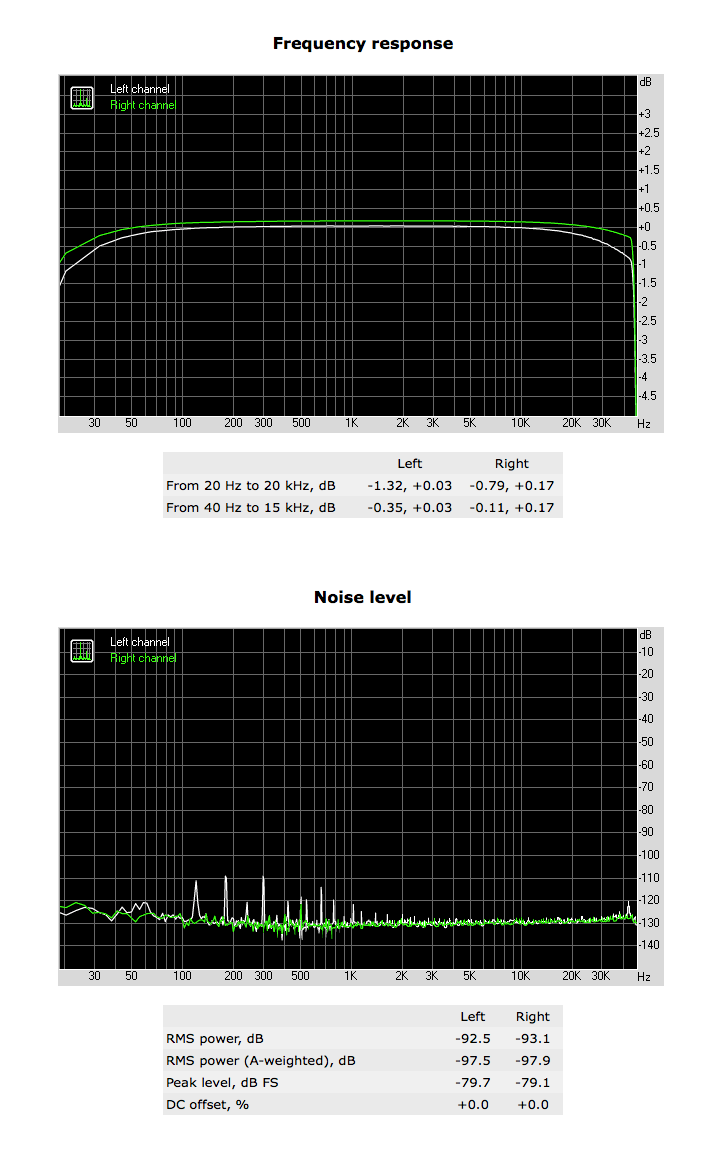

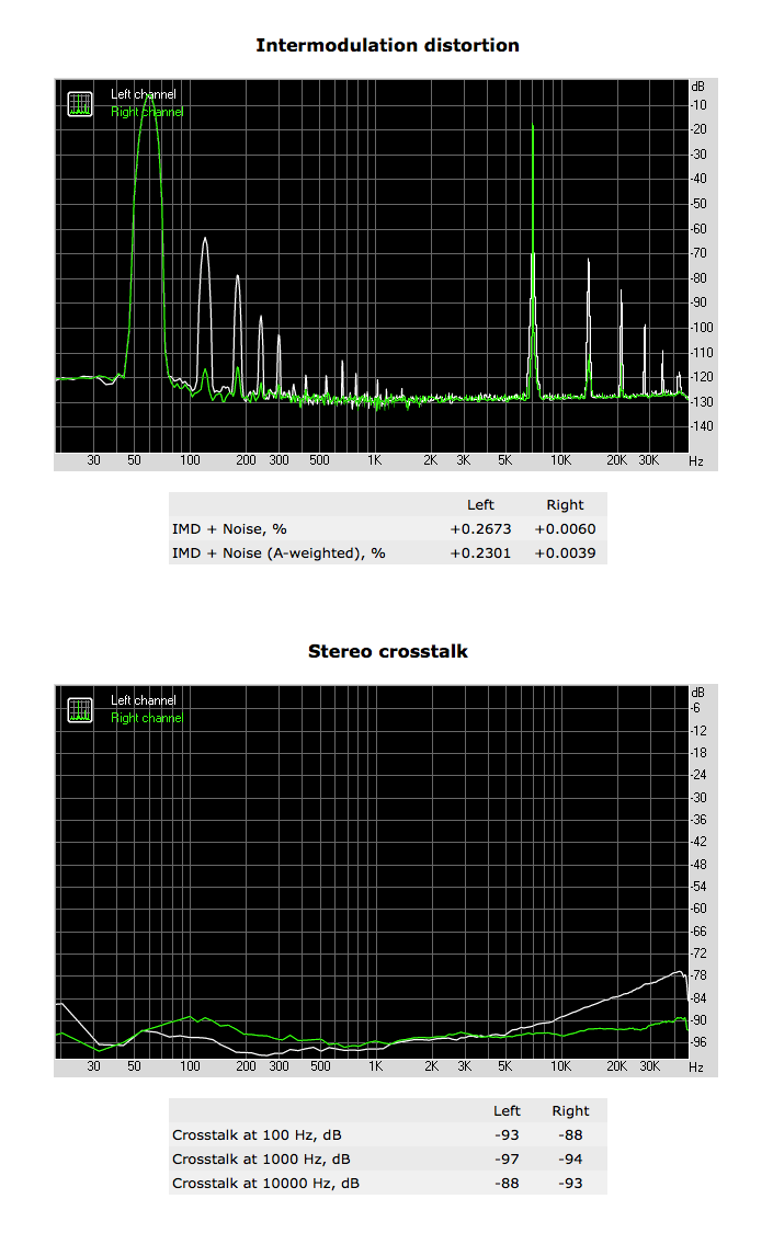

Here is the quick RMAA test result @ 25W. Looks great, doesn't it?
Green is DA/ AD direct loop, White is Aleph J with 8 ohm resistor load. (DA output is digitally trimmed to -12dB or so, so DA is actually +12dB better spec than this...)

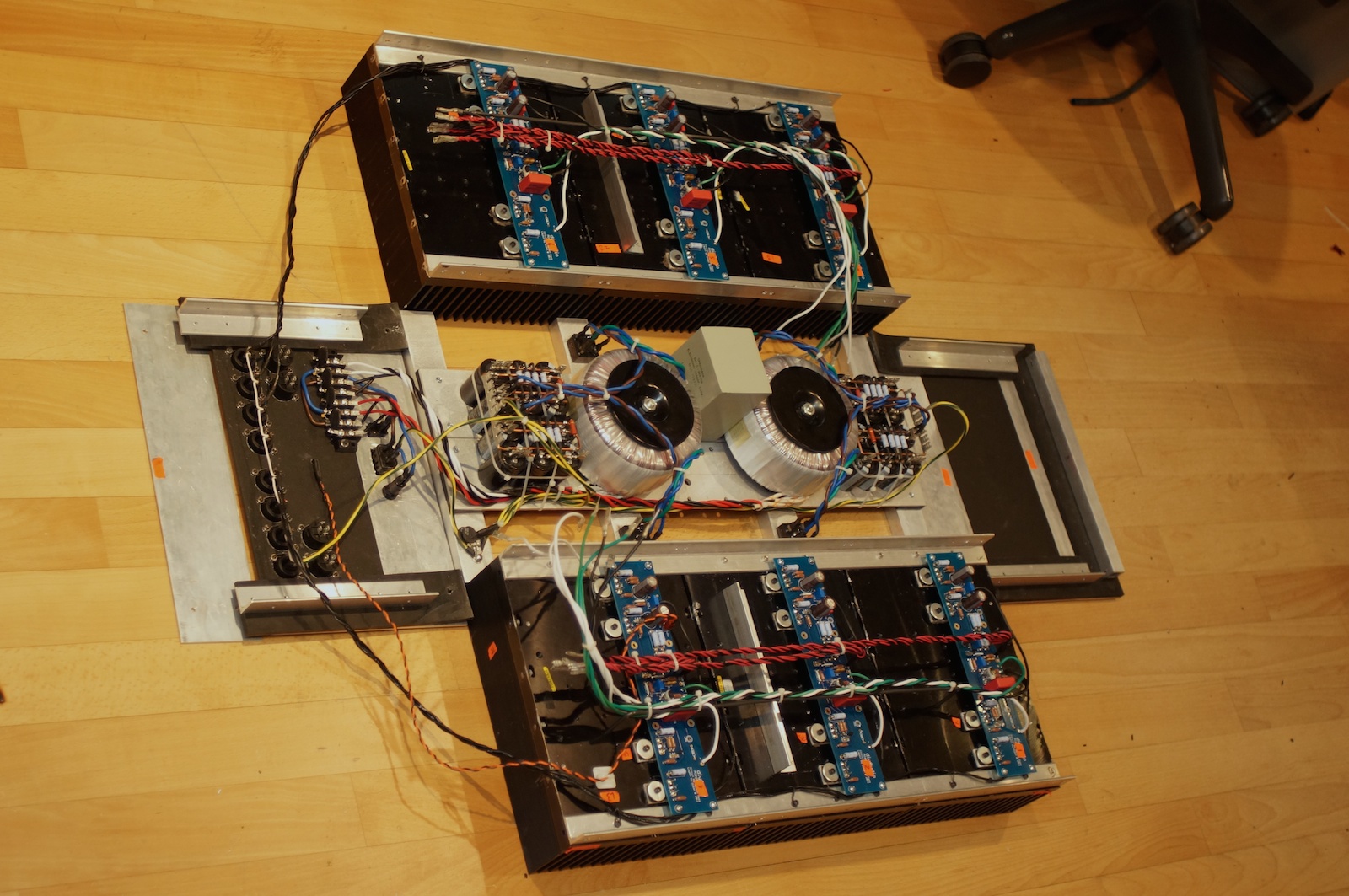

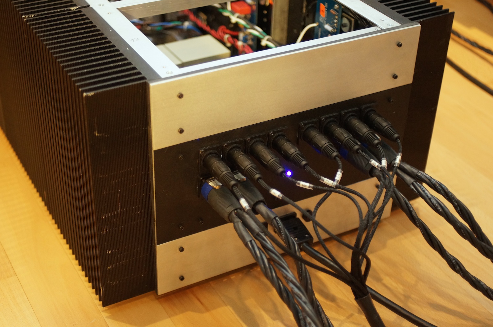

Some pictures of 6ch Aleph J. 24"X 18"X 12", too heavy to carry myself. The amp is driving JBL DMS-1. 4 outs go to each woofers and 2 go to the compression drivers. The center big chokes are used for compression driver DC protection without phase shift at crossover range. The heatsinks are about as hot as my PassLab's Aleph 5.
