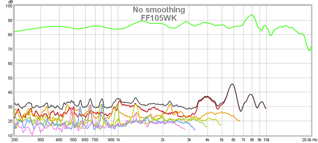

The FF105WK has a large circa 8dB peak at 8.2kHz which is very audible:
![FF105WK-curve.png](https://www.madisoundspeakerstore.com/store/images/Image/FF105WK-curve.png)
Here is my measurement:
![483893d1432037311-subjective-blind-comparison-3in-5in-drivers-round-2-ff105wk-hd.png](https://www.diyaudio.com/forums/attachments/full-range/483893d1432037311-subjective-blind-comparison-3in-5in-drivers-round-2-ff105wk-hd.png)

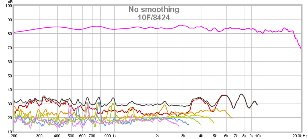

By contrast to the 10F/8424, the response is butter smooth:
![483895d1432037311-subjective-blind-comparison-3in-5in-drivers-round-2-10f-8424-hd.png](https://www.diyaudio.com/forums/attachments/full-range/483895d1432037311-subjective-blind-comparison-3in-5in-drivers-round-2-10f-8424-hd.png)
I don't think the FF85WK is going to be better or even close to the 10F in performance - nor should it be given the difference in price and materials/build quality.

Do note that the guys that know what they are doing suggest XRK's measures are only good to about 600 Hz.

And your point relative to thread topic is?
The posted chart goes to 200 Hz, that it is only good to 600 is relevant.
dave
dave
4ms gate is 250Hz lower end validity according to REW - don't know where you got 600Hz from.
Let's not pollute AA's thread anymore.
600 Hz is my recolecction from when the guys were helping you get your measures into something actually useful in this thread http://www.diyaudio.com/forums/full...parison-3in-4in-class-full-range-drivers.html
I may be mistaken... or you may have changed your room.
dave
Confirmed. But worth noting that at the LFs the resolution is quite poor, which may have promted the 600 Hz number suggested by the measure guys.
dave

One thing I do know, measurements are limited. This test proved it. The 10F and TG9 had a very similar bandwidth. The TG9 sounded "dull" and "un-engaging", yet the 10F had more of something that clarified it and give the sound more resolution and texture. The measured bandwidth and even the impulse response was very close on these units, why did one have so much more to give? For me, it was a make it or break it deal. I liked the 10F best on X's rig, followed by the Alpair, then the Fostex (mainly due to its "unique" way of extracting recorded "ambience"), and the TG9 being merely an honorable mention. I liked the open-ness and range of P830986, but on X's rig, there was some nasty "shrillness" in the upper mid-range that sounds like an unfix-able driver characteristic to me. Is it a poor synergy that caused this? Interesting thing that a lot of people liked that "effect" with that driver.
