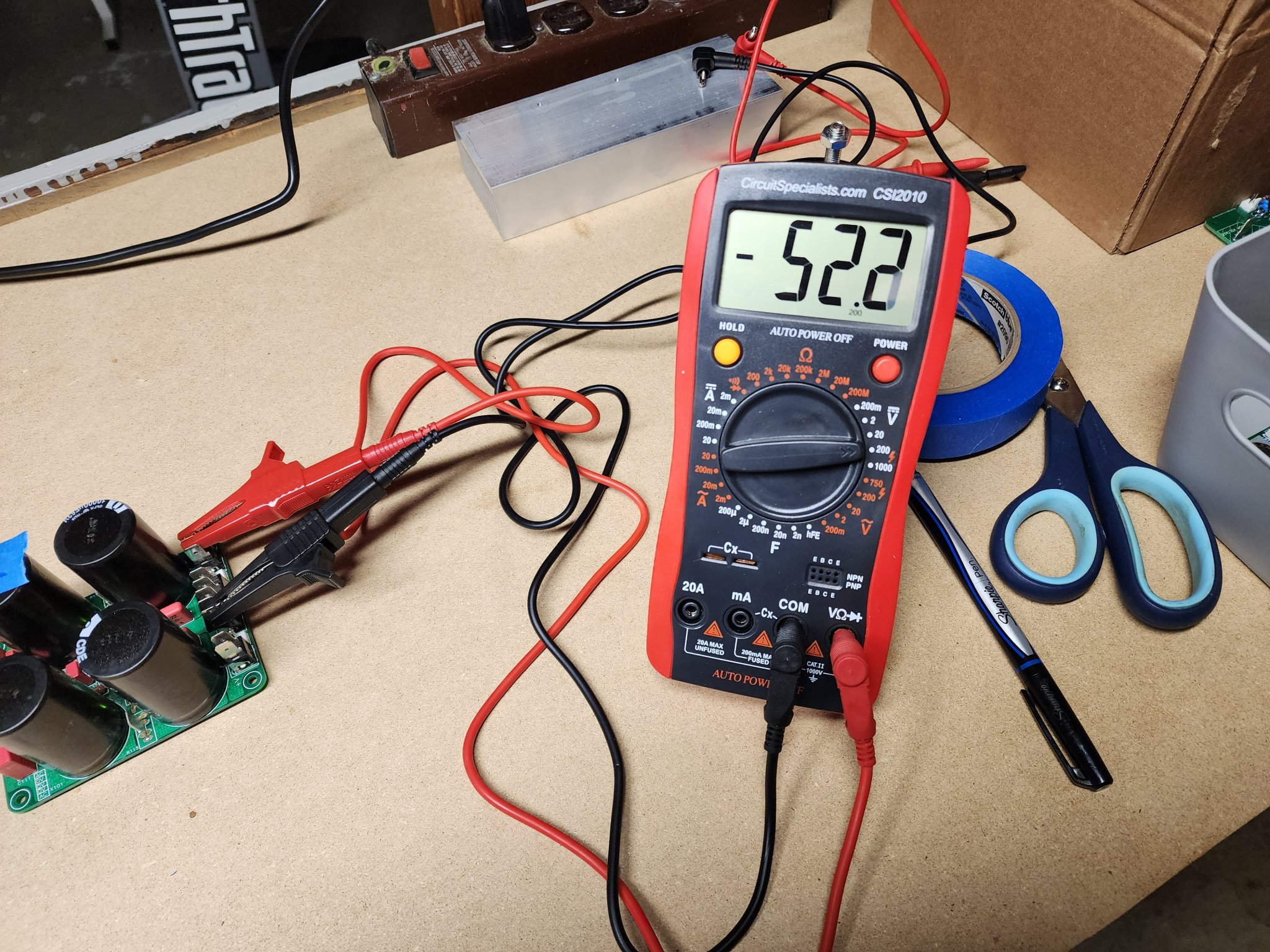

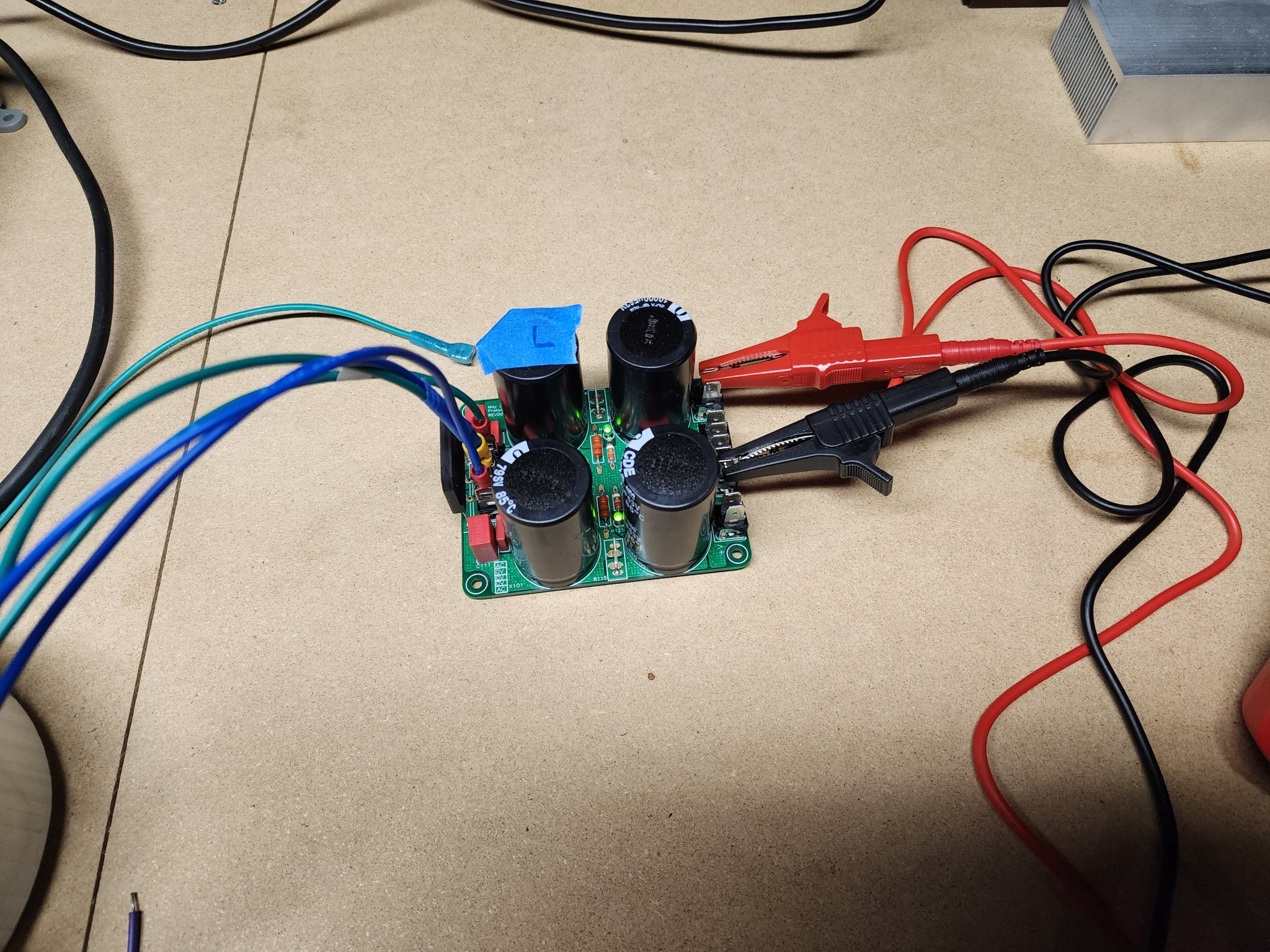

Hi Team,
I'm happy to report that it would appear I have two functioning power supplies for my FH9HVX. Testing has been slow as I work on making flying leads for my MOSFET's, etc. I will be testing the amp boards next and will keep everyone posted. Respectfully, Dave M.
