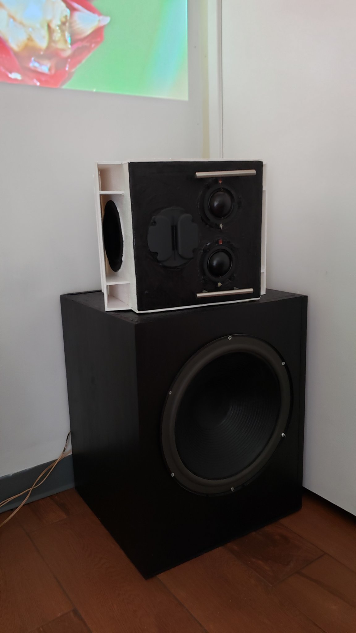

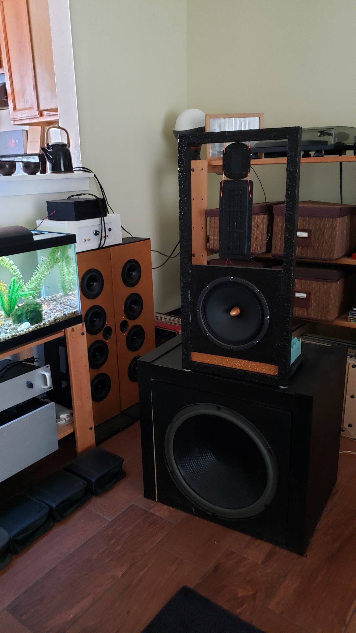

Top is 3.5 way.
Signal is actively split at 150Hz using simple active crossover.
Bottom are two 15" woofers as dipoles powered by two plate amps.
Top started as 3 way, but I quickly realized it has to be 3.5 way for more coherency.
ClassA amps only on top.
Its dipole only up to 5kHz, those hivi planars are closed unlike the b&g I used in other speakers.

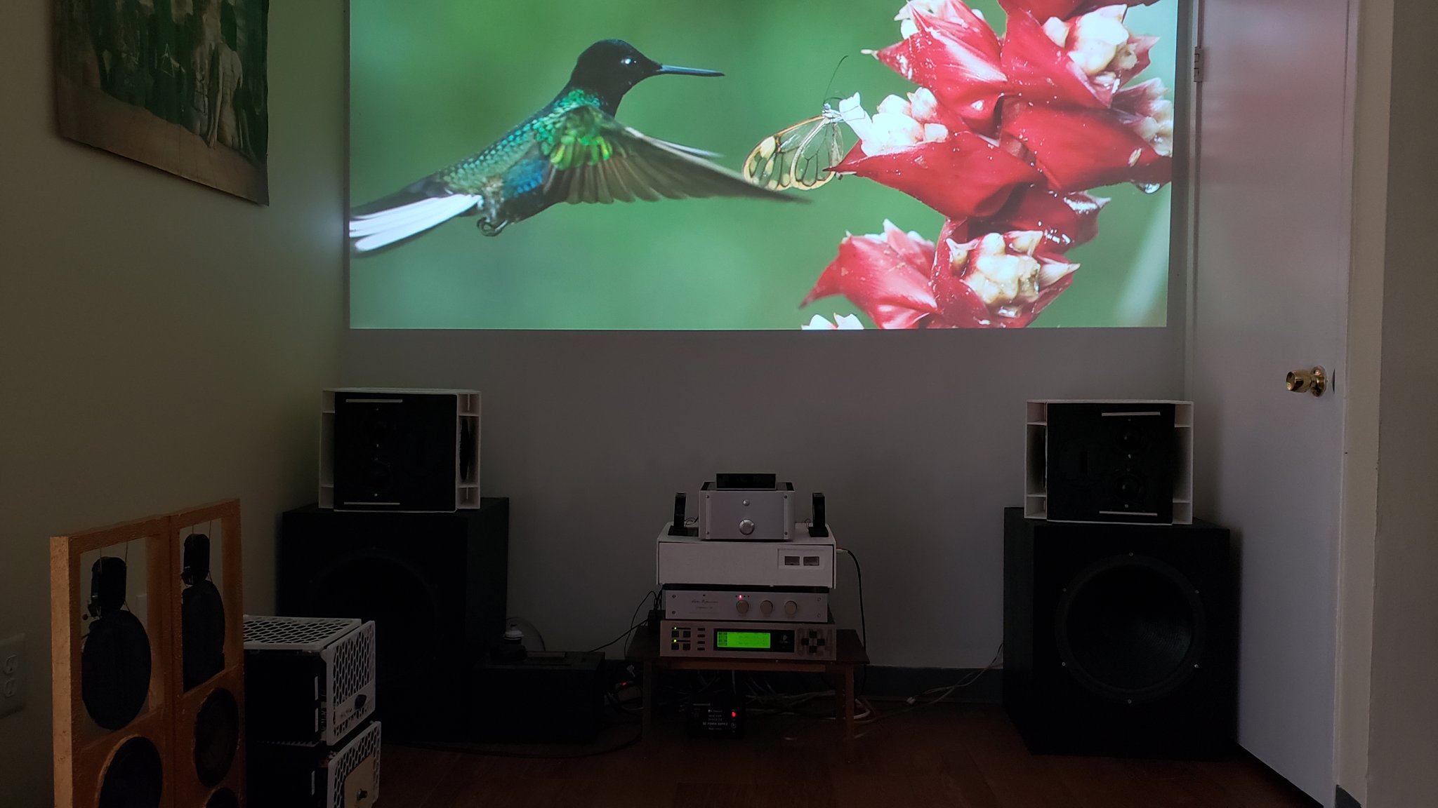

Nice sound room Adason, looks like lots of vinyl and a combo of older and newer equipment. Could I enquire what the name of your main open baffles are, and the ones on the sides with 4 drivers ?. Also, just for curiosity, do you have a movie screen and speakers behind you, as I noticed a projector pointed that way :).
music soothes the savage beast
Joined 2004
Yes, there is my ht system on the other side of the room. I have way too much stuff.

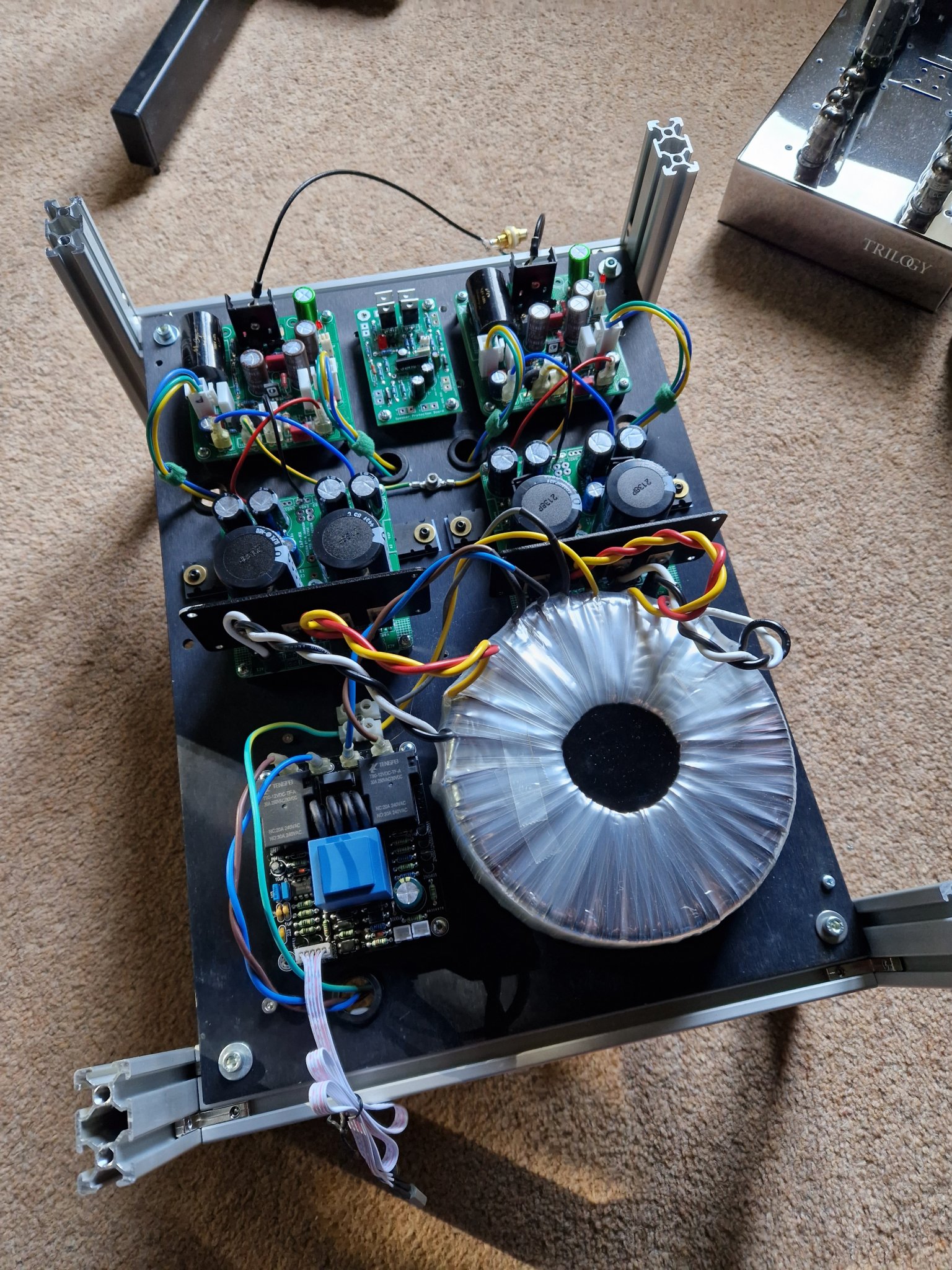

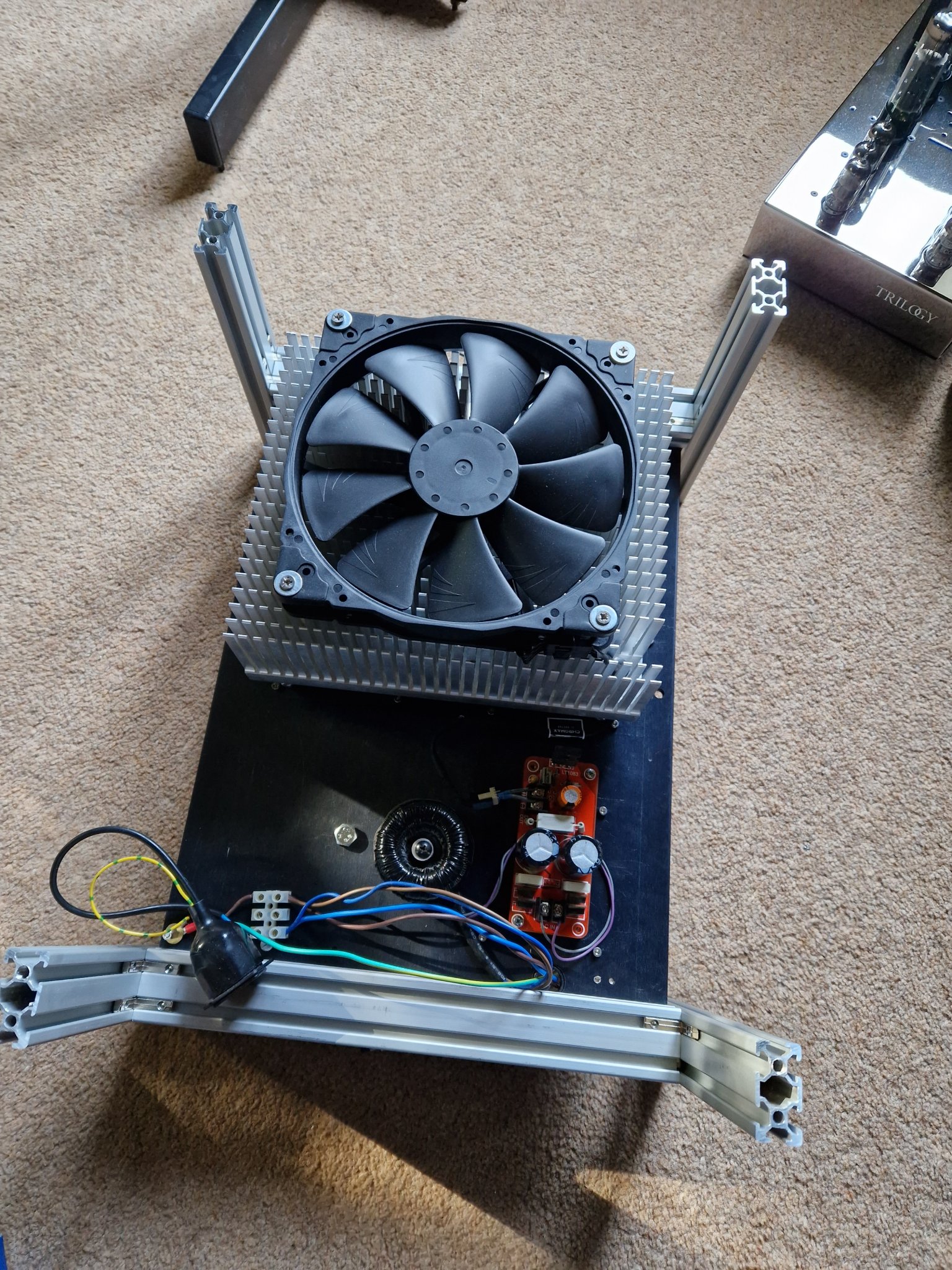

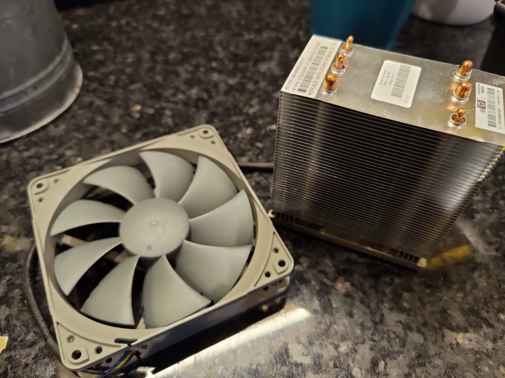

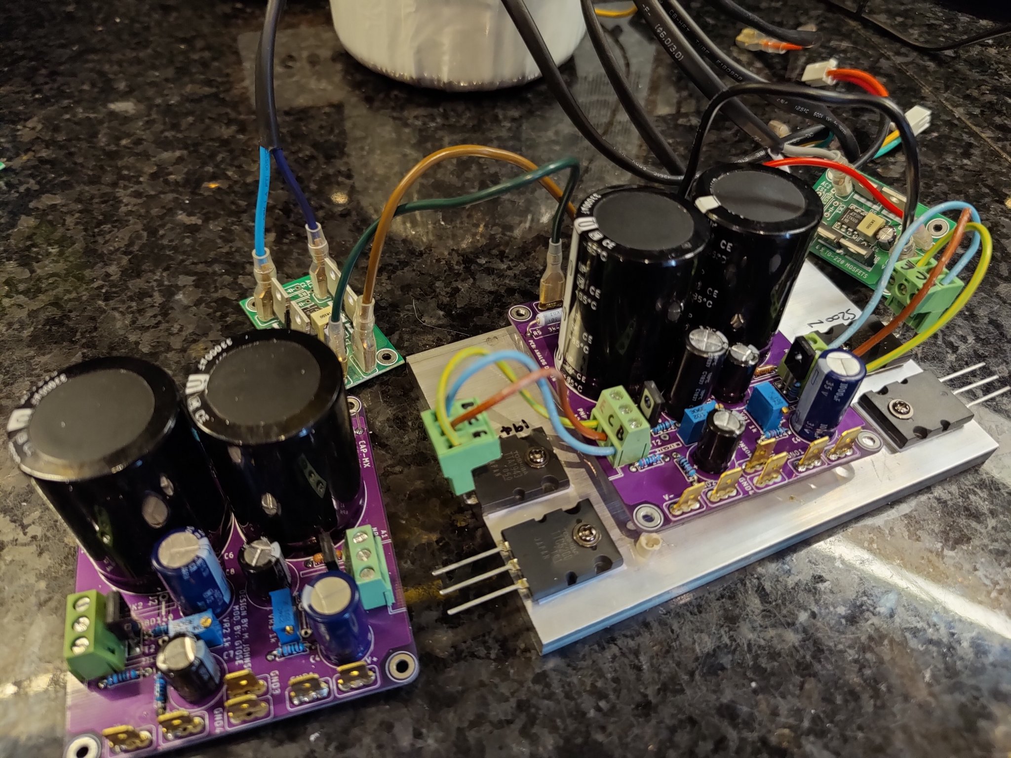

Bit more progress with mine. Nearly all populated and PSU nearly ready to test. Going dual mono as I have the bits and also a 4 output trafo. Need to test it under load. It's 23v but runs a little 'hot' on my mains.
Got some 120mm Noctuas and both the Dell and HP sinks. More pad area on the Dell but the HP has a larger area of fins for the fan to act on. Dell has more meat though...heavier.

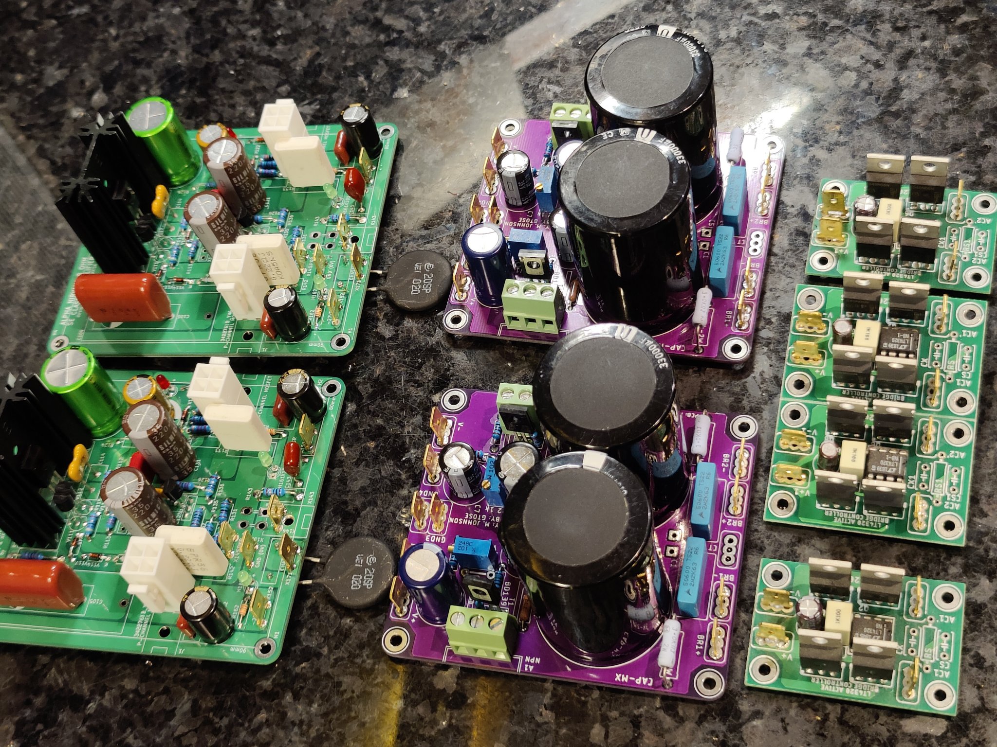

I bought 2 alpha nirvana PCBs and 2 BOM and extra parts for snubber boards from Mouser. When parts com I saw there is no few parts and some parts ar different. I know this is my fault because I don't read all this forum 😃 But how I understand I need to buy -
2.7v zener
10pf 500v silver mica
KSA992
FQA40N25
FQA36P15
8D-20 thermistor
It is right.??

The additional components are the preferred ones used by XRK in certain positions. They are on the anotated (in red) schematic. You don't need them if you have the complete BOM in your basket as far as I am aware. And yes the snubbers for the offboard output devices are required. Hope this helps

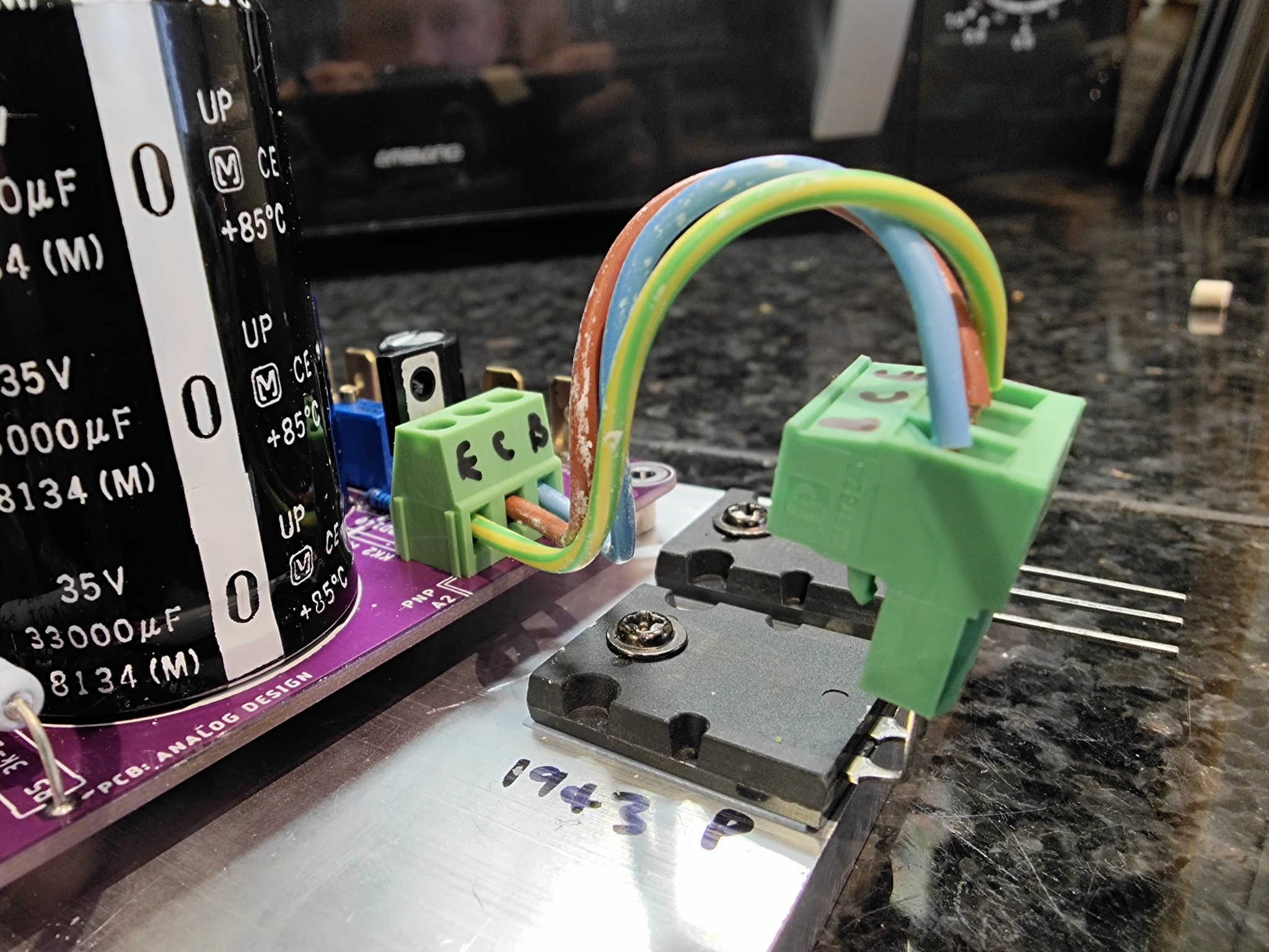

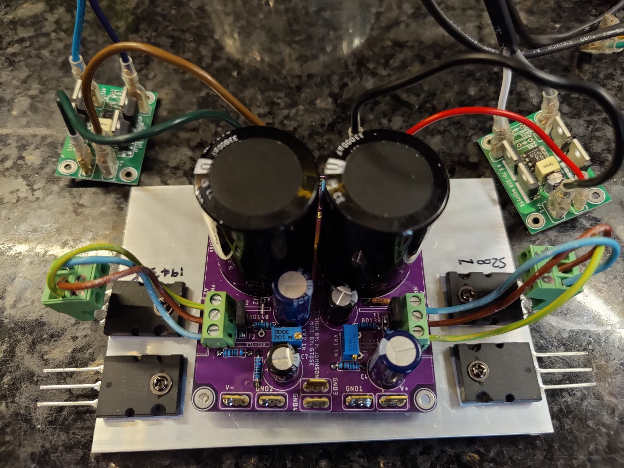

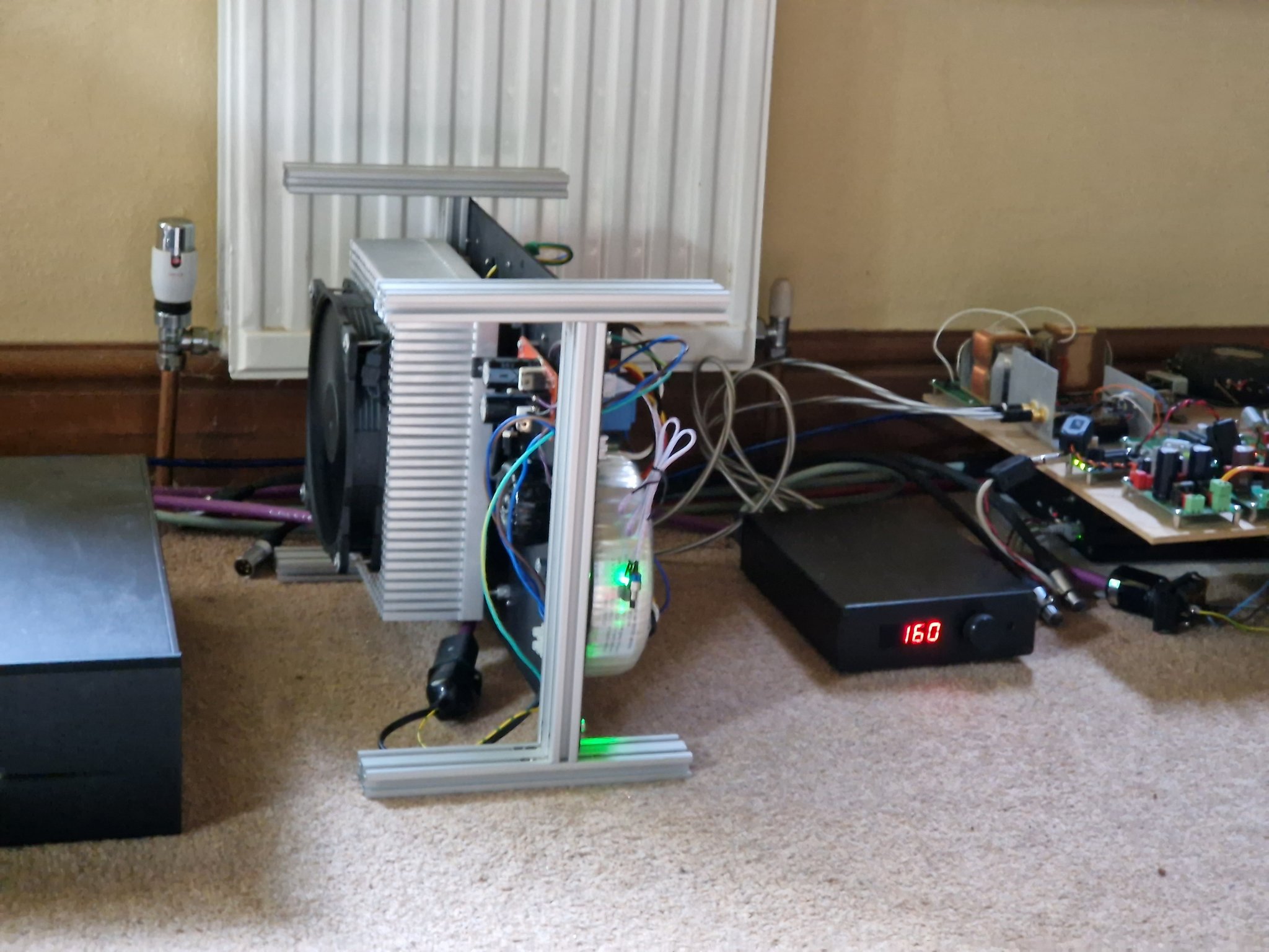

My 4ohm build progresses. I've gone for a double A side Lotus backbone chassis 😊 don't think it will wind up as beautiful as an Elan but I will enjoy choosing some smart clothes. Dual Johnson Gtose cap Mxs and a bit more bias to 2.2A, another little lift. Just need to sort out the DC protection and I'll have to find something else to do. Maybe just listen to it?!
I'm really pleased with the sound quality, it's so unfatiguing, easy to listen to for long periods. That's not damning with faint praise, it's a rare thing in my experience. Thank you again all who so generously share at diyaudio.
