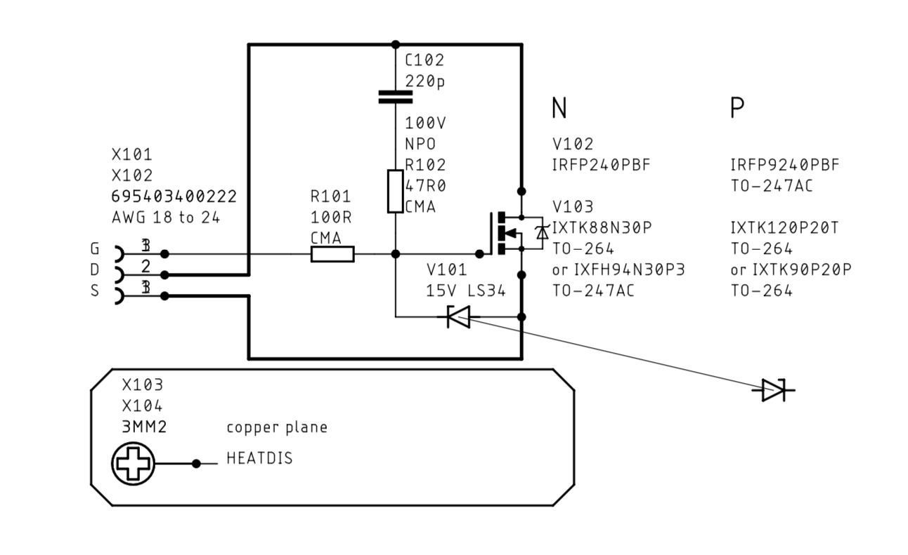

Hi dear friends,
I'm struggling a little bit with selection of components. For me BOM for snubber isn't so clear, or at least, I don't understand it.
I have carefully read the entire tread and still I feel lost because some components on the main board should be ommitted if placed on the snubber boards.
On the schematics, these components are just in the footnote, at the bottom of the schematics, in red:
1. which resistor values are for R101 and R102
2. which is proper direction of V101
3. which are Mouser part numbers for the snubber components.
I am sory for asking dumb questions but I feel lost and wouldn't like to smell the smoke at the start-up.
Any help will be appreciated

On the snubber boards there are:Snubber boards:
100R MELF carbon
47R MRLF carbon
220 pF NPO
12v Zener Melf
I have three questions:R101
R102
C102
V101 (P/N)
Pay close attention to the direction/orientation of V101 zener depending on whether you are building for an Nchannel MOSFET vs Pchannel MOSFET!
There is a BOM in XLS as well as a Mouser shopping cart on the 1st page of this thread.
Best,
Anand.

I will be repackaging the Alpha Nirvana in it’s own enclosure with a BTSB at the front end as such I was wondering what is the maximum supply voltage I can try? The speakers are mostly 4 to 8 ohm loads, so let’s just say 6 ohm. I have heard it at +/-30V DC and it sounds great. Any higher or is that a comfortable maximum? The heatsinks are on a 4U/400, so dissipation maximums per heatsink (200mm deep, 160 mm tall, with 40 mm deep fins) is 0.28 degC/watt. There are two heatsinks per side since each one is only 200mm deep. Obviously there will be only one MOSFET per heatsink. I will probably consider creating a heatspreader to bridge the two heatsinks together. Maybe 50 watts for each heatsink which will give a rise of 14 degrees C per heatsink. Or near 100 watts/ch perhaps? If +/- 30VDC then 1.6A quiescent?
As always, the heatsink dissipation figures and overall MOSFET temperature at pin 2 will probably be the impasse.
Best,
Anand.
Best,
Anand.

Yes, I would think 30V would be fine technically. Can't answer for the sonics, but if X thinks it's OK I believe it could do 47W, and probably 60Wrms into 6R load provided you increase the bias to 4.5A, at which point each device will dissipate about 135W. This is hockey puck territory, Anand, and I would use high dissipation mosfets with more than 300W dissipation, more than twice the use. Let me know which mosfets you use; some do not work well in linear use as they are designed for switching only.
This is a highly stressed amp thermally; but you know that and with care you will get around this I'm sure.
