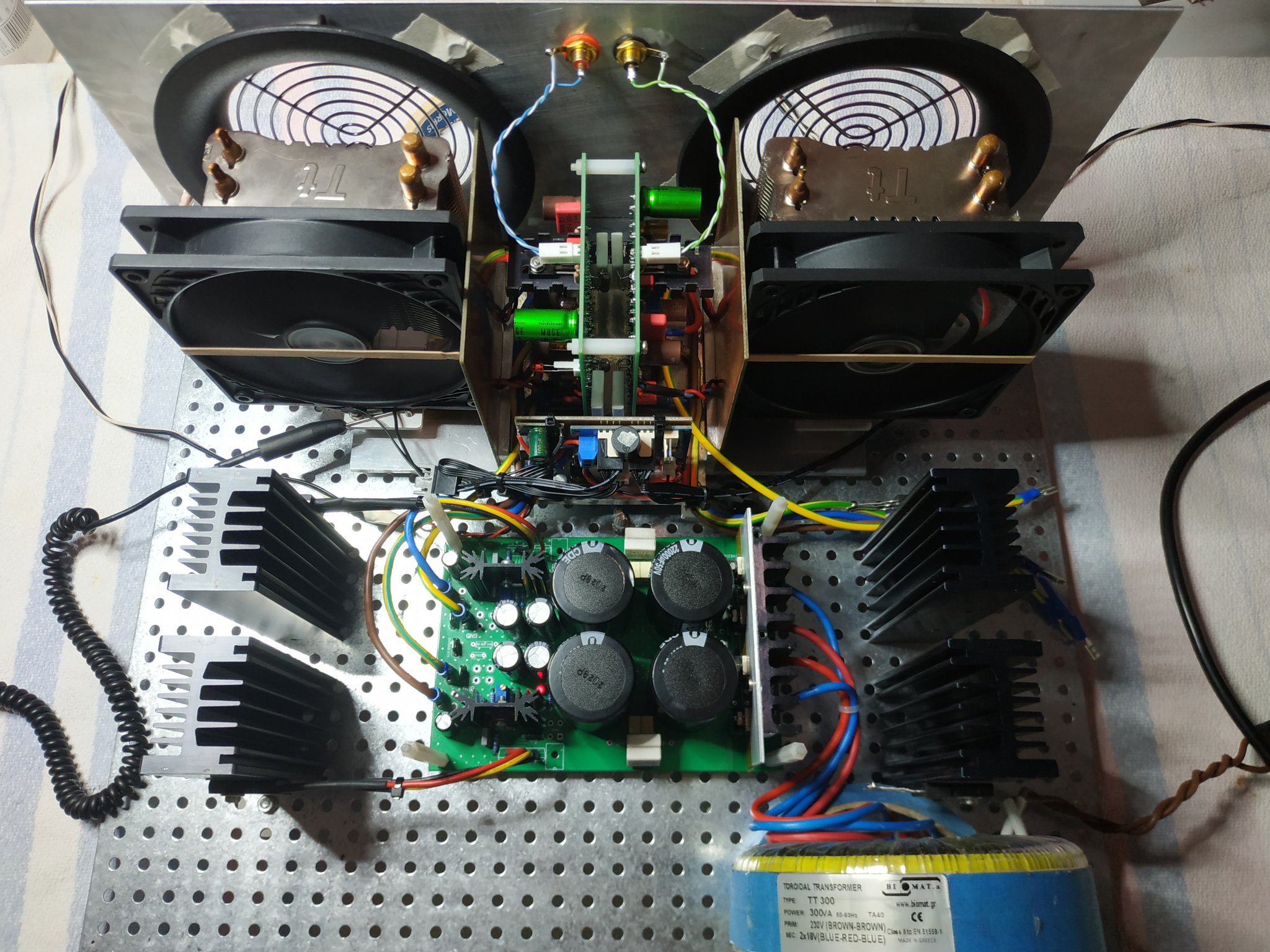

Just because I already have a PSU built with +/-28V rails. Thanks.
So it seems to me you have to make a choice!
1. Pay Hugh to develop an AN4R circuit that uses +/-28v rails.
2. Build the standard AN8R circuit - but change your 4ohm spkrs for some 8ohm spkrs.
or
3. Change the power transformer on your PS to one with lower secondary voltages ... so as to deliver +/-21v rails.

Indeed that would be the best option, although I wouldn’t get too concerned. If you have the impedance and phase curves for your current speaker that would be most useful.
Of note, my colleague has an 8R version of the AN39 with +/-30V rails. The speakers he used were sensitive at about 90dB with impedance dips to 4 ohms (at 100-300Hz). No clipping distortion and no wooly bass issues at 85-90dB at the listening position of about 8 feet.

Another option... or two...
4. Build the 8R knowing that even though it's in the back of your mind that you're not perfectly balanced for max current and max voltage to clipping at 4R... that you'll be perfectly fine in the vast majority of situations.
Do some basic calcs to see if it's worth the bother.
If you've got some particularly unique speakers and/or have a massive room and like it LOUD! You could...
5. Go nuts and build two "8R" to run in parallel. That might be sexy. Check with the master to see if there are any potential detriments, but I can't think of any (other than the obvious cost and space).

Well, there is a 4R version in this thread as I recall, but essentially you will have to increase the quiescent to about 3A.
That will hugely increase the output device dissipation at the existing 27V rail, but with a lower impedance to achieve 39W you don't need more rail voltage anyway; 20V or even 22V would be fine. You are advised to move to FQA40N25 and FQA36P15 mosfets, which have a pd of 280W apiece.
