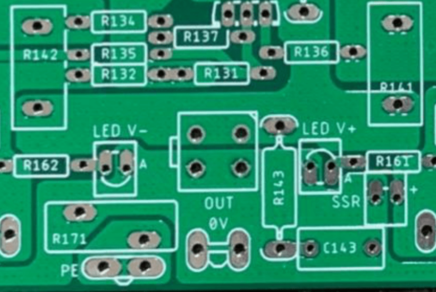

A quick question before I begin setting up to test. I would like to confirm that if using a molex box for X143, the output would be from pins 1 and 2, and these would attach to the resistor load I will be using for testing. I have attached a schematic. Thanks for the help.

Because the schematic you have posted is also trying to establish a relationship between the pin tabs marked X144 and X145, it somewhat obscures the association of which Molex pins (in X143) are the “+” output and which are the “-“ output. As such, allow me to show you another schematic and picture:
Now you can see pins 1 or 3 (or both) are the true (+) signal outputs and pins 2 or 4 (or both) are the analog signal ground. So your resistor can connect across them.
With your DMM you can double check this. The junctions of R141, R142 and R143 are all on the same pad trace that connect to the pins 1 and 3 of X143. These are your “+” outputs. As such, the other two pins 2 and 4 should have continuity with the faston tab marked “0V” and are your analog output signal “-“ :
Also you’ll see a clean break in the trace within the Molex X143 silkscreen above. Of course your load resistor doesn’t care which side it is connected to just as long as it is from + signal output to analog signal ground (0V).

The schematic you posted is less busy. I am in the process of changing my Moles cables out to soldered leads and spades. Thank you for the clarification as I was on the way to installing the spades in a horizontal position (pin1-pin2) rather than vertical (pin1-pin3). I will check everything more than once before powering up.

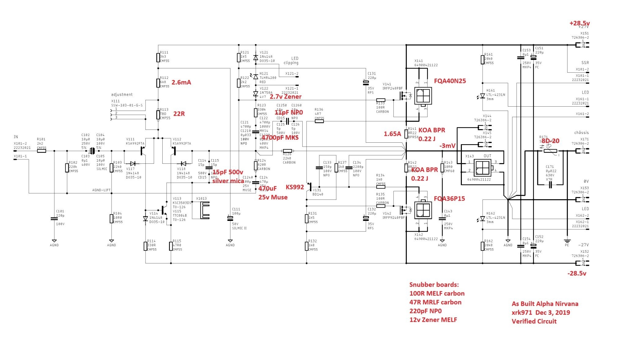

Hi everyone. My PSU is +/-28V rails and my speakers are 4 ohm, so not sure if I should be using the 4R BOM which assumes +/-20V rails or the 8R BOM which assumes +/-28V rails (or if I have to come up with my own values). Any help is appreciated.
There are some component value differences between the AN8R circuit and the AN4R circuit - in addition to the +/- DC rail values.
It was previously reported that someone who built the AN8R version (with +/-27v or 28v DC rails) found that it didn't like his 4ohm spkrs; OTOH I built the AN4R version (with +/-21v DC rails) and it drives my 4ohm spkrs excellently.
Thanks @andyr. I'm actually asking about component values. I want to build an AN with +/-28V rails for 4 ohm speakers, and I'm not sure what component values to use. Do I use the ones from the 4R BOM, the 8R BOM, or some modified BOM?
Then it would seem ... you're on your own, rdb!
No one has built a 4R version with 28v rails.
You may have to pay Hugh for some work with LTspice?
I guess the question is ... why do you want 28v rails for the 4R version? Presumably, for greater power than 21v rails deliver?
I'm getting 45w into 4 ohms from my 21v rails - with quite a lot of heat output. 28v rails would produce a lot more heat - I think you'd need fans for this. (Which produce noise.
