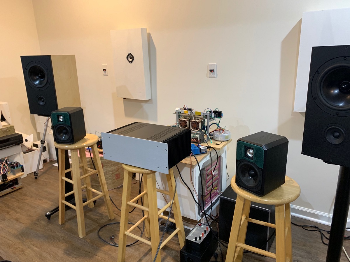

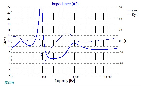

I just built a new set of speakers today and listening to them now with the Alpha Nirvana. They sound very nice - similar to the bigger 10F/RS225 FAST but smaller in a compact bookshelf form. These use the FR58EX full range and AC130F1 woofer in a FAST configuration. Uses a new passive crossover that I just designed a few days ago. I had the AC130F1's already and repurposed and old Boston HD5 cabinet.
Although this XO dips down to 5.5ohms from nominal 8ohms, it sounds fine:
With the support of a subwoofer for stuff below 100Hz, the speaker works brilliantly.

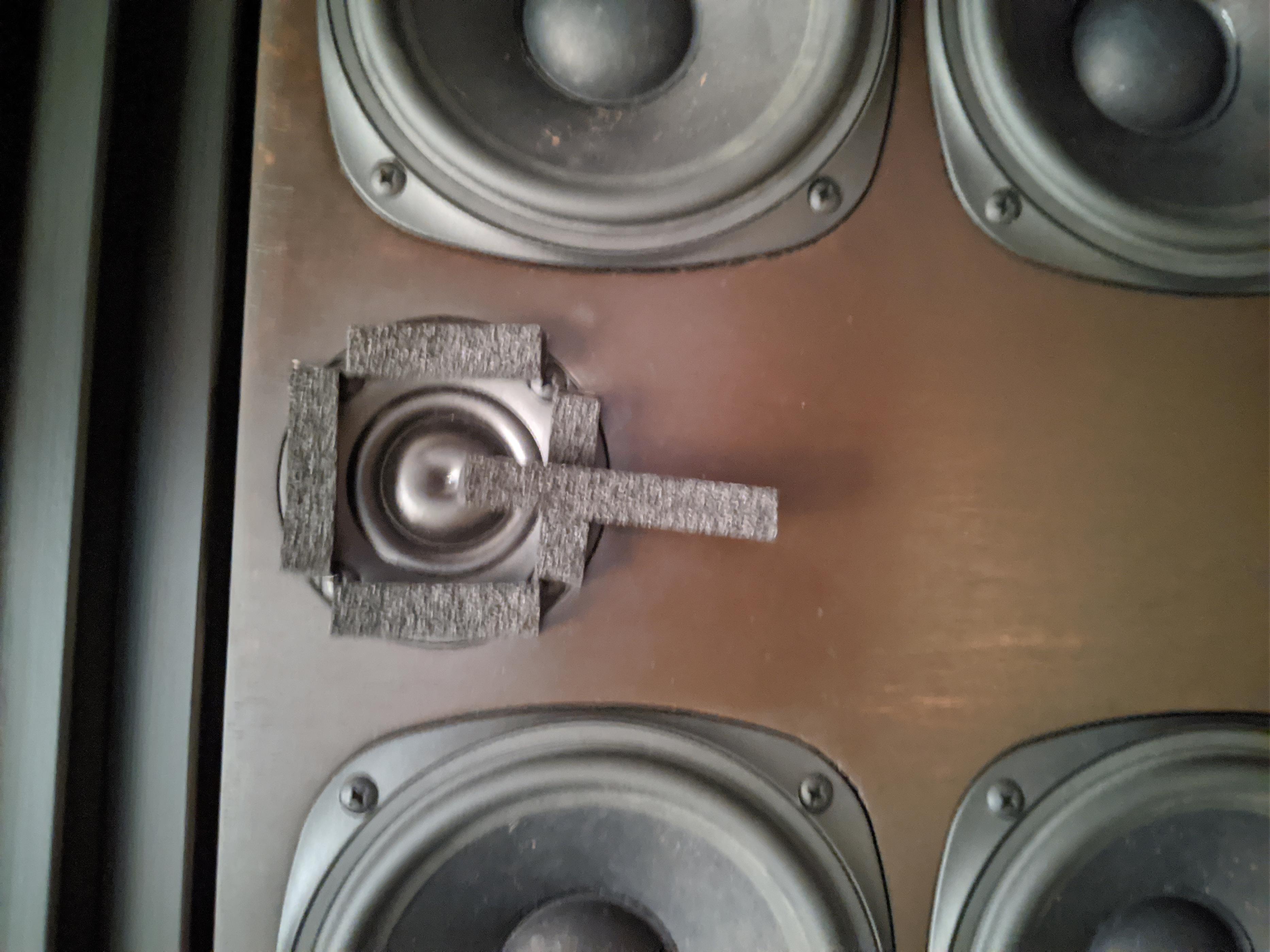

X,
Good use of Scotchbrite!
Greg
Yes, cleans pots and pans AND improves imaging and soundstage!
Over the years I've tried many tweeter dampening schemese, and I've settled on that just thin strips of weather sealing foam with one additional piece in the vertical plane just below the dome works really well.
Of course, neoprene across the baffle is even better, but this quick solution generates really good results. This is one of those things there's a very slight difference with on-axis measurement, but what it really can fix is off-axis, late arrival reflections.
Greg
This is a bit OT, but I will indulge myself one more time. I haven’t tried hanging a cantilever of foam in front of the tweeter. Is your photo supposed to be rotated 90 so that the cantilever is from bottom going up? Do you have measurements before and after?
Here’s what the Scotchbrite does. Certainly one of the best bang for your buck mods to a speaker. If you look at the famous LS3/5A’s and also Dunlavey SC-IV, you’ll notice similar treatments.
