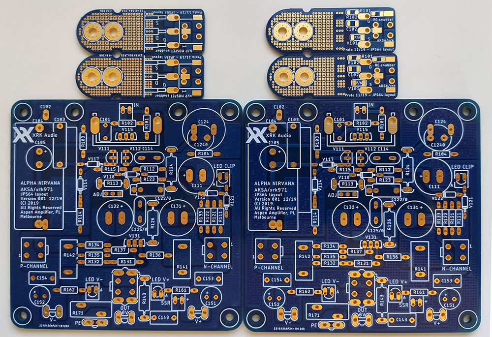

Do we have a tested PCB layout for the diy use.
I would like to make this amp using handmade pcb.
Regards you

We have tested PCBs for DIY use! Why on earth would you want to make up your own PCB?

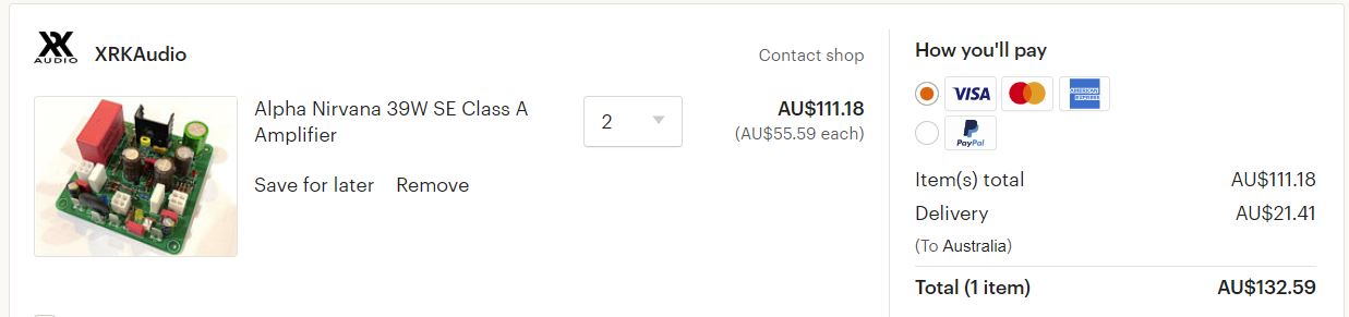

Not everyone can afford the $133AUD (~$93usd) for just the boards alone.
True - but this is not a cheap amp to build ... with its cooling requirements.

We do indeed have a tested PCB layout:
This is a public and open DIY project. You are free to make your own layout and PCB or do it point to point on perforated veroboard. Note that these are two-sides layouts - not easy to home etch.
