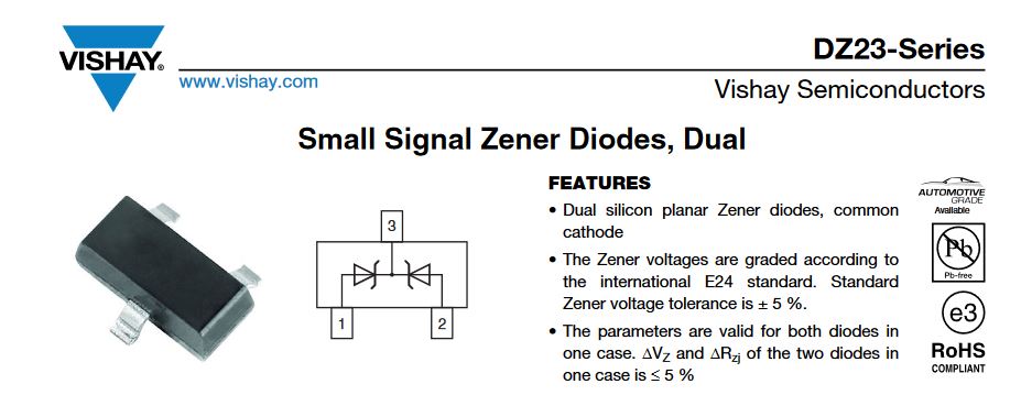

Thanks, Hugh - I will include the D23C15-E3-08GICT-ND dual Zener in my build.
Attached is a pic from the datasheet. The 2 legs on the same side are both Anodes - can you confirm it is these we connect to the Gate & Source of each MOSFET?
Hi X,
Given the pic of the dual-Zener that I have attached, can you tell me whether the connections you made for V101 on your Snubber PCB are compatible with the dual-Zener?
And thank you for explaining that the zener shown between Source & Gate is internal to the MOSFET.
But in relation to the text on your Snubber schematic ... can I suggest - for consistency - you need to replace V102 & V103 with V141 & V142!
Hi X,
Andy
Spacing between pins 2-3 on SOT23 is 1.9mm and pads for the MELF diode are spaced by 3.0mm, so it is a bit short. However, you could scrape off some of the solder mask on one of the pads and it would fit just fine. Or you could just follow the directions I gave for setting the orientation of the standard MELF diodes as you only need to solder 4 of these. (The Cathode stripe faces the MOSFET body on the N channel and away for the P channel). I think setting the correct orientation is easier than scraping the solder mask off near the pads. Plus, the specified MELF diode is probably more robust.

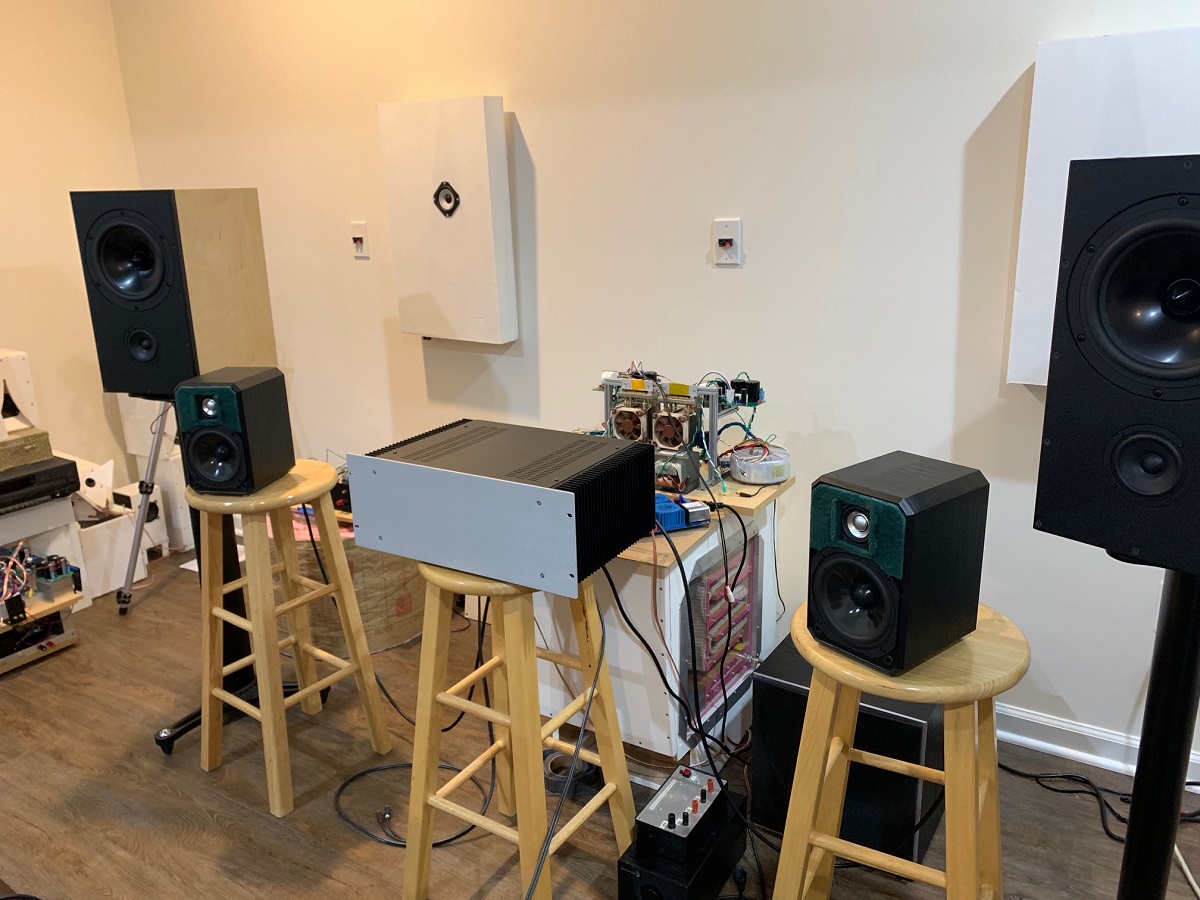

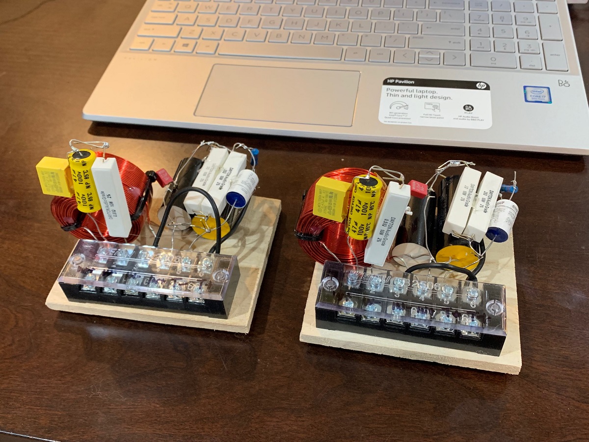

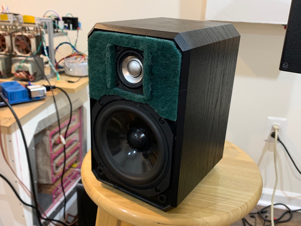

I just built a new set of speakers today and listening to them now with the Alpha Nirvana. They sound very nice - similar to the bigger 10F/RS225 FAST but smaller in a compact bookshelf form. These use the FR58EX full range and AC130F1 woofer in a FAST configuration. Uses a new passive crossover that I just designed a few days ago. I had the AC130F1's already and repurposed and old Boston HD5 cabinet.
Although this XO dips down to 5.5ohms from nominal 8ohms, it sounds fine:
With the support of a subwoofer for stuff below 100Hz, the speaker works brilliantly.
Thanks, X.
Yes, if the Snubber PCBs aren't compatible with Hugh's suggested double diodes ... then we need to stick with the original single diodes.
Andy

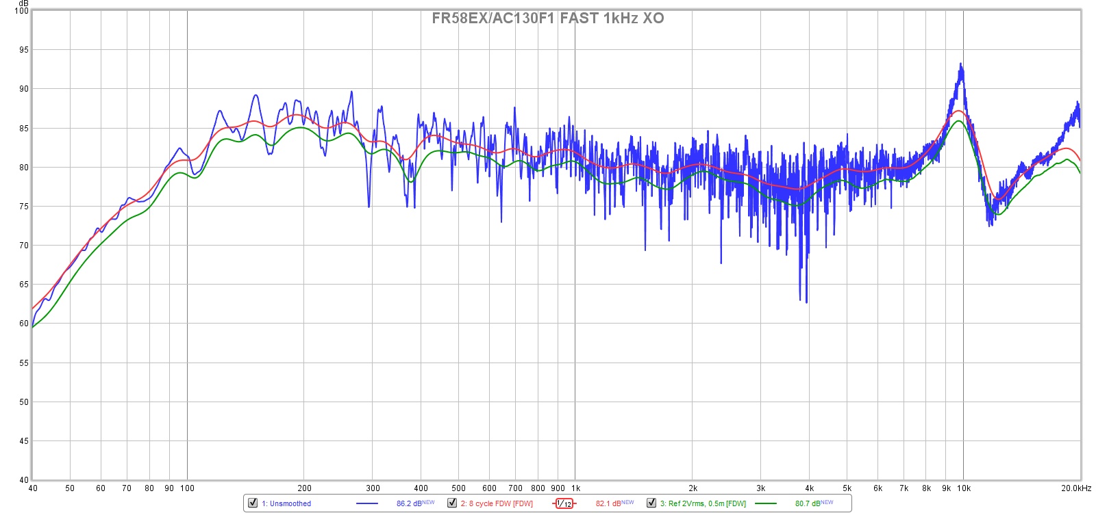

That's a huge (almost 15 dB) 10k resonance peak (reminds me of Lowther); must be audible even with a class A amp
Did you try SB65WBAC25-4? Looks much better.
FR58EX's factory curve looks much better too:
Strange but my previous set did not have that huge peak. I see that peak on data from hdspeakerman’s data too. Something change in manufacturing. I think it is missing the rubber damping between the cone and dustcap. Here is data from 1st generation:
