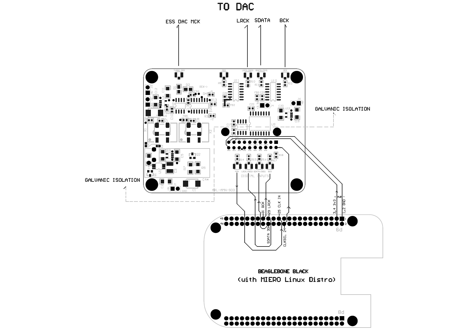

BBB-S03 connection update
Realised a mistake with the connections shown in previous posts. BBB P9 connector numberings!!! -apologies
Wiring updated
Also, when setup up this way there will no issues with power sequencing conditions that could damage the BBB. The isolators on the S03 board will effectively 'block' any voltages from going into the BBB if BBB is shutdown or unpowered while S03 is still active
For those who have BBB - connection as shown for full synchronous clocking. No cape necessary.
On-board clock of the BBB should be disabled (or removed) and use appropriately divided clock from S03 instead.
Currently BBB has single 24.576MHz clock support only so only one S03 XO (49.152MHz or 98.304MHz) needs to be mounted or enabled. If 98.304MHz used then you get 'Turbo' Sync capability to 9018 DACs. Of course other DACs like PCM1794 also possible with BCK out from S03 as MCK'
Sample frequencies are limited to 48K, 96K and 192K as result of this single clock of the BBB. If future versions allow dual audio clocks then full range of sample frequencies will be possible and then CKSEL can be used to automatically switch.
Until then upsampling 44.1k-based audio files using software utility is a suitable option
For those who wish to test S03 with BBB an update to the drivers can be found here -> http://bbb.ieero.com
Many thanks to Miero for his efforts!
Suitable setup as shown in the annex:

Yes, dual clock support to handle 44.1k and 48k based natively but need to configure clock support in BBB as per instruction shown here: http://bbb.ieero.com/
Scroll down to "HW and driver configuration" and then under "Clock Configuration":
Installed clocks are configurable via:
- kernel option snd_soc_botic.ext_masterclk
Examples:
0 ... no external clocks, just onboard for 48k freq (default)
1 ... external clock for 44k1 + onboard for 48k
2 ... external clock for 48k only
3 ... external clocks for 44k1 and 48k (needed for cape)
+4 ... invert polarity of clock selection switch GPIO0_15
Select option #3 above for dual clock inputs.
As for S03 clocks you can use either 45.1584MHz/49.152MHz and div/2 or 90.3168MHz/98.304MHz and div/4 to get the 22.5792/24.576MHz as required by BBB.

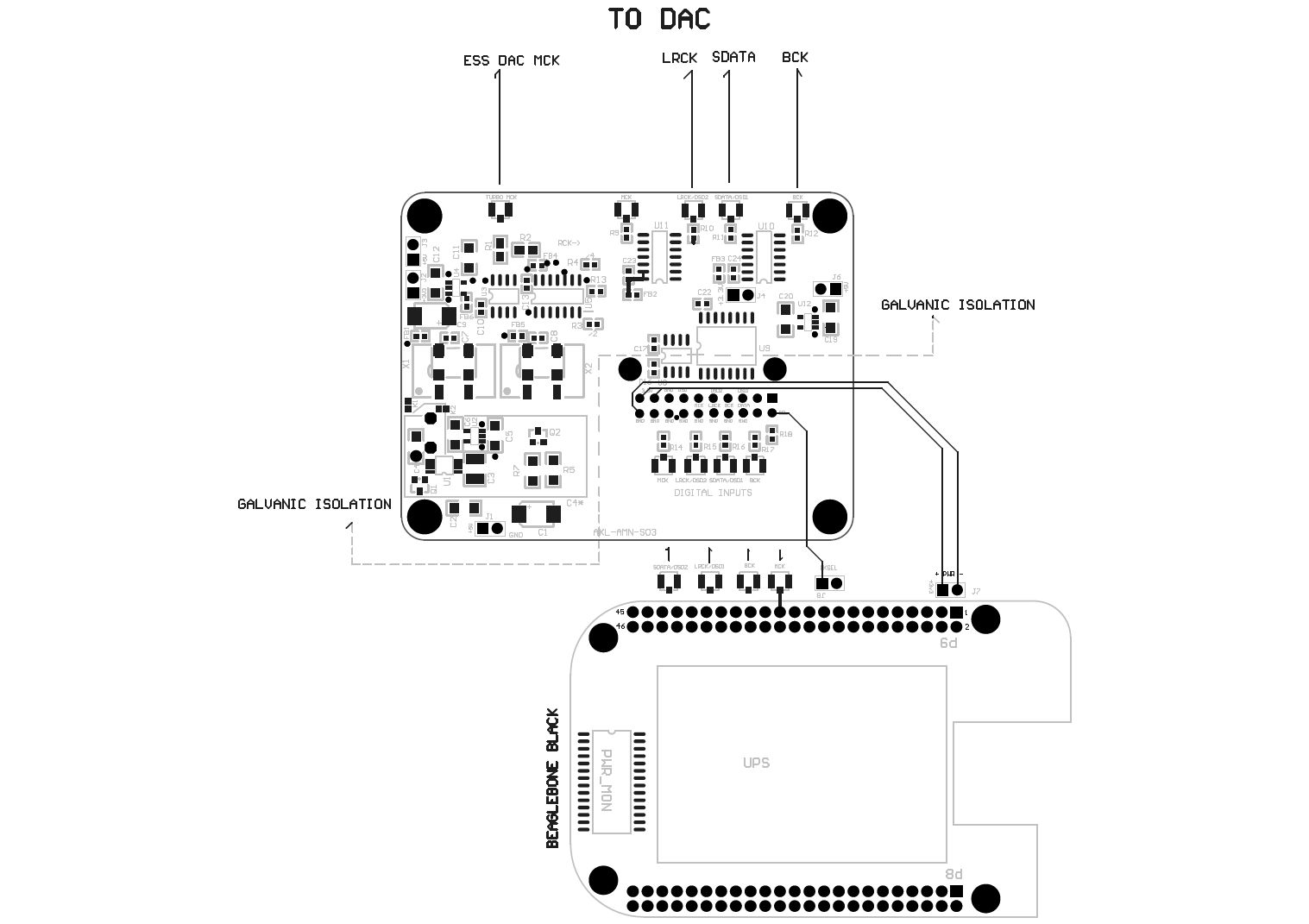

A quick preview of an add-on board for BBB that supports UPS
1. UPS kicks in when external power is removed. On-board PWR_MON will continue to power the BBB (~1hr) or options to safely shutdown BBB immediately. Same shutdown action if battery level goes below operational level
2. Automatic boot from SDCARD or internal Flash. No boot button press required.
3. Matching U.FL interfaces and PWR/CKSEL to the S03.
The above features will practically result in a reliable 'hands-free' system that can be tucked away

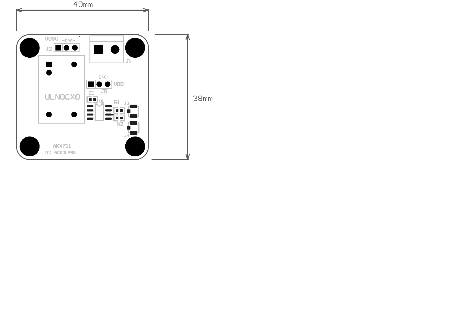

Yes, there are better spec'd ones from NDK, SiLabs and Crystek but custom built-to-order only. Asking 50pcs min order plus thus usual export terms and all the end-user application queries. Price guide ~USD30 each. If there is sufficient interest I can arrange to supply these for DIY use.Are there any better oscillators for 90 and 98 than si590?
Alternatively, there is this new super XO from ULNOCXO (a.k.a Pulsar Clocks). Will set you back ~$1K+ for a dual XO setup but if your music is 48K based or resampled to these then single XO type will do. Needs its own board though as e.g in pic
Could you please check if this noise has the clock frequency signature or mains Hz. Additional filtering is fine hereWhen measuring power supply noise(with small as possible ground loop) I get about 190 mVpp on oscillator power pins. Maybe I should add few smd ceramic capacitors after the ferrite bead beside existing 10nf NP0?
If you are using short connections to the DAC MCK (which I will assume) then the impedance matching resistor (R1) on the S03 board will suffice.

I'll begin from the end. Noise is influenced by the clock frequency. With additional 10nF caps I've managed to lower it almost 3x. I'm talking about caps directly across oscillators. I would add some on dividers and reclock ICs.
For diyer, pulsar clocks is maybe a over kill, because one need to pay attention to the minute detail so that invested money have some(audible) sense. NDK or Crystek are far more attractive so if we can find the best candidate(for 90 and 98) then I'm in for the GB. I hope we can reach min required quantity.

... Any estimate on when the UPS cape will be available? And magnitude of cost?
Also consider adding an isolated I2C feed from the BBB through the S0x to the eventual DAC, that would be nice icing on the cake!
It will take ~2-4wks to firm up everything for pricing and availability. I will be a fully populated board. "Batteries not included ..."
Yes, isolated I2C will be good but prefer to be on the UPS cape rather than going through the S03 board. So no changes to the S03 board
