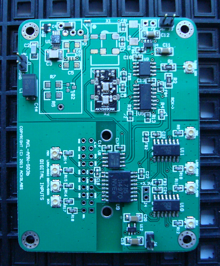

Assembly is nearly complete.
In the case of a single 100MHz XO, how do I handle R3 and R4? Any other things to do differently?
I have an early S03 board and an early Amanero. Presumably I should still follow your pdf pg5 modification notes?

For Async reclocking as above:
X2 - 100MHz CCHD-950 XO
R3, R4 - NC
X1- NC
Also, if not mounted already:
U8, U5 and associated components like C16, C17, C13, FB4, R13 not needed
FB1 and C7 not needed

Perfect - thank you!
I have all the "extra" components mounted, so I will leave them in place for now.
Should I also disconnect 'CLK' to Amanero pin #7, and link pin #3 of U8 to Amanero pin #6 at this point, while access is easy?

Leave both pin#7 and Pin#6 of Amanero unconnected and not need to link pin3,U8. For this application Amanero does not require external clock (Master Mode) and DSDOE is not used for any signalling.

Here's the current status - still need to link K1. A few unnecessary parts for the current application, but I might change DACs in the future and reconfigure things. I'll yank pins 6 and 7 from the header.
The XO was challenging to solder with my smallest tip and the pad locations. Any tricks for this?
BK
You populated both on-board regulators for the clocks, U1/Q1, U2, and their associated capacitors.
But you only need one of them.
Bridging links K1 or K2 will select which of them is used. But both will be powered via J1.
U1/Q1 looks to be a lower-noise (likely better) source than U2, so I'm planning to use it. Since you have them both on-board, I suggest you try it first with one chosen via K1 or K2, then the other, and see if you can hear any difference. If not, pick one to remove. If you hear a difference, keep the better.

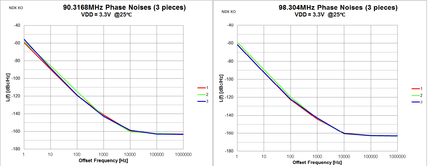

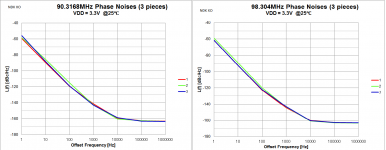

AKX9890NK Dual Sync Clock
Initial batch has arrived- 98.304MHz/90.3168MHz. Mounts in position X2
Doing some tests now. shipping soon...
NDK XOs have been updated. Dual matched pair in a single 9x14mm package with select. Typical performance as shown. ... You will need only a single unit of this Dual XO for the S03 board ...
