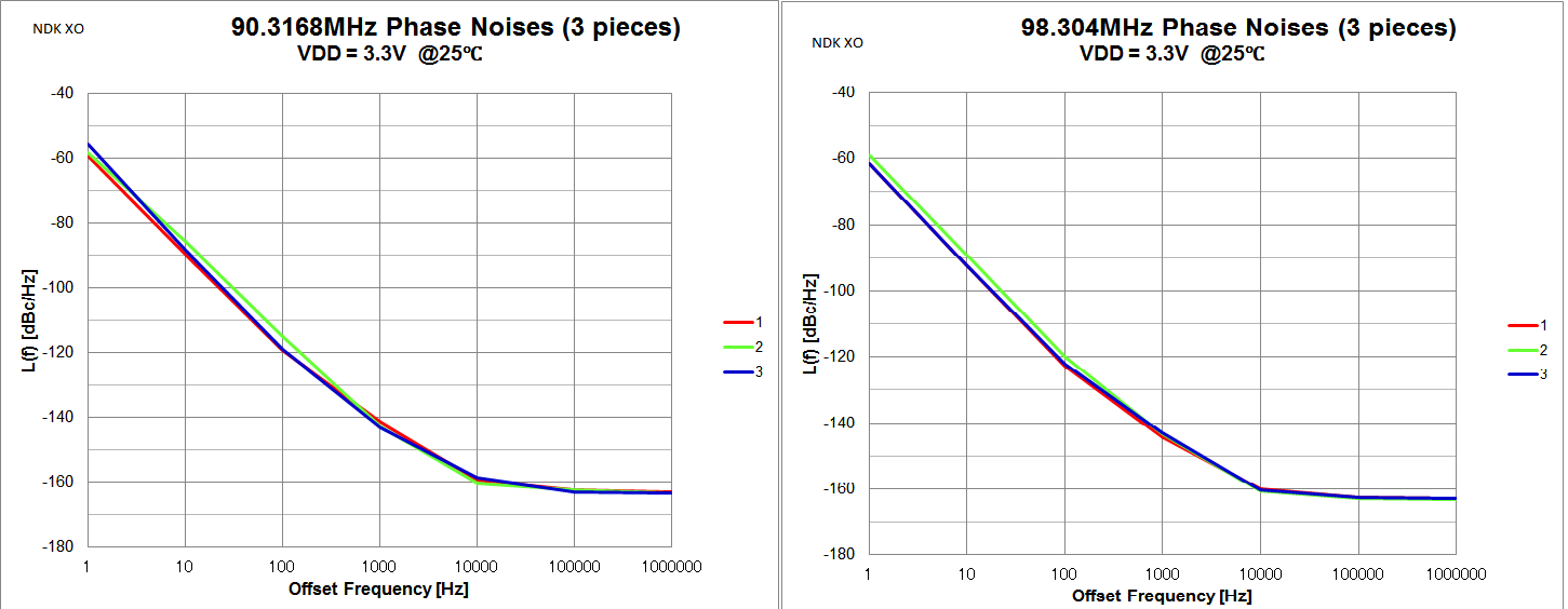

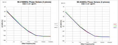

NDK Sync XO
NDK XOs have been updated. Dual matched pair in a single 9x14mm package with select. Typical performance as shown. Unit Price is $65. Min Qty: 50 pcs. You will need only a single unit of this Dual XO for the S03 board. Please check and update your requests accordingly.
