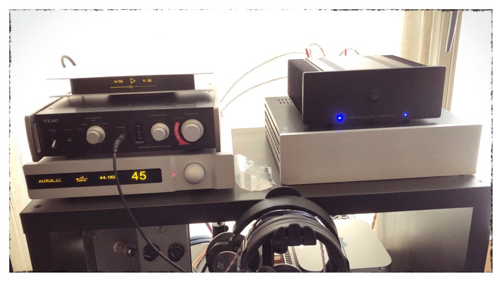

This comment resonated with me given my own experience.
I had each (of 2) ACA hooked up as an SE stereo amp and had it working fine.
Then I relocated them and connected them as monoblocks to my Freya pre via balanced interconnects and then ... nothing.
I double checked all the ins and outs and started scratching my head. Then I put my ear close to the speakers and sure enough, sound was getting through. So, then I just cranked up the volume on the Pre- ... all sorted.
The Freya comes with a 128 step, 0.625dB/step, stepped attenuator and it can take a while for the level to rise. I simply didn't have the gain from the Pre working hard enough. It was previously connected to an AB class with (comparatively) bucket loads of power and gain, so it was just a case of setting up for the new conditions. Had me worried for a little bit there but all good in the end.
I just have to remember to turn it down if/when the ACAs get changed out in future.

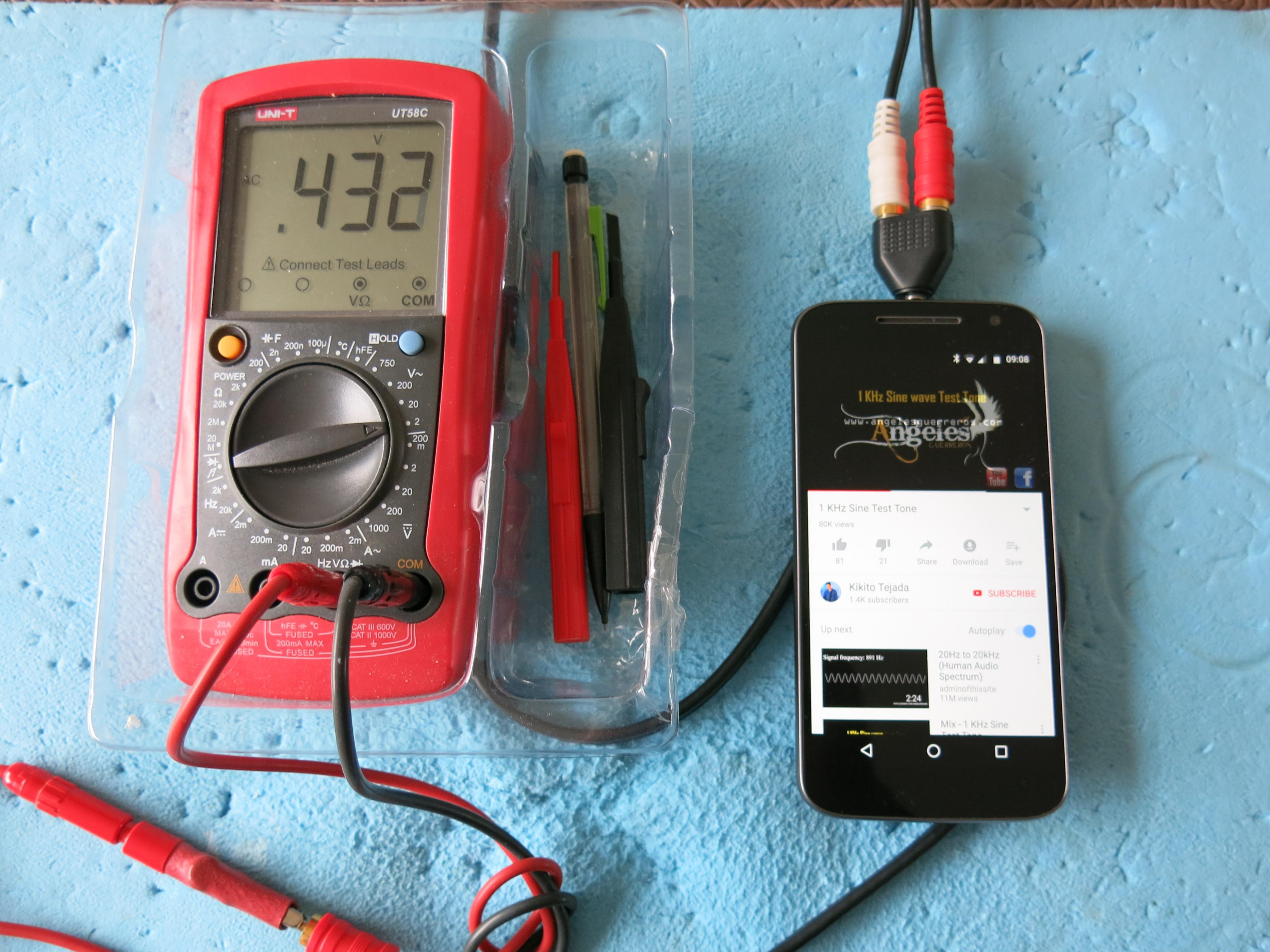

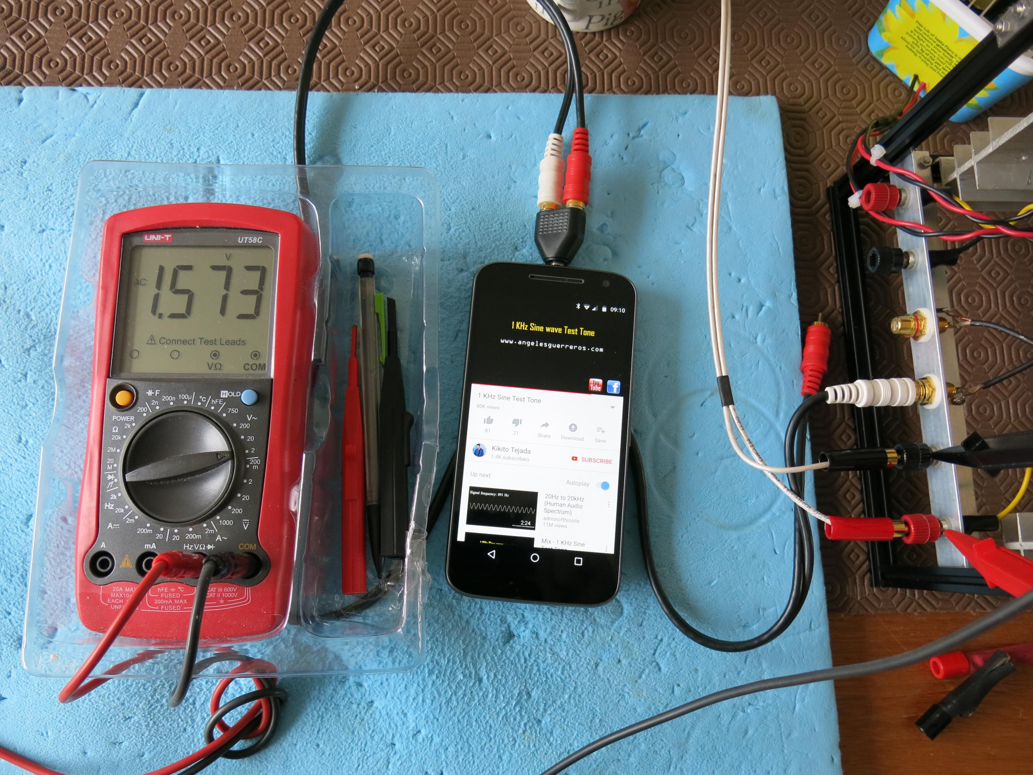

Here is a way to test your ACA is amplifying correctly. I just tried it on mine and this is what I did.
Used my mobile phone and went to this site for the 1 kilo Hertz test tone, it is a bit louder than some. YouTube
I turned my phone's volume to maximum and measured the AC voltage at the head phone socket playing the tone. Mine is 0.43 volts AC. Yours might be more or less, just note what it is.
Then I plugged the phone into my ACA and measured the output at the speaker terminals. (No speakers connected.) I get 1.622 volts AC.
If I connect my speaker (8 ohms) and measure I get 1.57 volts AC.
Again yours might be different just note it.
So on my amplifier for an input of 0.43v ac I get 1.57v ac out.
3.6 times amplification and you should get something similar if all is well.
Hope that helps.

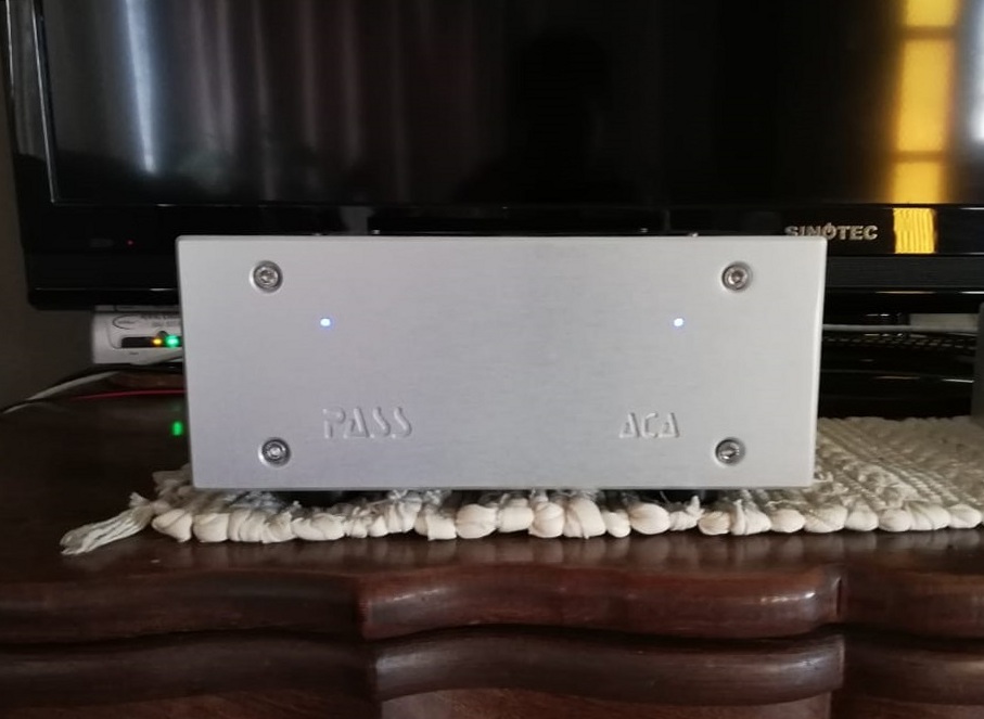

...wow those blue leds are bright.
Congratulations on getting it right first time.
If you don't like the bright LED's, you can swap them out for diffused LED's as well as higher value resistors.
Because I didn't feel like removing R13, I just added an additional resistor in series on one of the LED legs. IIRC it was something like 20K, which dims the LED suitably, but it's still bright enough for daytime visibility.
The picture doesn't show the soft blue color properly, but believe me it's a pleasing soft blue - not harsh on the eyes at all.
