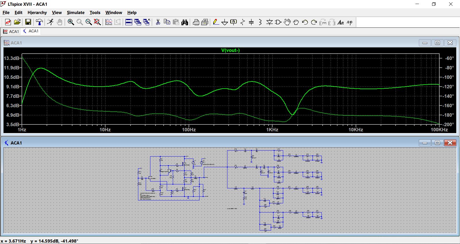

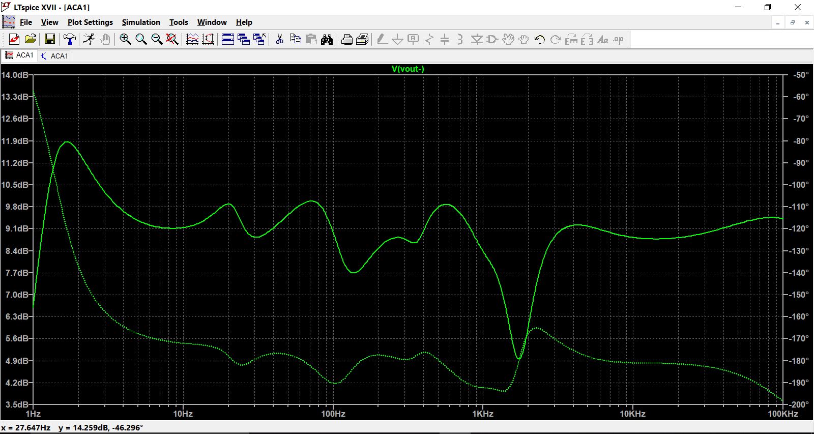

Interesting question. My B&W 703's also dip to around 3 ohm. This shows the output of the ACA into a such a speaker model.
- Amp Camp Amp - ACA
