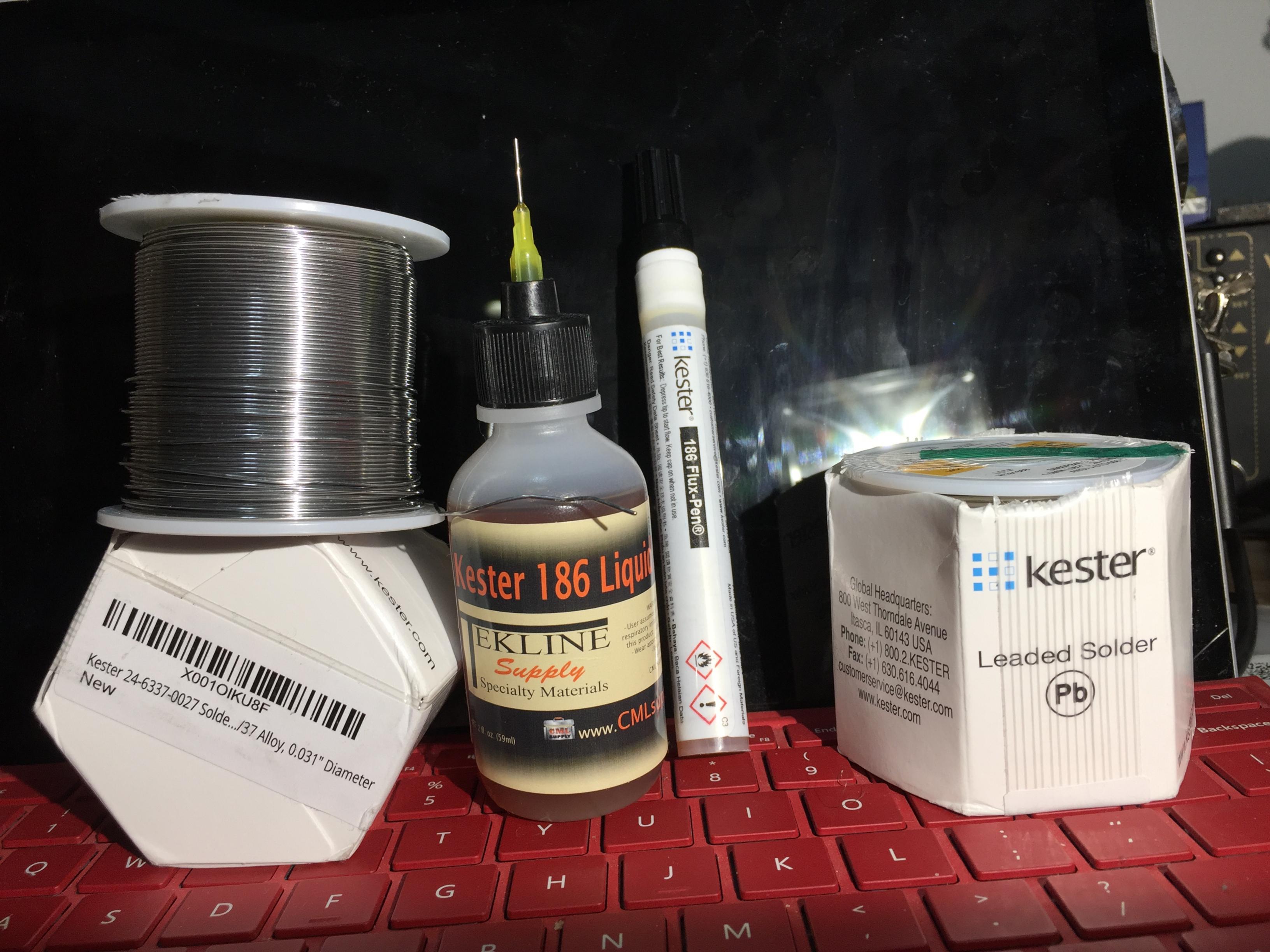

Snake oil solder Only get the good stuff
My solder was purchased from a slick talking salesman who rode into town on a shiny high polished wagon in the middle of the night . He said it was mind by virgins on an island and only melted down in poured on a full moon night quenched in high mountain artesian well waters to be annealed and finally polished with Corinthian leather . He said I would make my Amp Camp Amp project sonic qualities exceed that of the highest end McIntosh equipment it would make my Amp Camp Amp in comparison a Krill amplifier would sound like a class D Chinese made amplifier . He had papers to prove it printed on heavyweight high-gloss colored pamphlets with OSI 9000 certified tested by third-party laboratories with a frequency range extending from 1Hz past 100,000 Hz and a db rating exceeding 110db.
In all seriousness for us newbies including myself I will be throwing away my 20-year-old 60/40 Rozen for solder in my electric solder sold by BrazelOMatic from a large box store Home Depot and my free sample of leadfree solder was the most horrible stuff I’ve ever tried to use after the second resistor I gave up and tore them out and threw away that garbage never let anybody use leadfree solder . Friends don’t let friends solder lead free. Clean your boards off with alcohol you some flex on your boards or your component leads and high-quality Sauter makes life beautiful in your work and your peace of mind .
PS. Special thanks to the Mighty Zen Mod criticize constructively my soldering work in a previous post and it made me go out and research and watch the past 70 years of soldering videos from the 1940s to present day to up my soldering abilities.
No oil residue, it must be removed.
Are you talking about rosin? I don't believe rosin MUST be removed. It is removed just for aesthetics.
Aah, that’s where the salesman went wrong!quenched... to be annealed
No, he's talking about 'snake oil' from the possible better sounding Silver solder. Bottom line, it's a joke (and a good one! )Are you talking about rosin? I don't believe rosin MUST be removed. It is removed just for aesthetics.

Eutectic solder (Sn63/Pb37) melts at a lower temperature than regular solder. I does cost more as it needs to be made with accurate proportions. Add a bit of silver (Sn62/Pb36/Ag2) and this temperature drops a bit more. Once again the price goes up. I like the low temperature melting so I get the 62/36/2.
