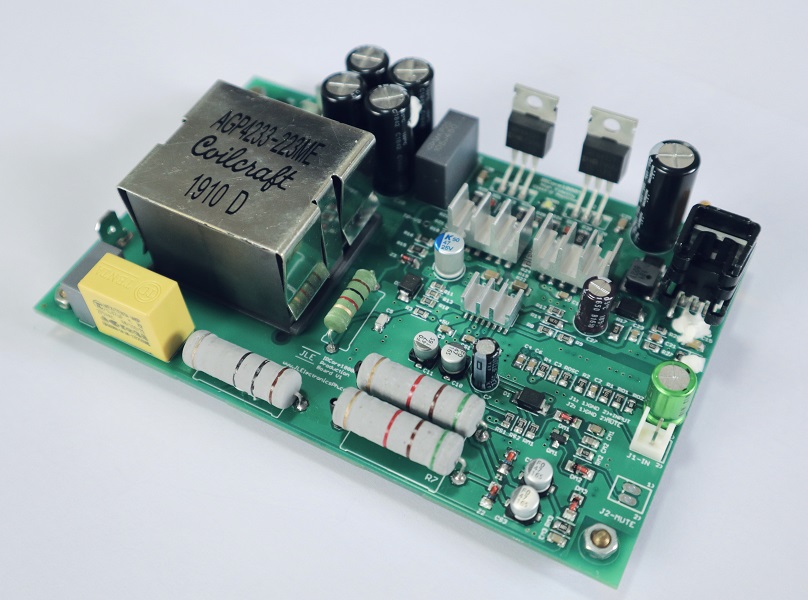

New Product and Product Updates
Updates
Changed back JLA-250D to VER2923-223KL inductor.
(JLA-250D has sold over hundreds already because of failed class-d amps of velodyne subwoofers)
Changed IRCore1000M output inductor to AGP4233-223ME
I designed the PCBs of JLA-250D and IRCore1000M such that they can accommodate different inductors.

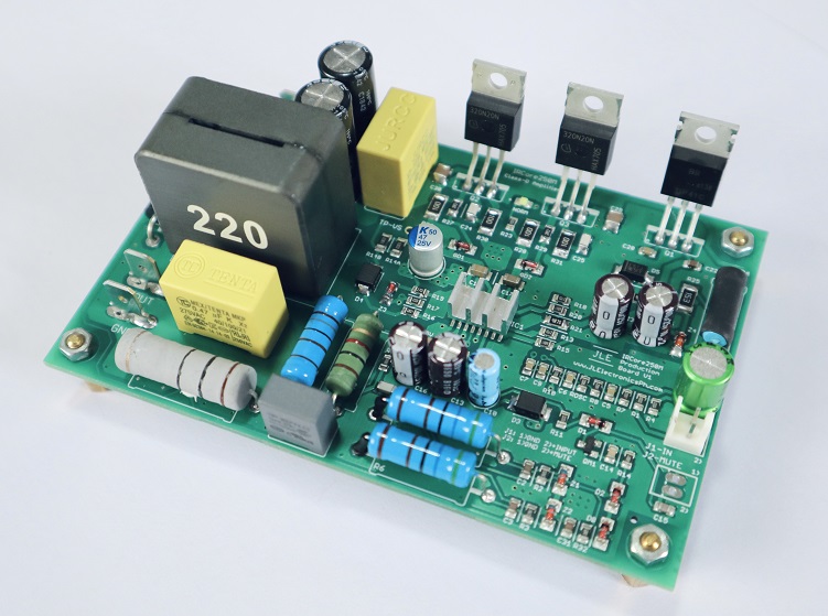

New Product
IRCore250M
- +/-75V Rails
- Small form factor and can fit most plate amps.
- Uses 31A inductor and IPP320N20N3 output mosfets
- 300W 8 ohms, 500W 4 ohms, 800W 2 ohms (2 ohms load, burst 10 seconds)

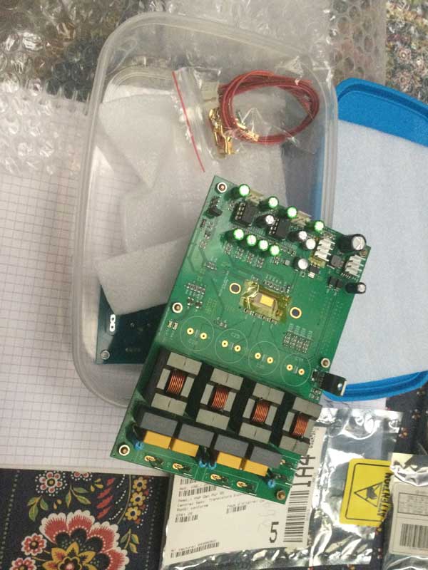

Those partially assembled modules are already tested so it should run goodHello
JLester's card has been singing for 1 hour, no problem encountered
Best regards
Bobo
Each module is essentially a fully assembled module because it is tested with complete parts and then disassembled and desoldered before shipping.
Can your DAC /pre provide enough juice? If you are using single ended source, you can change RA3, RB3 to 4.7K 0603 resistors. It will double the buffer gain so that you'll only need 1.4V rms input to drive it into full power.
