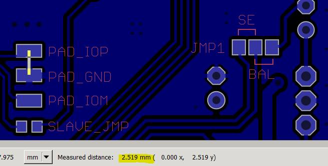

Thanks, do you have a PCB drawing and/or pad sizes for these?For 1) There are solder pads under the PCB for osc_iop and osc_iom as well as DVDD jumper on freq_adj pin.

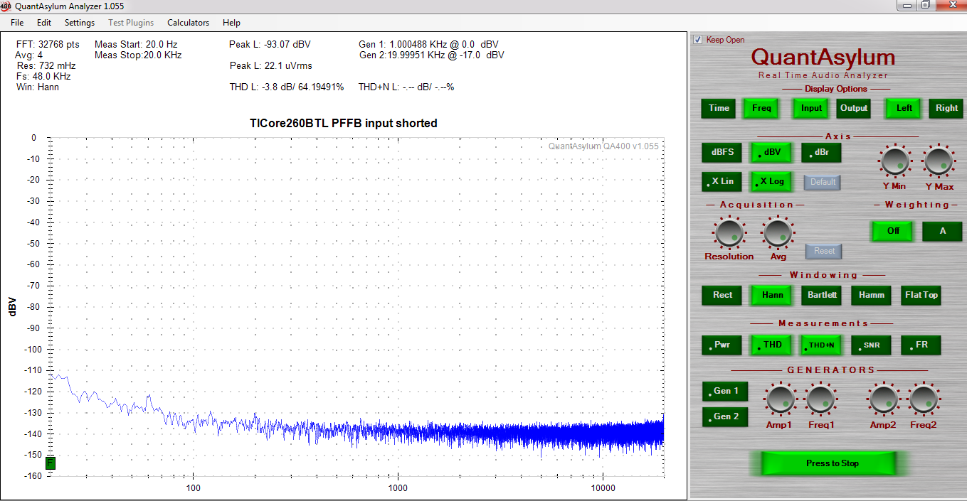

What is the integrated noise? I didn't see the spec on the product page.For 2, 4, and 6) I only measured THD+N on 1W, 5W, and 10W at 8 ohms load. As well as output integrated noise (inputs shorted without A-Weighting). Also tried 6.67kHz at 20W (20khz bandwidth) just to verify if it is really within spec, result is just a small blip on second harmonic. I got < 0.003% THD+N, but wasn't able to capture screenshot.

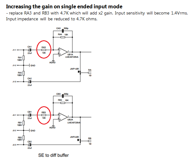

Oh! Another question: is there a way to increase the onboard gain by easily swapping resistors? For the people who have sources between 1.5 V to 2 V max output.
Attached PCB drawing of IOM/IOP pads. Pitch is around 2.5mm
Attached integrated noise, the speaker out is connected to a sound card interface with -6dB gain so probably it's around 44uVrms. I will setup a new test for this to confirm.

For single ended, yes. The input section is the same as EVM. (attached screenshot)Oh! Another question: is there a way to increase the onboard gain by easily swapping resistors? For the people who have sources between 1.5 V to 2 V max output.

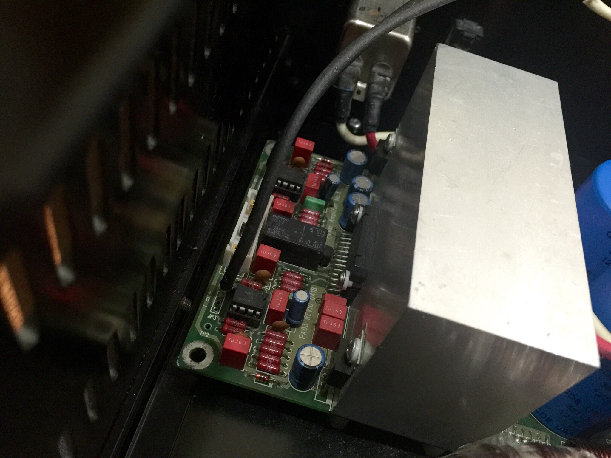

This is p3a amplifier beautifully built by one of the members of this forum and it uses a large aluminum block .

I think I will just create a power amp with balanced input. I will change the resistors to 6.8K ohm (0.05% 0603 SMT) so that 2Vrms signals can drive the amp into full power.

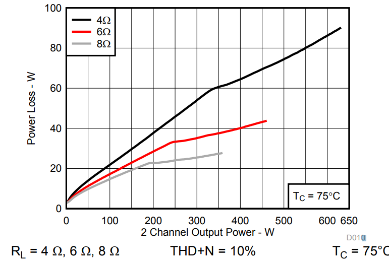

Since Amir is running the amp with both channels into full power for several minutes, TPA3255 with 48~51V cannot handle the heat dissipation using just the EVM heatsink. So our main concern here is the continuous full power dissipation. (Maybe that's why there are no TPA3255 reviews yet in ASR) I'm also doubting the AP measurements of 3eaudio TPA3255, their graphs look like they measured the amp with PFFB, plots are strikingly similar.

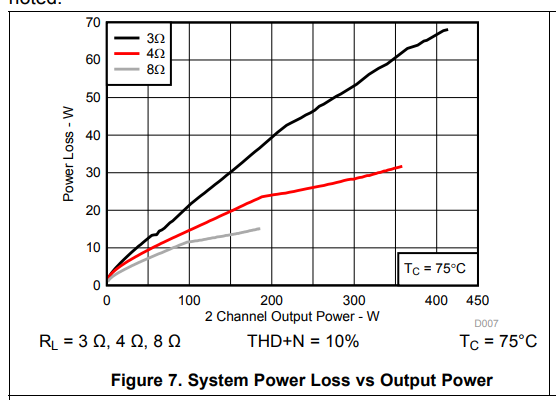

I will reduce the power supply to 36V so that the power loss will be lower. Then configure the PFFB to 36V TPA3251.
With 36V supply, based on TPA3251 system power loss graph, the chip will only dissipate 24W at 200W 4 ohms output.
So the chip can sustain output of 100W/ch or a total of 200W @ 4 ohms indefinitely (25 deg C ambient) with ATS-TI1OP-519-C1-R3 and some air cooling.
