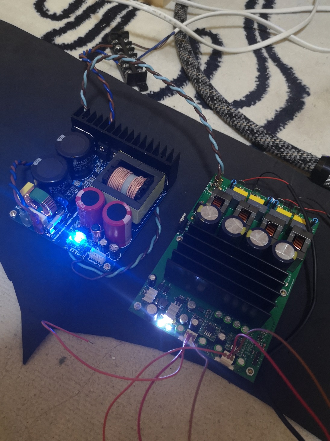

For those who have a balanced line driver, you can remove the opamps and tap pin 1 for +in, pin 4 for gnd, and pin 7 for -in.
Do not use IC socket because it has a thick rounded pins, it will make the holes of the IC socket larger, if you put opamp afterwards it will feel loose. Use thinner rounded pins instead (picture 2).
Looking good. What opamp did you use? You may 'shorten' the wires of female connector and solder connect 3 core shielded wire so that noise floor will be maintained.
I am using the LME49860. Yes, I will need to tidy things up once I place them in a proper chassis. They are not housed in a chassis now. The Connex SMPS and amp board is fired up and hooked up to 2 tiny computer speakers for testing and burning in while waiting for the chassis to reach me. I am not actually listening to it in my actual set up yet. I believe the amp will sound good, given the nice layout of your board.
Thanks for the trust!
