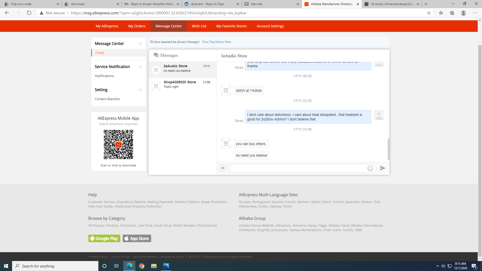

Not trying to defend the seller but the tone of your chat is provocative. You will just both lose your time and energy if you will continue the conversation. Store's admin looks unprofessional.
Indeed,
my choice of words in the last sentence I posted there was not the best but I kind of got frustrated because he was avoiding to provide some answers.
