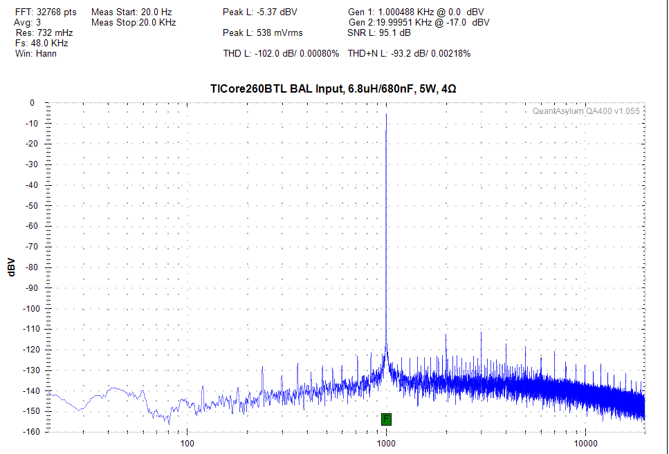

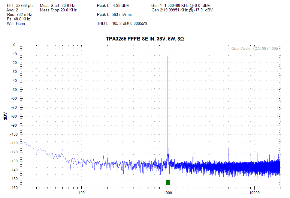

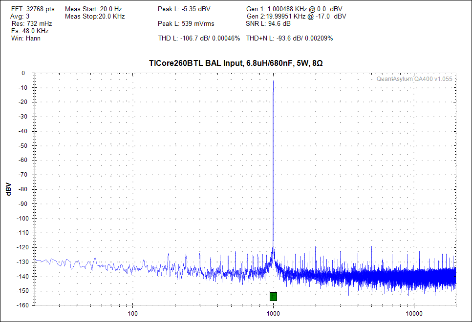

It's weird, I'm getting better measurements on 450kHz + 10uH inductors (in orig module, no modifications).
Attached 5W at 8 ohms 0.0005% THD, I removed THD+N because noise floor of my QA400+interface setup is unreliable.
5W at 4 ohms is 0.002%, so I'm expecting 95dB SINAD only.
5th harmonic on my qa400 + interface setup is naturally high even without DUT.

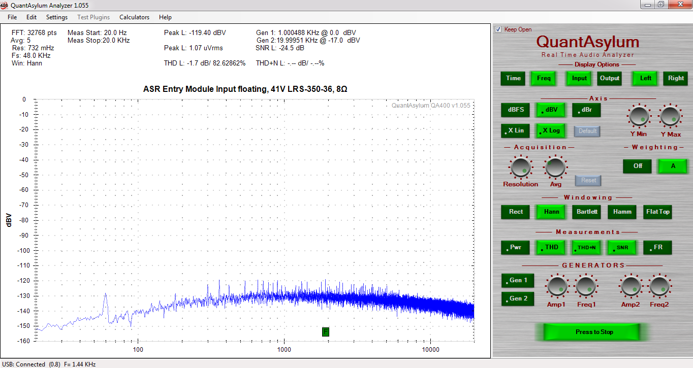

Alright, I found out the culprit of inconsistent and poor THD measurements.
When the opamp of my soundcard interface is heating up, I'm getting higher THD.
When the opamp is cool, I'm getting the best measurements.
So I cooled down the opamp of my soundcard interface, the result of my 'ASR' entry module at 5W, 4Ω is 0.0008% !!!
If the noise floor is good, this will get around ~101dB SINAD.
If the noise floor is more or less the same, I assume the module will get 0.0017% THD+N or 95dB SINAD.
