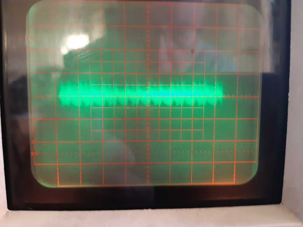

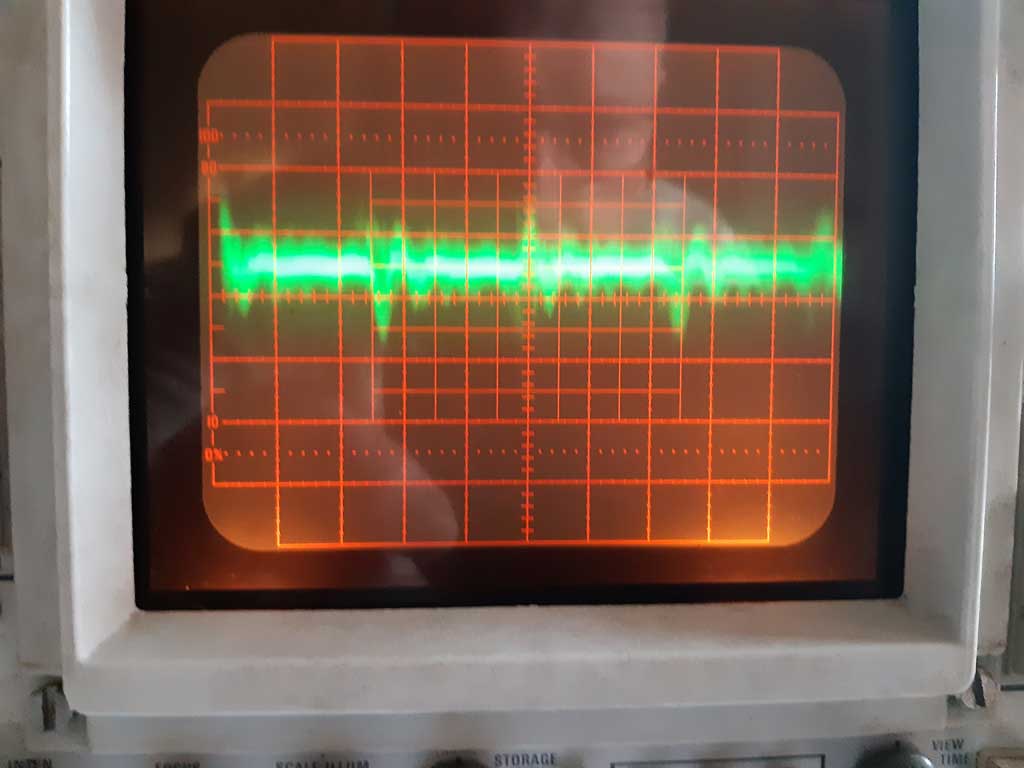

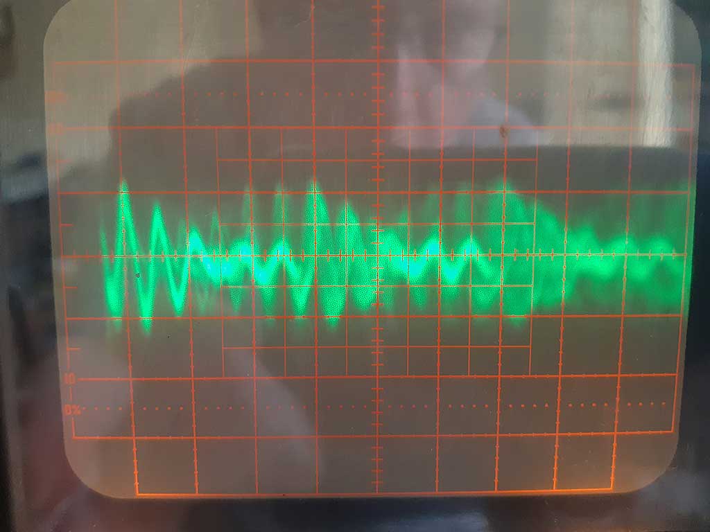

I went from a lrs350 power supply to a Connex 300rs power supply, minimum mains connector ditto aux power supply, only positive point the dimensions of the 10cm * 10cm card and aux power supply, listening big disappointment, sound without dynamics, workshop direction, to the oscilloscope, the HF residue and peaks, change capa 2200uF / 63v by Nichicon HW, the same as on the TPA card, only a small HF residue remains, listening I find the sound with the lrs350, to hear in a few days

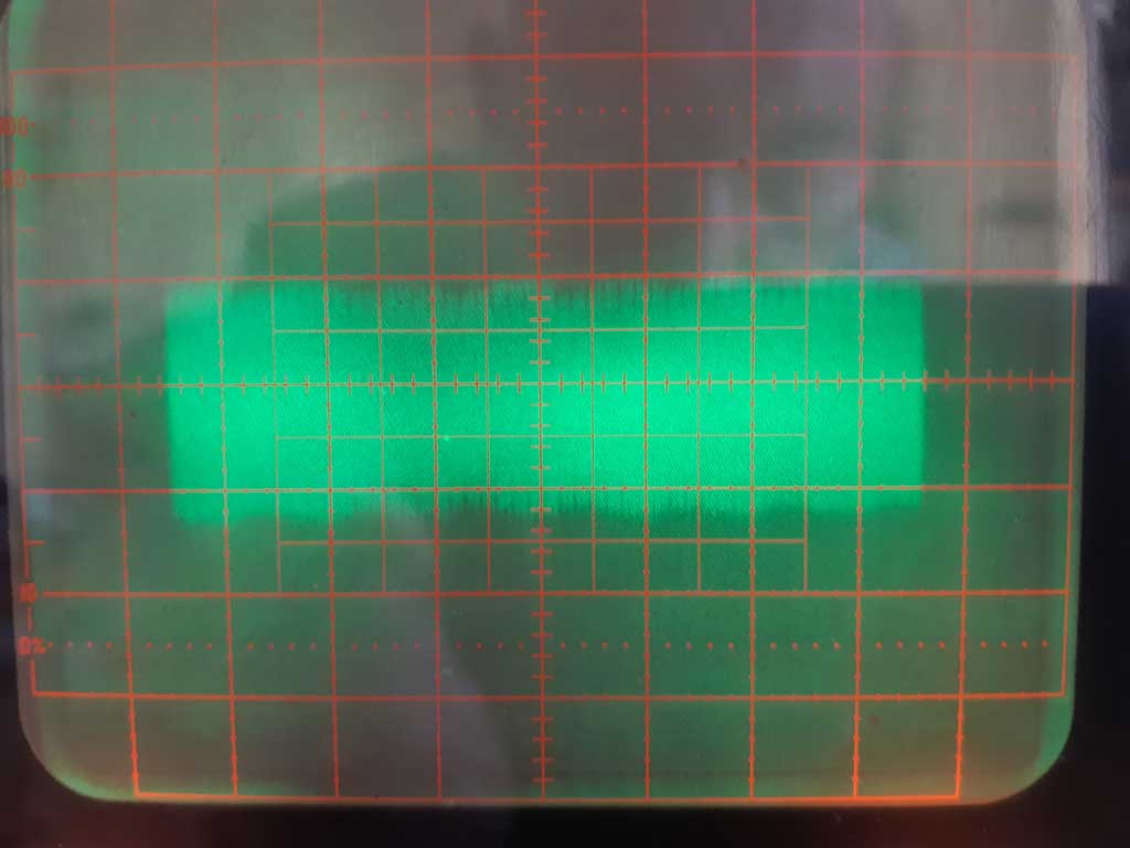

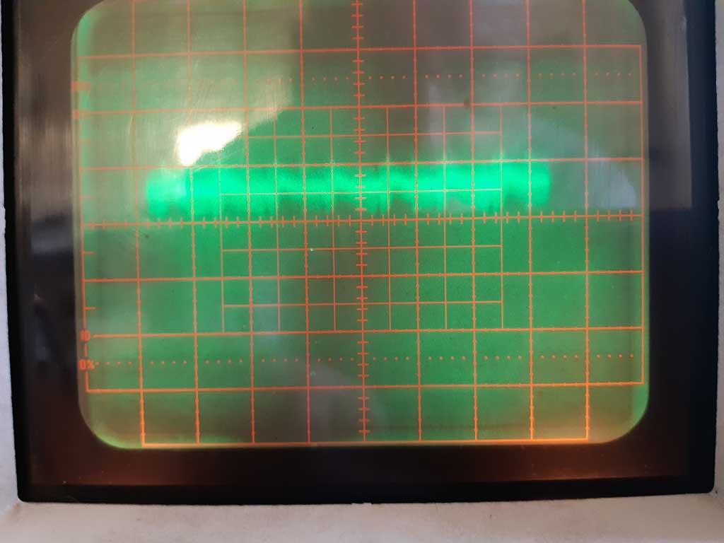

Hello
Test of noise
MW LRS350 36V / Connex smps300rs48V (with 2*UHW1J222MHD 2200uF/63V)
The two power supplies are charged by a 220 Ohm resistor
LRS set to 40V
smps300RS on 46V
LRS
LRS 0.2V 5uS
LRS 0.2V 20mS
Connex
0.2V 20mS
0.2V 10mS
0.1V 1uS
The Connex output capas have been changed, I no longer have any data with the original condos (2*Samxon LP 2200uF / 63V)
The sound is now very good with the two power supplies
Thanks JLester
Best regards
Bobo

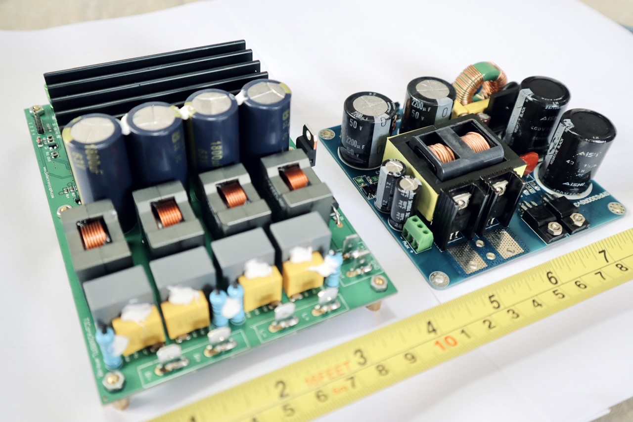

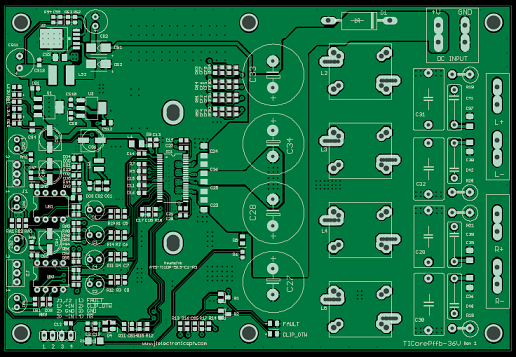

TPA325X 36V PFFB Budget Version
Budget version of TPA325X post filter feedback that will run on 36V and will defeat many expensive systems.
ETA is mid January, 2021
Specs
Target SINAD @ 5W 4ohms = 95dB, or 0.002% THD+N
36V PFFB Mode = TPA3250
Dimensions = 147 x 100 x 40mm
Output inductors = Codaca 17A (PCB can still accomodate VER2923-103KL)
Tank capacitors = Lelon or Samyoung 1200uF
Main Chip = TPA3251 running as TPA3250
Heatsink = 100 x 30 x 30mm
Opamp buffers = LM4562NA
Features removed from TICore260BTL to lower down cost
- removed SCR transient overvoltage protect
- removed ENIG gold plated surface finish
- replaced TLS205B0 with LM2940 (same as EVM)
- replaced opamp decoupling electrolytics with SMT type
- replaced with TPA3251
Attached picture of what the end product will exactly look like:

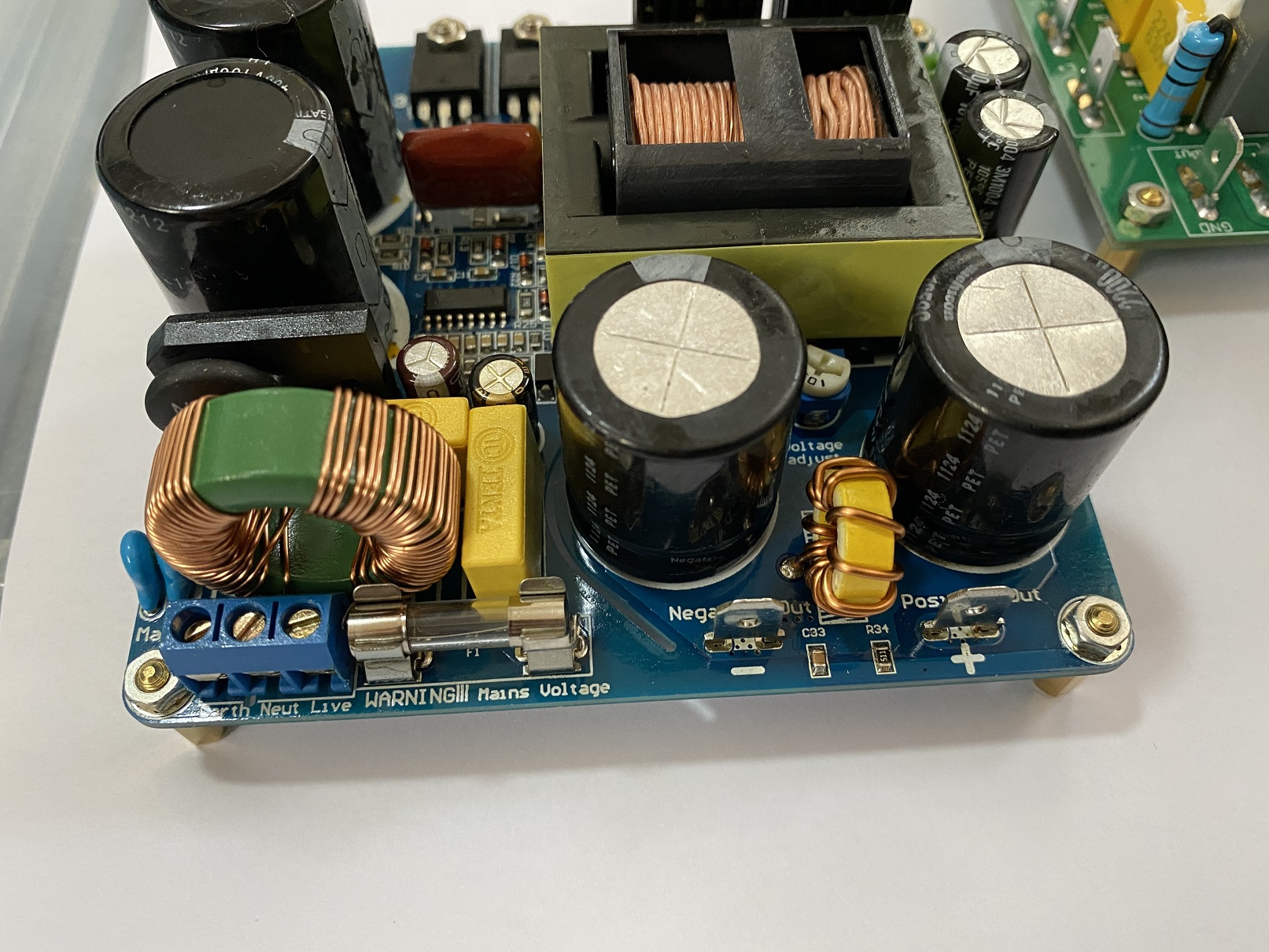

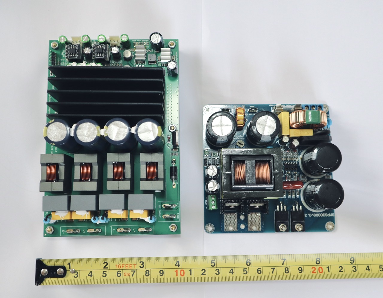

Regarding SMPS300RS, I think the negative out terminal is too close to AC fuse, I'm afraid it might pickup some interferences. I'm also losing confidence on the 5mm pitch AC terminal.
Also they've dipped the whole board in insulating varnish / conformal coating bath, so the terminals including the faston tabs are now insulated
lol. I have to replace all terminals and fuse holder, good thing I have all the parts here.
Primary side cap Aishi 100uF 400V, 22mm diameter, 10mm lead spacing.
Secondary side cap is Nichicon 2200uF 50V, 22mm diameter, 10mm lead spacing.
D
Deleted member 148505
Change the caps Lester, maybe the nichicon is good but it's not standard audio cap (and Aishi is a cheapest brand)
You can put large 25mm caps for both I think
Yes I will change it, it has the same performance as meanwell on my soundcard THD measurements.
Also on balanced mode I can't lower down the THD even if I'm using 6.8uH coilcraft VER2923. Possibly the problem is limitation on my setup rather than the module itself. Good side about balanced input is that the 'even harmonics' are dominant., on SE the 2nd and 3rd Harmonics are almost equal.
