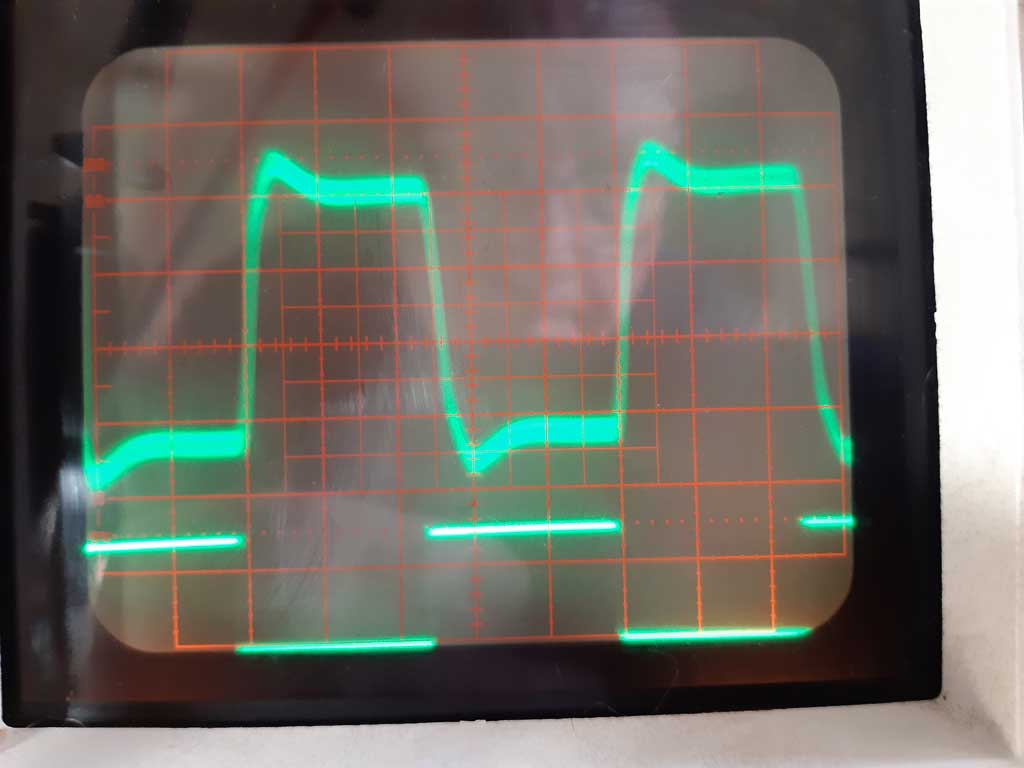

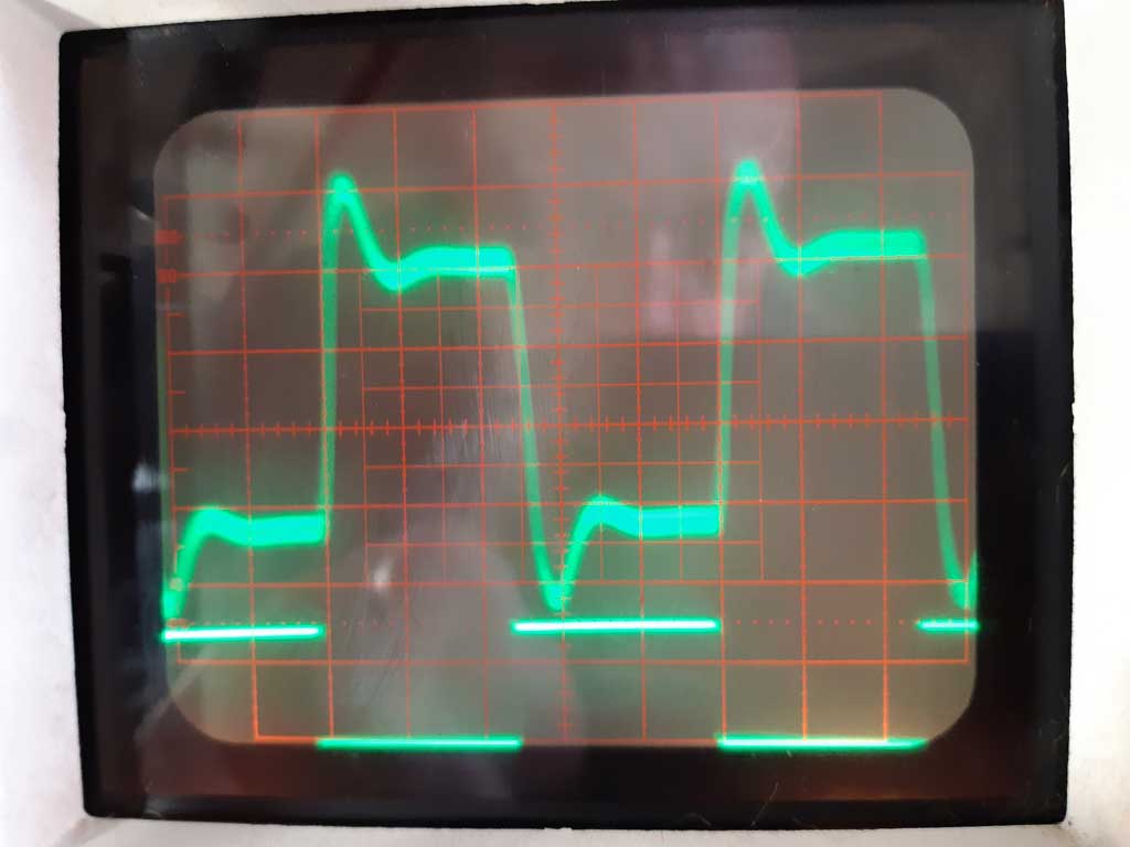

Hello
Aop input / output with 330pF 10kHz
Best regards
Roger
Output of opamp or the amp module?
At the 4 Ohm and 8 Ohm output whatever the 0 or 330pF capa, photo at 10kHz ( the 450kHz residue is about 1.08V c / c 0.76 rms)
Best regards
Roger
330pF feedback caps were removed in those measurements? If yes, then our amp is stable

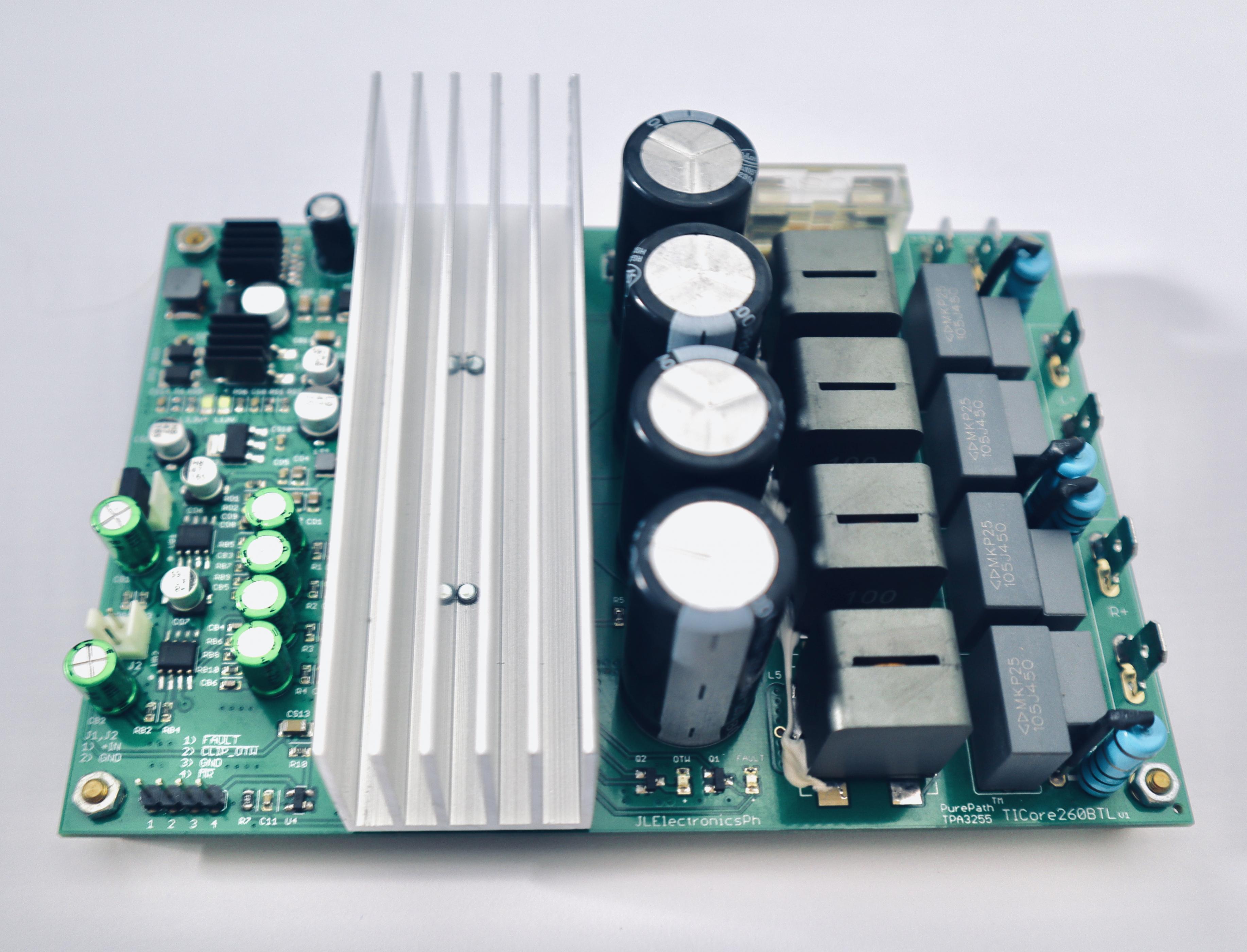

Just got my V1 board in my system. Did the C17 mod and also removed those tiny opamp bypass caps.
Running as supplied with Silmics all round and the LME49860.
Slightly different setup than before using my 3e board in that I have built a LT4320 based rectifier. I now get just under 51v...up from 48v with the previous monolithic bridge rectifier. The JLE amp is cooler at 51v than the 3e was at 48v. The inductors noticeably so.
Listening commences now but for the short half hour it's been on I have no concerns at all! Sounds very good

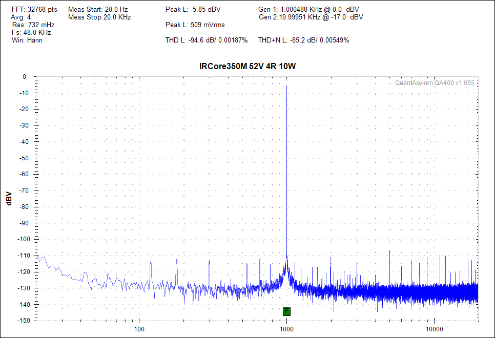

This is the performance of my very first TPA3255, (1st iteration module Jan 26, 2020) . I'm only using LM317 as 12V regulator and NE5532 SOIC-8 buffer opamps.
FFT is not properly labeled (IRCore350M lol) Signal is attenuated to 500mVrms (greater than that and the QA400 input will saturate)
At 4 ohms 10W output, notice that the second and third harmonics are just around -110dBV. Though the fifth harmonic is high..
Because of LM317, Noise floor is not optimal so THD+N performance is just average.
I believe that this is the 'typical' performance of TPA3255.
