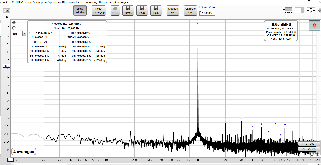

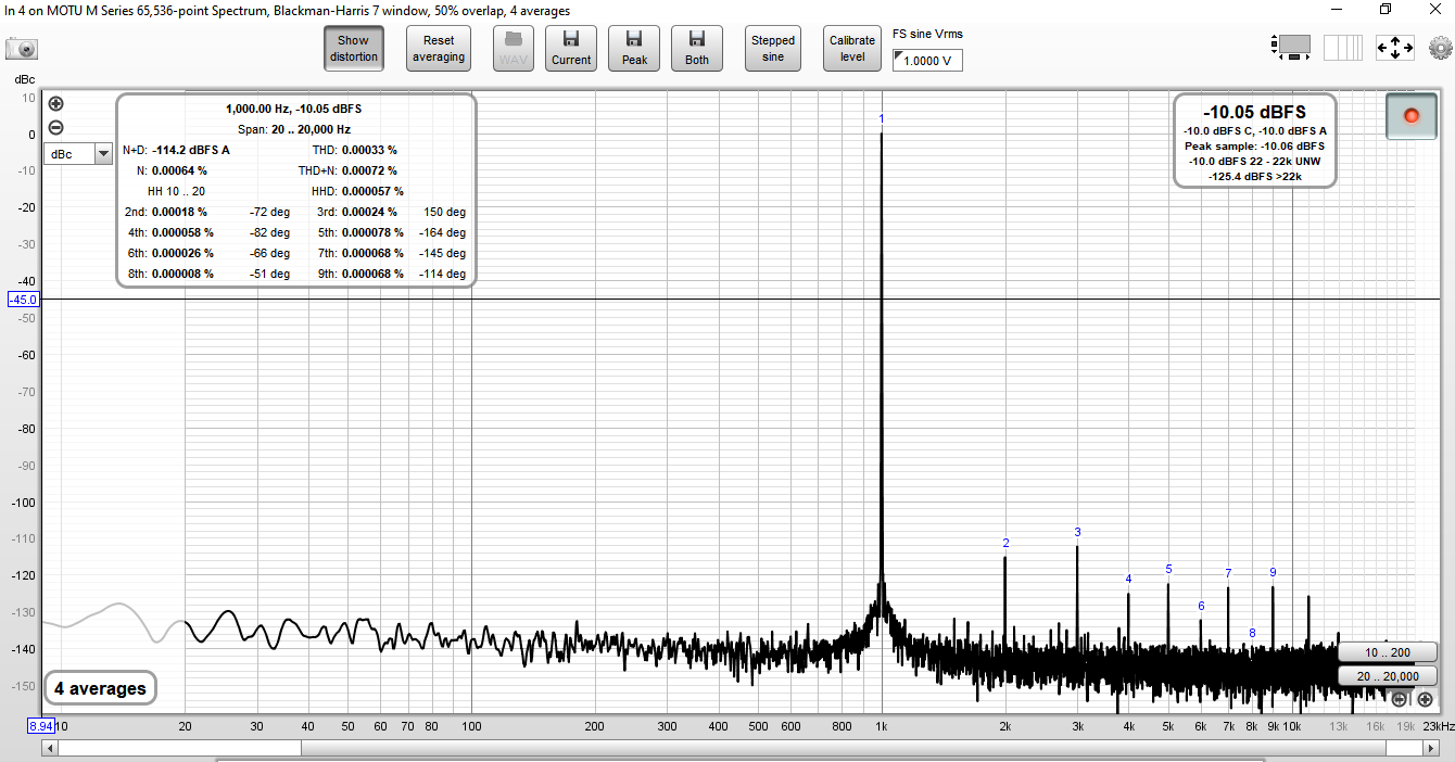

soundcard interface prototype development
I'm currently improving my JLE interface (similar functionality to pete millet's interface but without the RMS voltmeter)
My interface prototype uses INA1651 and OPA1656 and I'm currently using it to measure my Sylph-D200.
First pic Motu M4 loopback (SE)
Second pic Motu M4 + JLE Interface loopback (SE).
Slight loss on the output signal (due to input impedance). Only slight degradation on THD+N!
Problem is that the results are good because the input and output diode protections are removed, If I put them back, the loopback THD+N will become worse (+6dB). So I'm currently looking for input and output protection methods.
Motu M4 uses TPD2E007 for each terminals, i will look for similar methods.

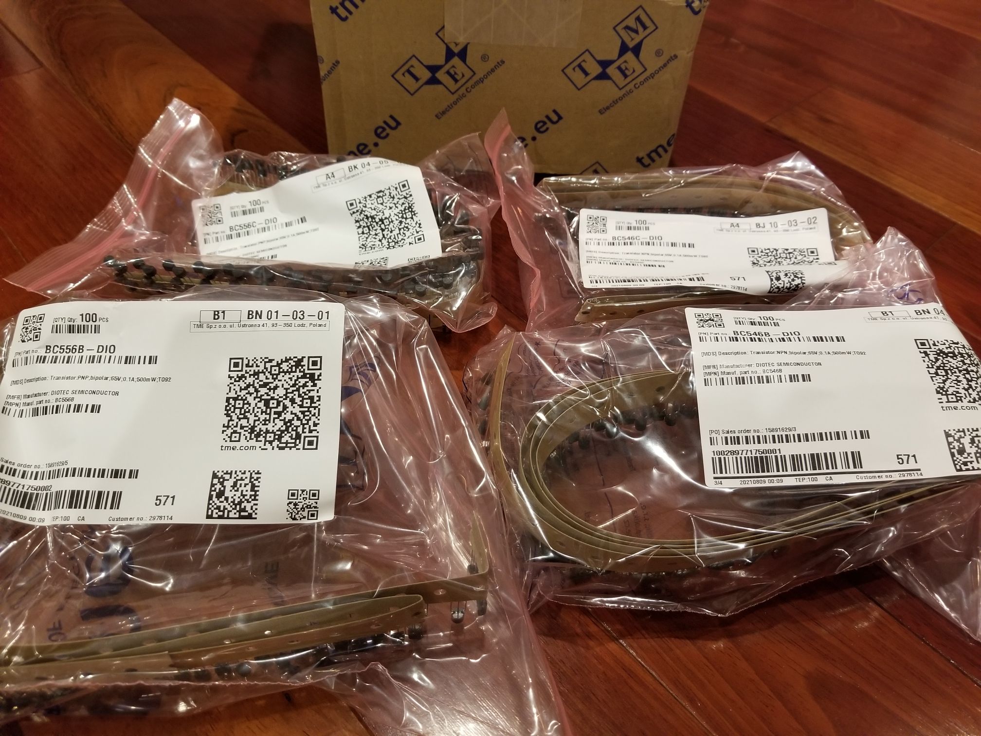

The Diotec BC546B, 546C, 556B and 556C transistors I ordered from Poland showed up today.
All I need are the SKA GB150D boards now...![]()
Nice, shipping may take up to 6 weeks to Canada.
