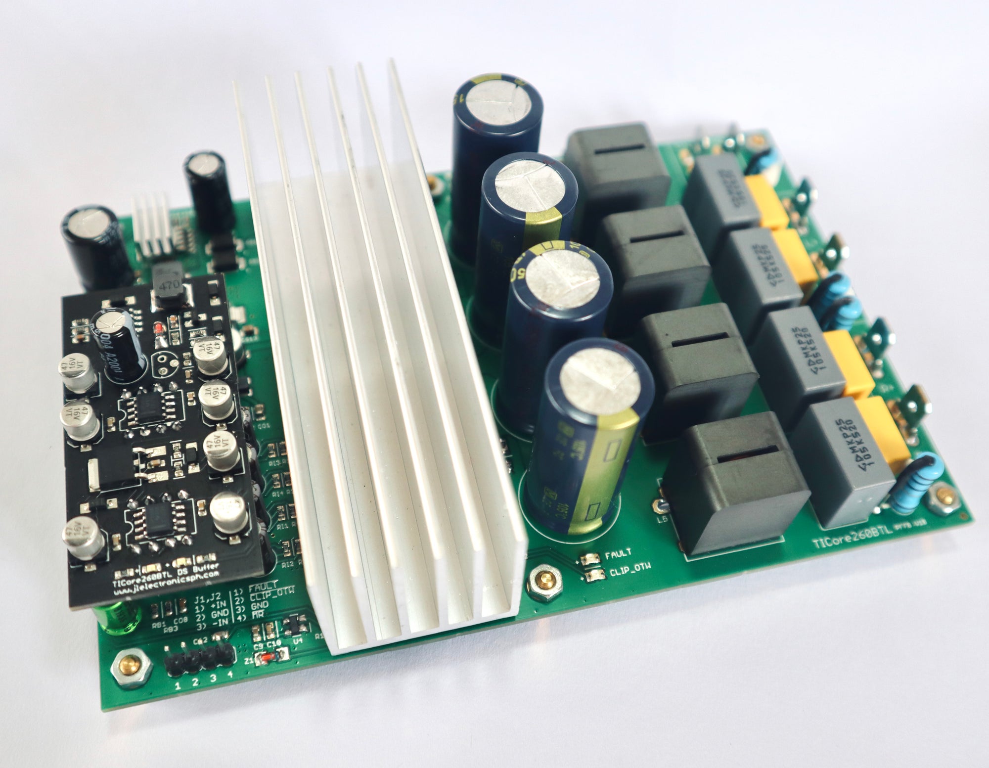

For TPA3251 lovers, TICore260BTL 36V supply with daughtercard can now be pre-ordered. Ship out date is on July 5.

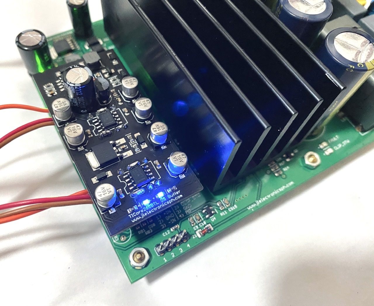

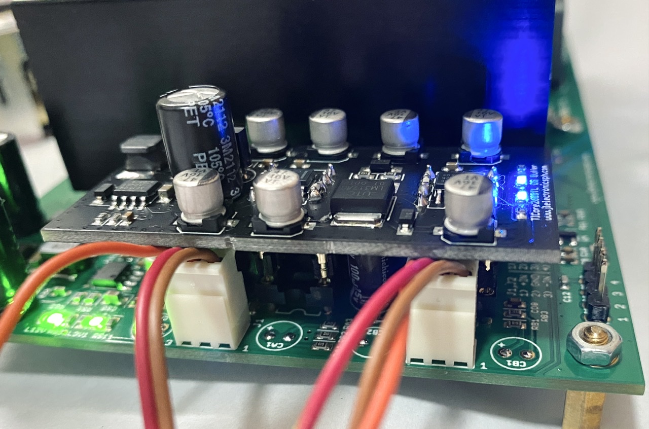

Here’s your daughtercard with gain. Currently testing it with PFFB.
All electro caps in the daughtercard are for the dual power supply only.

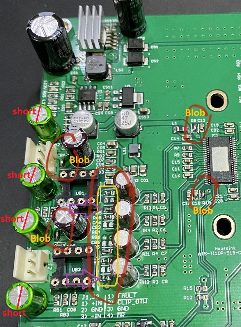

Oh no I think I forgot to include 27K 0603, is it there in the package?
For modifications, short out the input coupling caps. Then put solder blob on encircled parts.
If you want to retain the unity gain, no other changes are needed. (you can try JimK04 daughtercard with unity gain for testing)
Since your daughtercard has gain=2.7, you need to remove all 0603 parts inside the yellow rectangle.
Then put 27K 0603 on RA5, RB5 (purple arrow on the attached pic)

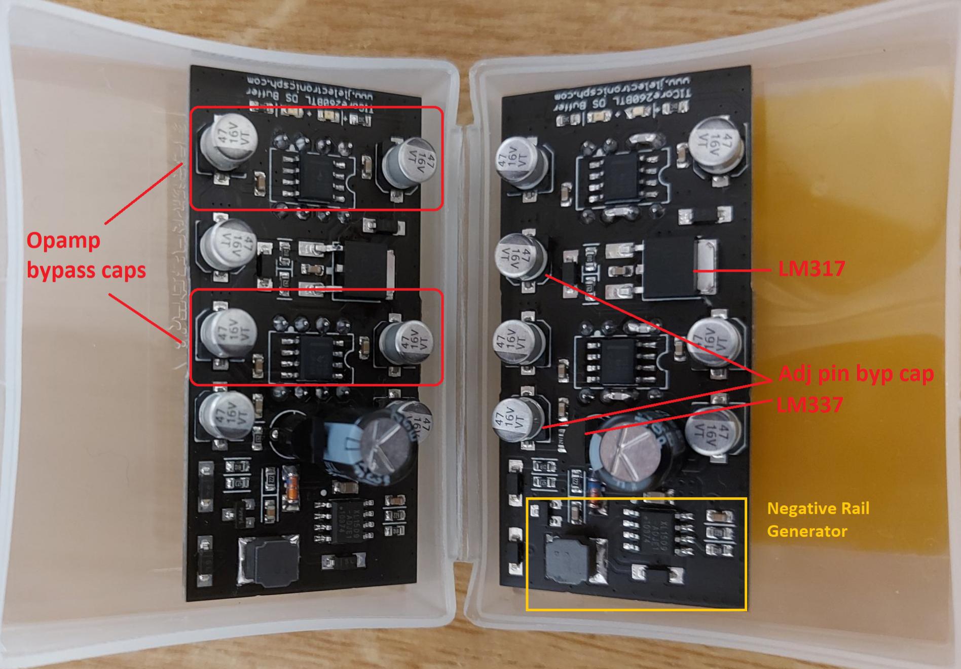

How do I know which is the high-gain daughterboard? I'm guessing the one on the right with the additional components around the opamp socket pins?

Yes correct, high gain board is the one with resistors || capacitors on feedback pins.
You need to open all the packages and sort them out. Thanks!

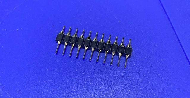

Also, I provided adapter round pins to attach the daughtercard to the mainboard. The long thin rounded pins should go to the mainboard side, the short thick rounded pins should be inserted on the daughtercard side.
BTW, since the release of Sylph-d200 we're now using opamp adapter pins that are thinner, we discarded the ones with thicker pins as they are making the socket holes larger.

The daughtercard is very simple. I just added a negative rail generator to provide -8.5V. Then I used LM317 to drop the voltage to +6V and LM337 to drop the voltage to -6V.
Then same pinout as the original, except that now the opamps are using +/-6V DC supply.

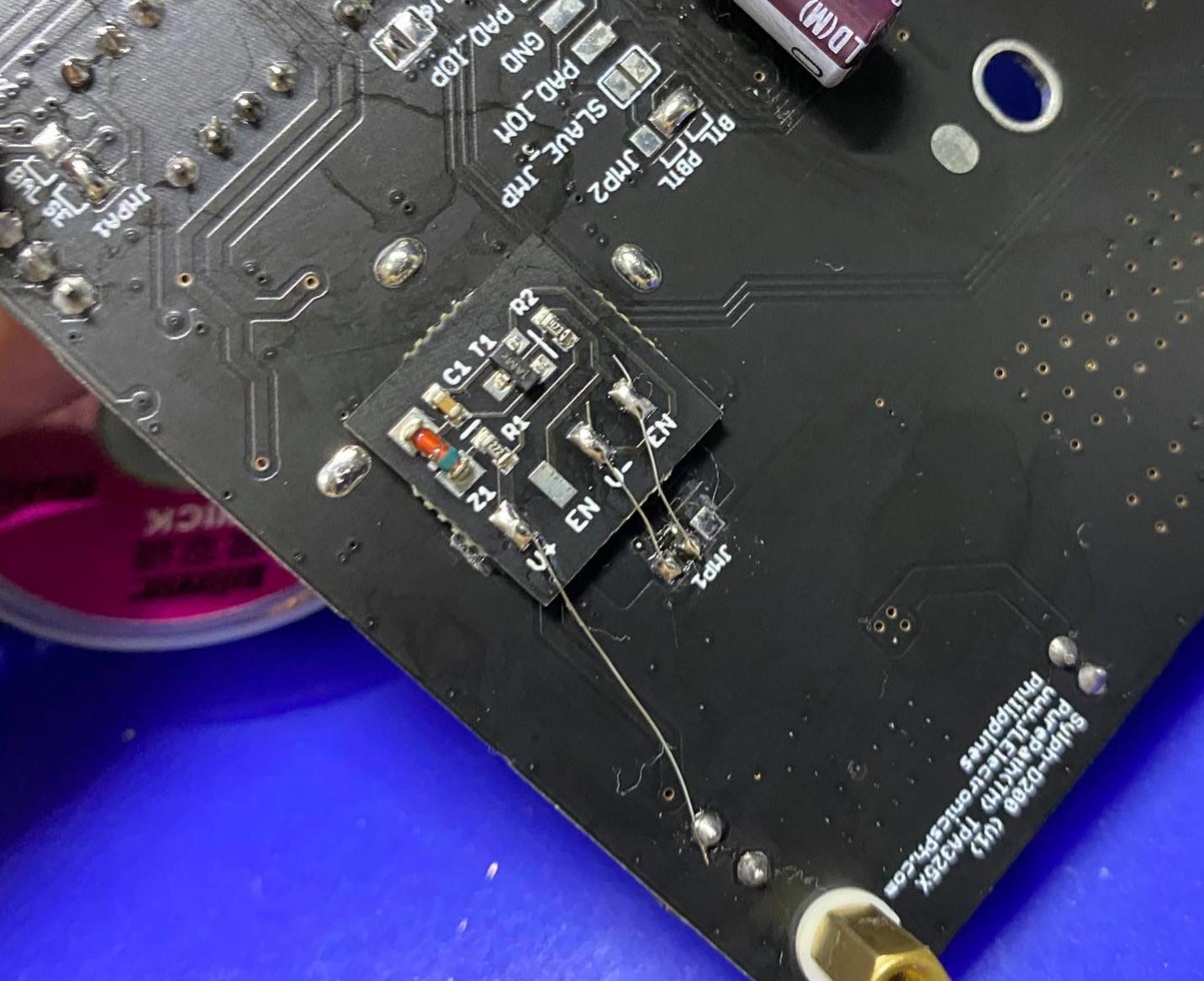

Hi guys. Just back from a few days away and the package from Ray is here. Thankyou. I have 2 slow ramp fix boards so I need to send one to stretcheck....if you let me have your address I'll sort that.
So to add this to D200v1 there are no trace cuts, just follow the photo...
D
Deleted member 148505
Hi jimk04, and others with Sylph-D200 V1 board.
We have placed white goo in that place, only EN middle trace is currently exposed.
Please be extra careful in peeling off the white thermal glue as it may peel off the traces. You need to cut the white goo in a crisscross pattern with a blade before scratching it with a finger.
Also if you haven't acquired the output inductors, using 6.8uH VER2923-682KL / AGP2923-682KL will produce smoother highs when PFFB is disabled.
But when PFFB is enabled, both 10uH and 6.8uH will have the same sound, the quality of output cap will determine which one will be better.
Lester
