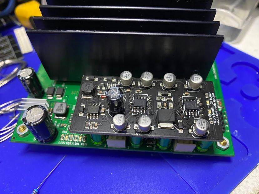

Not sure what version of the amp I got from you, but is this buffer board applicable to your earlier amp?Dual Supply Buffer for TICore260BTL is now ready for manufacturing
Uses SOIC-8 dual opamps like OPA1656.
Modification on the main TICore260BTL board: Just short out 4 electro input coupling caps.

Hi Tan,
Yes it is applicable. I forgot to mention though that we need right angle connectors for the inputs as the board will block them.

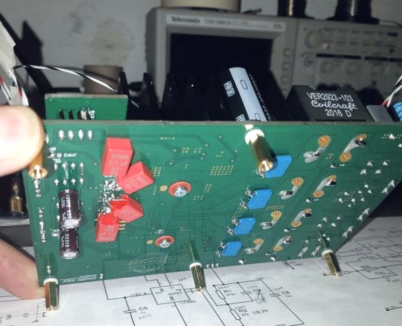

Also some caps might need to be replaced with lower height or be soldered under the PCB. (I saw Brad did it on his board since the caps might be taller than the daughtercard, attached pics from his implementation )

Erratum, the daughtercard can be raised higher, so that it won't block or hinder any motherboard parts. I'll show how it will be doneI forgot to mention though that we need right angle connectors for the inputs as the board will block them.

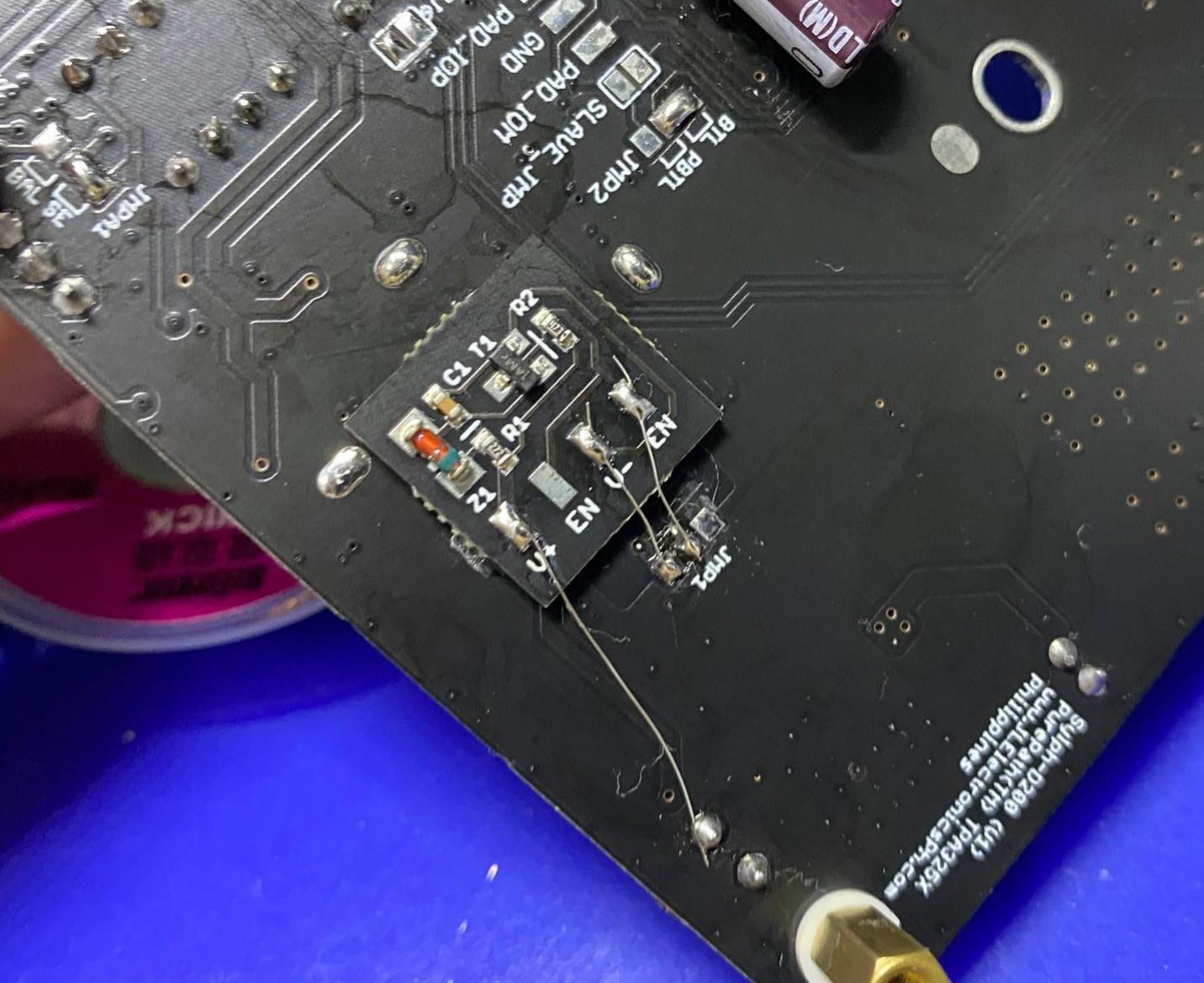

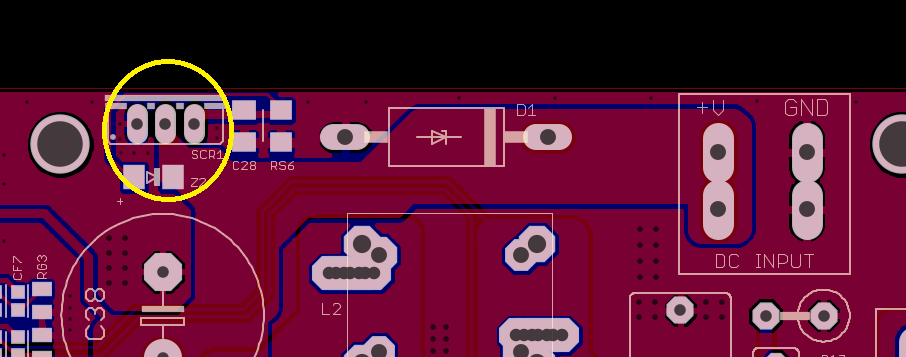

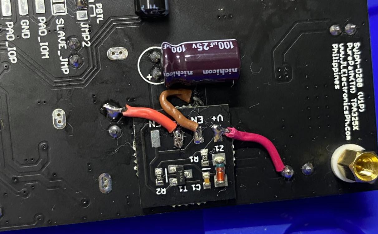

I tested the overvoltage protection (changed zener diode to lower value) and reverse voltage protection in TICore260BTL, for power supplies with robust protection like LRS-350-36 and SMPS300RS, it is working as expected, reverse protection and overvoltage protection works.
But when I tried it on my generic meanwell chinese clone, the copper trace in the PCB SCR area went poof and acted like a fuse (attached pic). No damage on either the SMPS or the TPA3255 module since the voltage that I tested it on is below TPA3255's max voltage. (looks like OCP on cheap smps is not implemented on its output and only relies on mains fuse, when the pcb trace went busted, overcurrent stopped and saved the smps)
So in the latest Sylph-D200 version V1P, I thickened out the said trace. I haven't tested it in my chinese meanwell clone though since the SMPS might get busted lol.

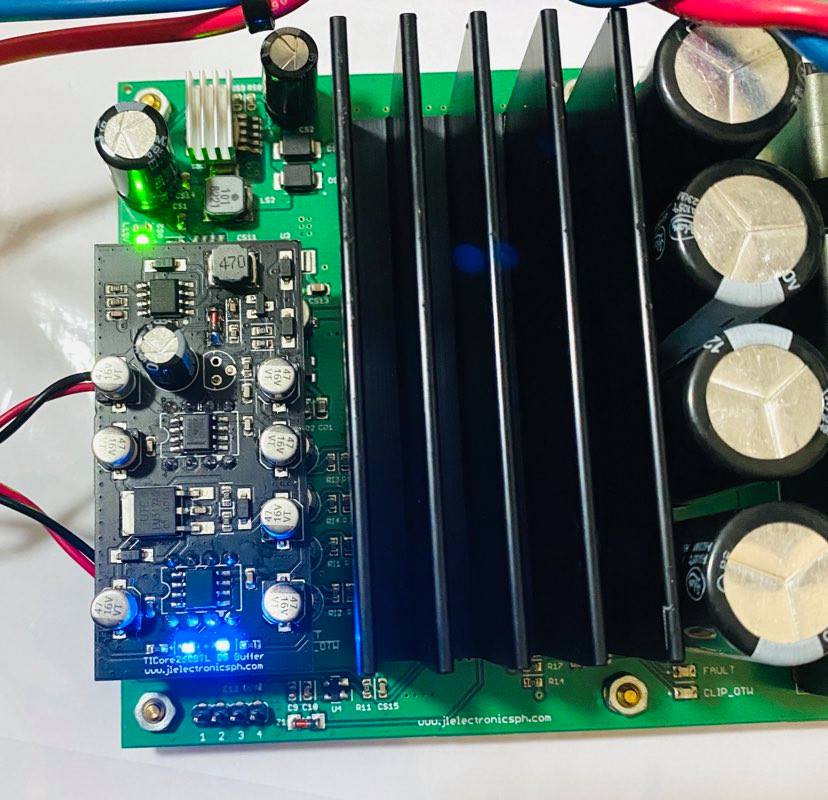

Moment of truth...
It is working!
. I don't have TO-92 LM337 here so I bypassed it for testing.
Final voltage for the opamps will be +/- 6.5V DC
Just short out the input coupling caps in the front to get the full potential.
No slow ramp problem, fix is already integrated.
