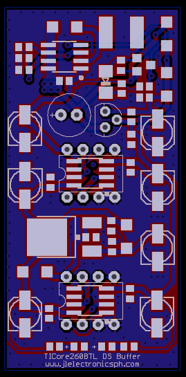

Dual Supply Buffer for TICore260BTL is now ready for manufacturing
Can you tell us more?
I have a TICore260BTL to get up and running and one of the points I need to address is to install the input opamps - I was about to order some OPA1656s but now wonder if this is the way to go?
D
Deleted member 148505

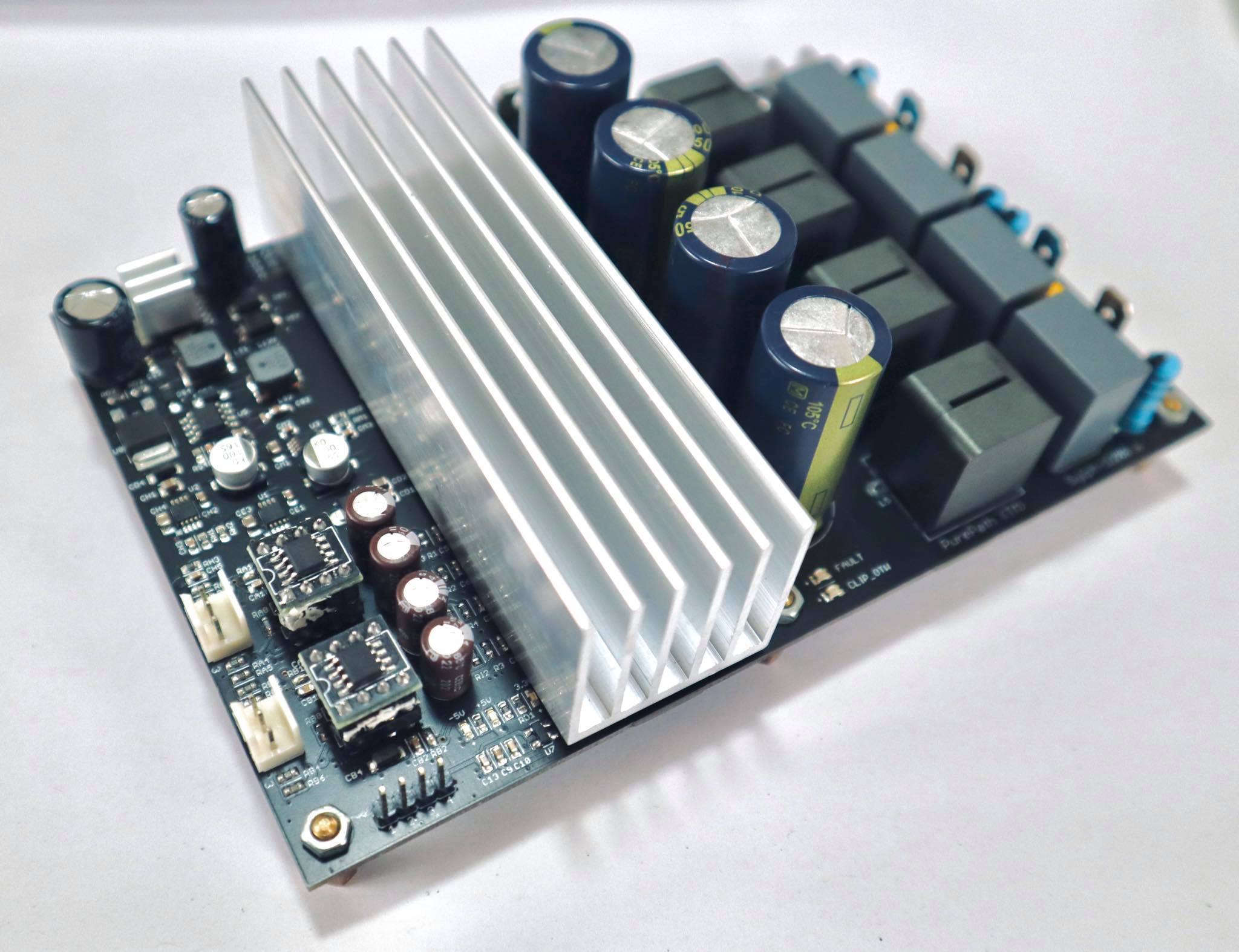

Yes, unfortunately someone has hoarded those heatsinks,Is there an alternative heatsink to the ATS-TI10P-519-C1-R3 that I can use with my TICore260BTL TPA3255 amplifier - it seems to be on back-order everywhere?
Thanks.
I will shift my PCB to ATS-TI10P-519-C1-R0 in the future if the stock is scarce. Size is the same but screw mount is different
If you can find 100mm x 30mm x 30mm, you can retrofit (drill and tap) and place copper shim underneath. (attached pic)
This buffer is made to remove the 4 extra input coupling caps in TICore260BTL. It will reduce the "haze" and "bloom" introduced by electro caps and will add clarity. Idea is from Brad Pitt

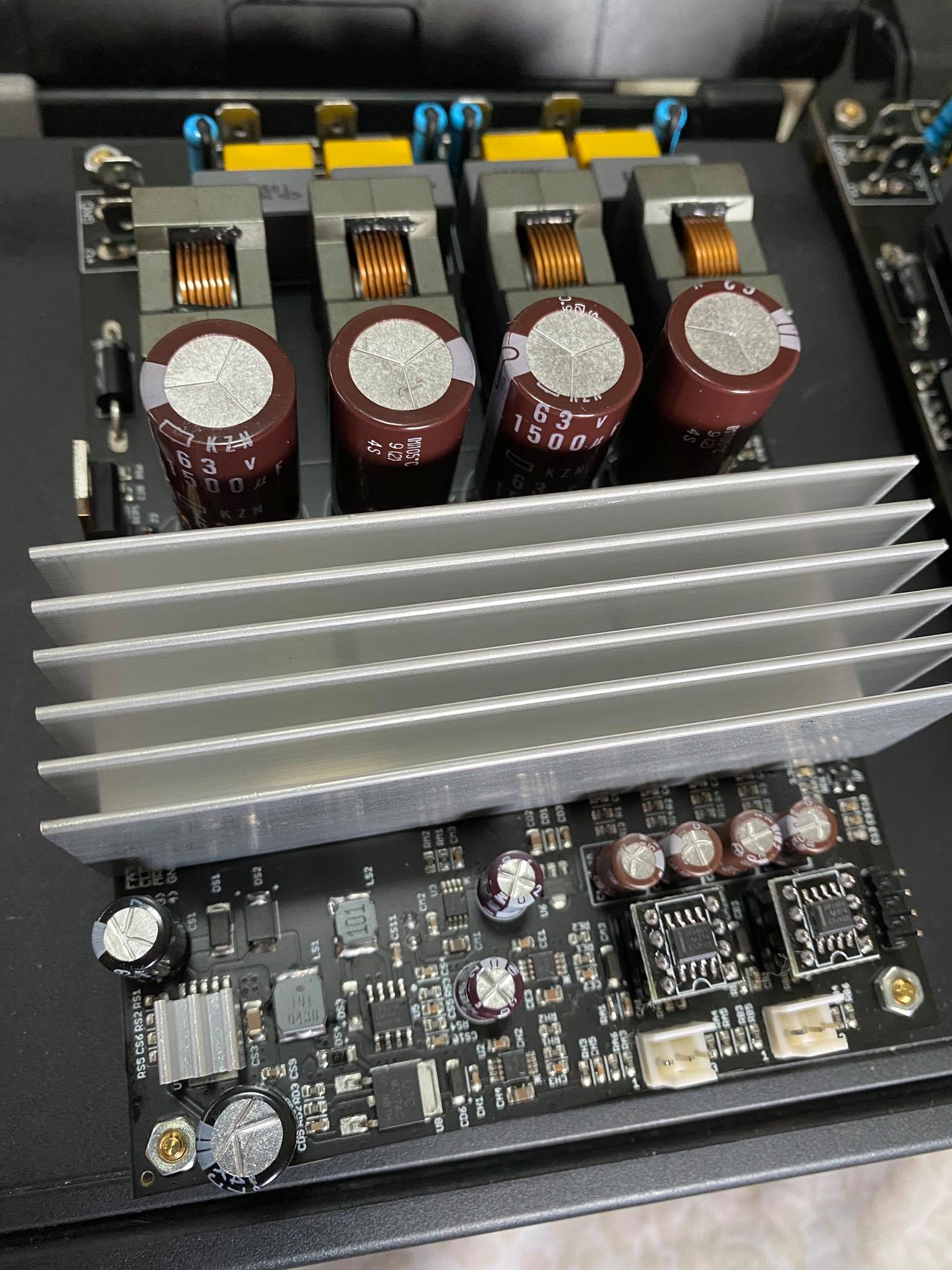

Thanks to Jimk04's kind offer of a heatsink and a Digikey delivery of the few parts I need, I now have everything I need to finish assembling my TICore260BTL module.
The first think I need to do is to apply the 'fix'. The instructions I have say to lift and rotate C17 and make a new connection to C16, as per the picture below. Instead of doing that I am thinking that I can cut the PCB tracks where I have put the red crosses, isolating C17 so there is no need to lift and rotate it - the connection to C16 would then be as per my yellow line. Can I just confirm that cutting the PCB tracks at the red crosses will actually isolate C17 or is there a via I can't see under the pad?
Edit: Actually, I've just remembered that the PCB is only two layer so I can see that there is no via under the C17 pad I need to isolate.
D
Yes, this is an easier solution, thanks for the idea! You can also use jumper wire used in cellphone repairs.
Edit: Temp controlled soldering iron is a must, too much heat will melt and dislodge C17
You also need to remove and short out R8 and R10 for better sound.

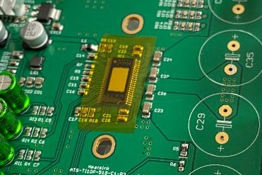

Another question if I may. the board i have acquired has a plastic foil over the amplifier chip, like this;
I assume this is covering a heat-transfer adhesive pad on the chip so I just need to peel off the foil and install the heatsink - no additional heat transfer paste required?
D
I only put it there for ESD protection while it's being packed and shipped.
You need to remove it and put a very small amount of non-conductive CPU thermal paste (I'm using Arctic MX2).
Lester
