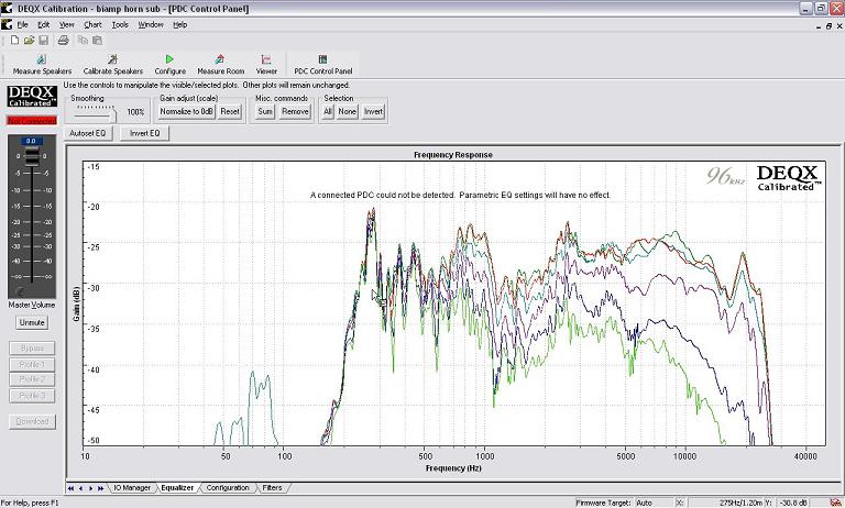

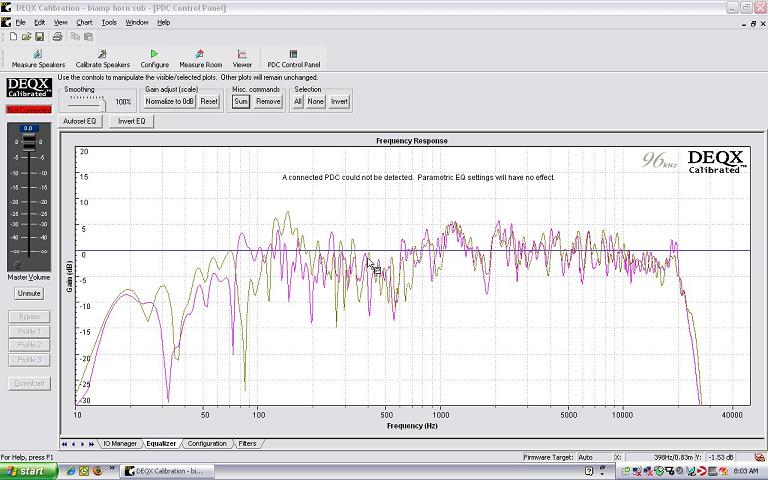

Don't know if this helps, but here are some raw polar measurements taken in 10 degree increments, average of three sweeps (so not high res), 0-50 degrees. Taken at about 1 meter.
At around 1.5 kHz, the measurements stack in order, so you can follow the individual curves from there.
This is a passive crossover, and not particularly well optimized for the combination.
Sheldon
Sheldon
