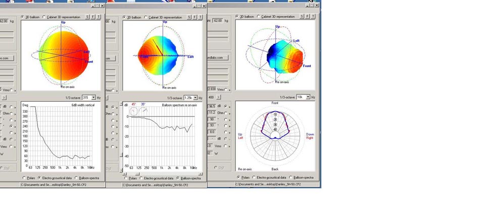

What one can get for now is the current design from the spherical data (the SH-50 CLF file) on line is shown in the screen capture below.
On top, you can see the radiation balloon at any angle by moving it around, you can see the balloon at any 1/3 oct center by selecting a new F.
Below, you can see the 6dB beamwidth graph or frequency response at any arbitrary angle (by moving the tabs that control the reference line in the balloon) or see H and V polar patterns at any 1/3 oct center F.
The other data is as shown by clicking the dots.

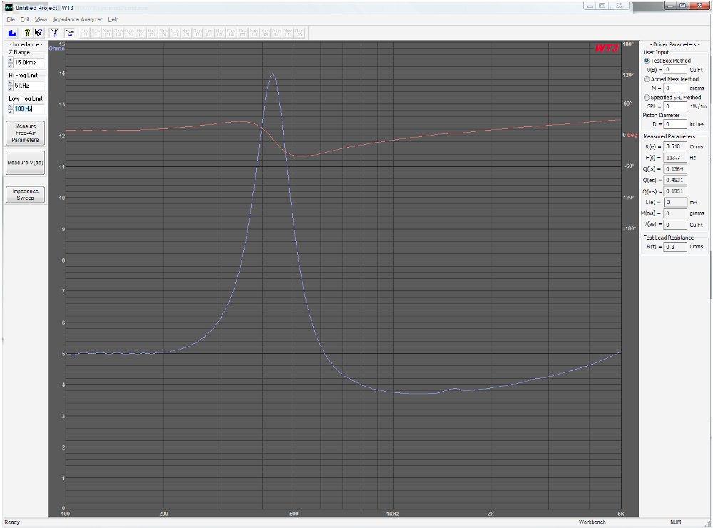

I just went downstairs and dug out the midranges that I threw together for the Unity horn that was going to end up in my car. (Not the 1st one, the 2nd attempt.)
I removed the midranges and measured them. They're pretty darn good. I think they'll work better than the Pyle mids mentioned in the post above.
Maybe someone will spend a few bucks and measure the Pyle mids (buy a Pioneer closed back midrange while you're at it!)
At the moment, I think I'll stick with the TBs. My measurements show that they have an FB of 430hz in the spherical enclosures I built. That's about 100-150hz on the low side, but nothing I can't fix.
Here's a pic of the enclosures (I took them off the horn before I measured them.)
Attached is an impedance plot.
![2640511984_4e6fa6a7da_o.jpg](https://farm4.static.flickr.com/3101/2640511984_4e6fa6a7da_o.jpg)
