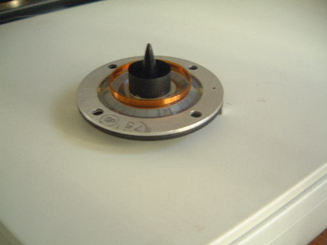

But the BMS is unconventional; it doesn't use a dome. Here's a pic of what it looks like if you take it apart:
http://www.audioheritage.org/vbulletin/attachment.php?attachmentid=11051&stc=1&d=1132259749
A few years back Vifa created a driver that became an instant classic, the XT25.
The BMS and the Vifa sound a lot alike; and both use a ring radiator to extend the respond out past 20khz. Here's the response of the Vifa:
