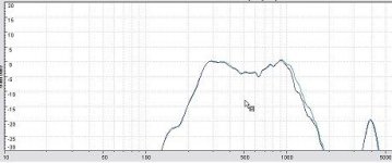

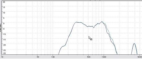

Here's the measurements, including the TAD throat, and with the troat sealed at the horn entry. Only a slight shift to lower frequency with the throat included.
Interesting - that's about the same as one of mine, but smoother in the passband.
Red is measured, blue is predicted.
Maybe it would benefit from reducing front chamber volume on the mids then. Just don't move the crossover up to where the midrange entry holes are too far apart acoustically. I would think you'd be able to see that point in polar plots.

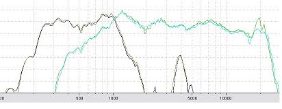

Thanks John. Time to play then. Any rule of thumb on the spacing/frequency relationship? I'd like maybe 500Hz more to play with. Here's a typical measurement of the mids and high together, to give a idea of what I have. Note that I've alreadly compensated for most of the HF roll off at line level.

John Sheerin said:f=c/d/4. d is the distance between the midrange holes. So for example, for 2.8" between the holes, I wouldn't try going above 1200Hz. That's probably about what you have now.
Yes, they are about 2.5" apart, so maybe worth a try extending the HF range.
